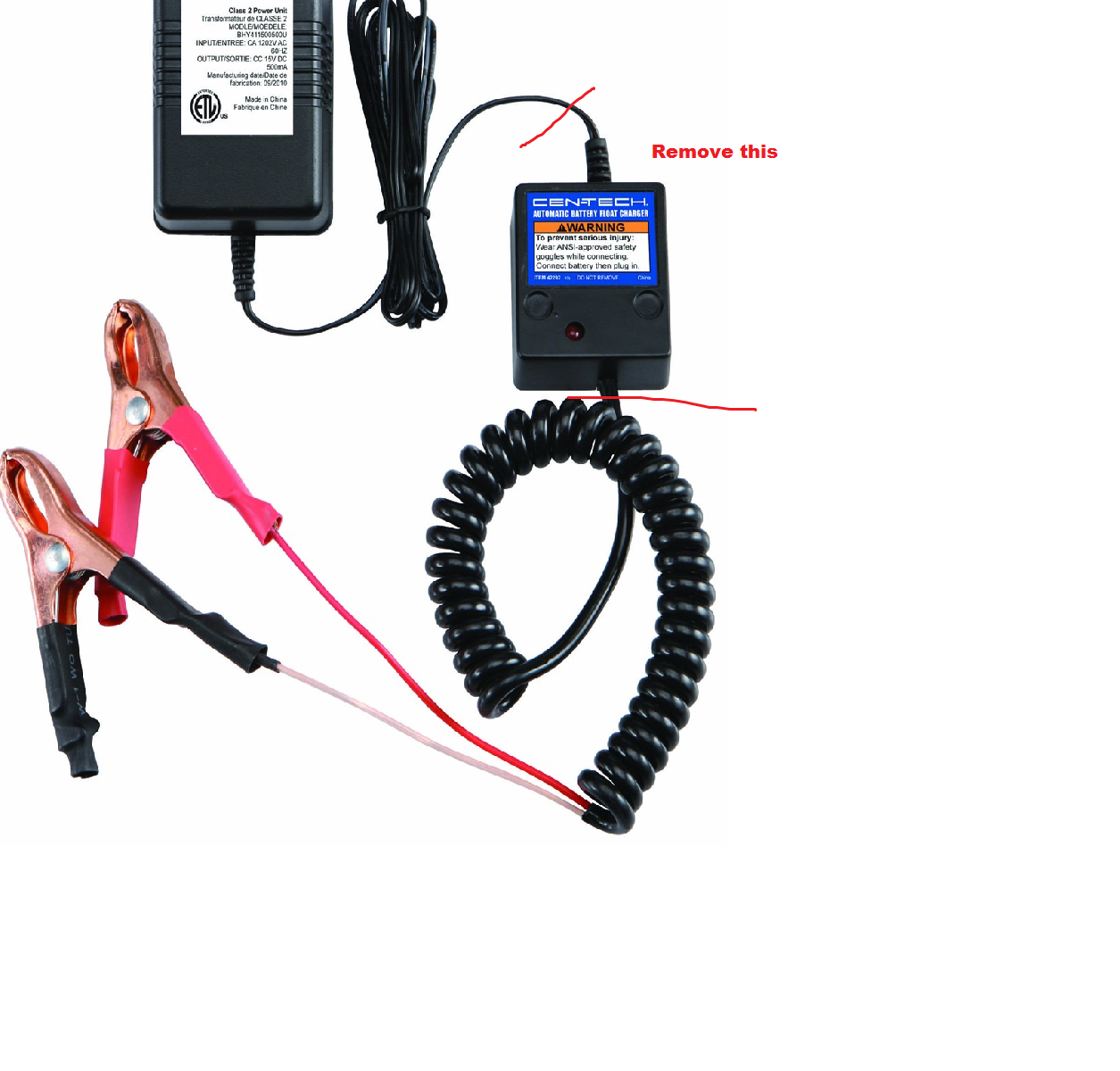

I couldn't get the doorbell transformer to work at all. I bought an "automatic battery float charger" at harbor freight that already had alligator clamps on it for like $8. I cut off the float box section and wired the clamps directly into the 16V transformer (plugin) and it works like a charm.
