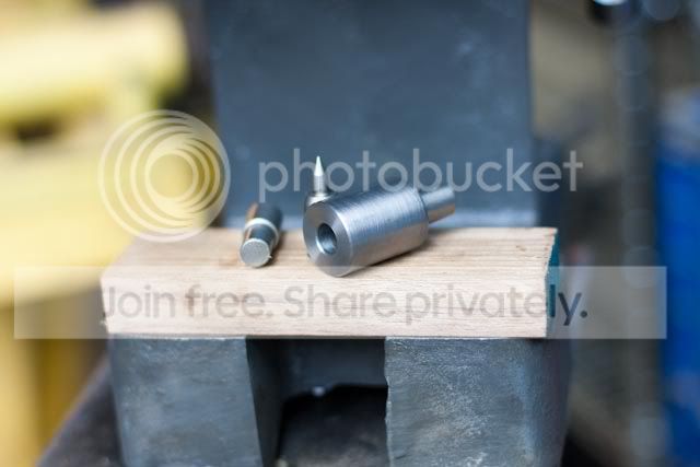

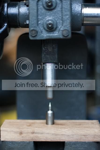

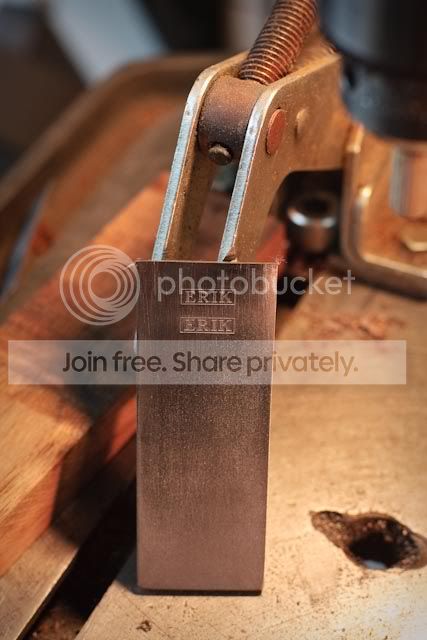

The arbor press will work for your stamp and flaring dies. The trick is getting everything the right size so your attachments fit your press. I bought a 1 ton arbor press, and had my stamp made to fit the bore on the ram (1/2"). My flaring dies were sized differently, so I needed a custom adapter. Everything works great, but I could have achieved the same thing with one less step by getting a press that fit my flaring dies, and ordering my stamp to fit the press (I was customizing the stamp either way - make sense?)
Maybe pictures will help.
