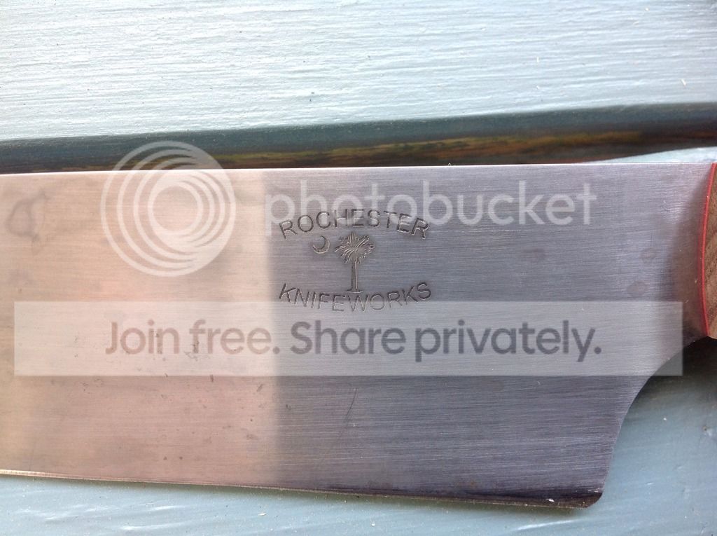

So I finally got a stencil and an Atlas mini etcher. I bought a hand pad from Lectroetch instead of using the q tips. This is on one of my first knives that I have been using in the kitchen. The goal was to keep it simple but unique. I still need to work on getting it crisp but I think it's working pretty good so far.
Perhaps a bit too long on the hand pad for the amount of voltage you are using or even the other way around. Still pretty darn good.
Frank
One of the biggest improvements I've had with applying my maker's mark came about from a tip from Brian Fellhoelter. Instead of holding the pad on the stencil, try swiping just the edge of the pad across the stencil about 15 to 20 times and just use AC. Try this on a blank piece of metal, I think you will be pleasantly surprised.
I like it. It's simple but distinctive. I've had luck with using Flitz to remove the slight haze I sometimes get from too much AC
Nice looking mark. Very clean and classy looking. I will have to try the flitz as well because I have been getting that same halo and haze around mine.
You might try giving a quick swipe on a buffer afterwards too. Normally makes my marks pop just a little better.
Looks fabulous! I don't mind a bit of darkness around the lettering. It actually looks better to me.
Unless I can't really tell on my phone, that looks like a good stamp more than a typical etch, which I prefer.
It definitely is deep. So far I'm happy with the etching machine. I did go with a pad over the q-tips which I'm sure helps. It amazes me how you can get the details in the palm tree. All this technology is something else!!!
Would Flitz work with a hand rubbed satin finish? I wonder if it would make the finish uneven?
I've not had a problem with Flitz causing any uneveness thus far. I've used it on blades with a scotch brite finish and hand sanded finish.
