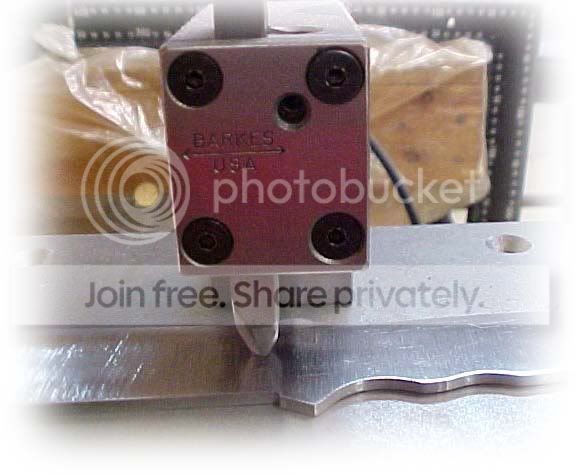

I have saw this come up a lot over the years. I been using Ever's Stamps for years and still going strong. You will be completely satisfied with their quality. But you will need to create your own stamp holder for the stamp. The one you get from them is for folders and not straight knives. To give you a better understanding I have the setup on my site in my Shop Tour. If you need anymore help just ask and I will see if I can help you.
This is how it would come out on the knife. And it will last a life time. And you will not rub it off.
This is the press that holds the holder for the stamp to set in. This will support the stamp to give you a even impression all the way around.
Here is the holder that supports the stamp in a close up view. The press is a 12 ton hand jack press.
Its very important to practice your impressions on a scrap piece of steel, before attempting your masterpiece. In doing so you will learn how much pressure to apply. You can determined that by how many times you pump the cylinder. " Tip" For a piece of 1/8 inch or to say 125 thousands it woud be in the neighborhood of 4 1/2 pumps on the bar. But you will need to make some test runs to get it down to science. Hope this was of help David. God bless and have a nice day. Also, here is Ever's site http://www.henryaevers.com/

I have a stamp from Evers, and although it's a great stamp, I wish I had gone to an etcher years ago. I just started etching instead of stamping, and unless requested by a customer I WON'T BE GOIN BACK to stamping:grumpy:! They are really a PITA to get lined up exactly right, I used a hyd press to stamp my name and yes it still sucked! The imprint wouldn't be straight or would be uneven in depth, or the blade would bend when stamped, or the stamp would create orange peal on the opposite side...yada yada yada
Look at Barkes stamp in his picture! It's not straight! I'm not picking on him, he makes really nice knives, just an example of the problems I'm speaking of. Buy or make an etcher and call Ernie Gossip and he will make you a lifetime of stencils for next to nothing in the design of your choice.
I line my makers mark with my handles. It is the way I wanted it to be. And I was happy to see it illustrated in the knifemakers Show Case last months in Blade magazine. And the new owner was well pleased also, I just hope one day I maybe as good as you are in producing a perfect flawless knife. :D
