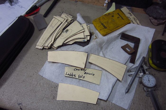

I always draw out my knife and save the handle profile for use later.
Every knife gets a drawing:
And the handle profiles get saved in categories of Bowies, Fighters, Hunters, etc.
Draw a blade profile and find a handle profile that compliments it.
Draw in different guards, etc., until there is an image in your mind that you can move toward.
