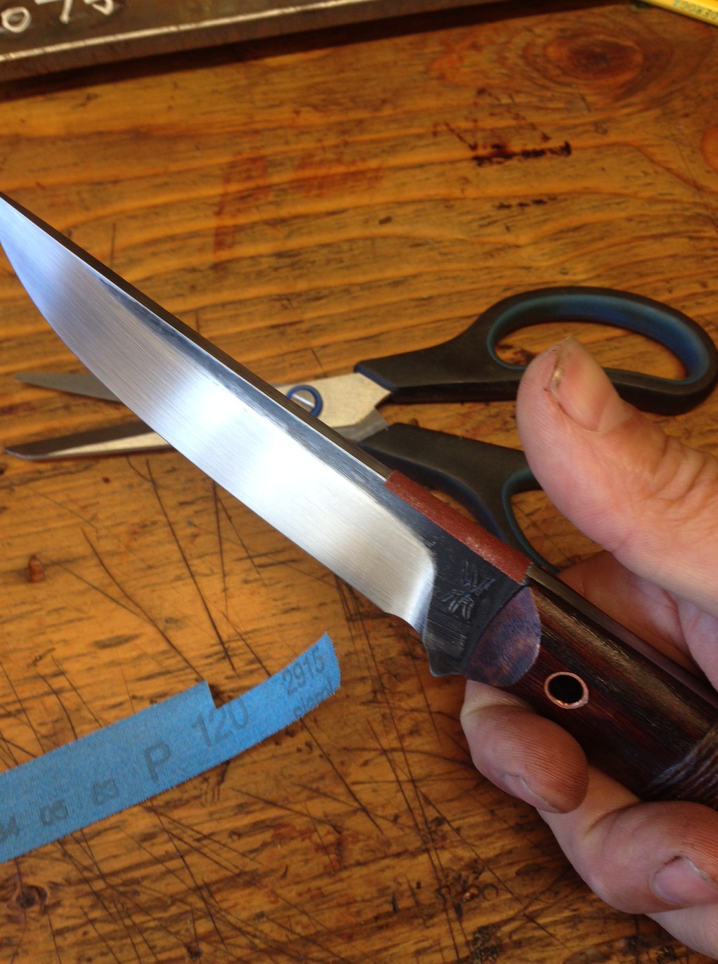

Ok, so I'll defend the beleaguered jimp a bit here.
1. If your jumping is tearing your flesh, you're doing it wrong. I took several runs at jimping with plenty goes of wrong before figuring out what gave a grip but was comfortable. I found the best was a small half round needle file, making the jimping wider than it is deep, and of course rounding/smoothing the edges. I find things like knurling tear at flesh much more than smoothed jimping. I kind of hate knurling and checkering personally to be honest.
2. If you don't understand how jimping would help your grip, you've never used a knife to cut some fishing line with wet hands ;). The posts talking about stabby stabby I don't get. I've never viewed jimping as having anything to do with stabbing. It's useful when pushing down with your thumb and when pulling. I don't know anyone that puts their thumb on top of the blade for stabbing. Then again I don't know anyone that actually uses a knife for stabbing o_O. I guess I have a more "utilitarian" circle of folks.
3. Connected to 2, I don't quite get the "tacticool" association. We aren't talking about fake saw teeth etc. here, and it's not a feature I see as "combat" oriented. It's really a utility thing.
The first friend I made a knife for, I went with him to look at other knives and observed what he seemed to care about, liked, didn't like, etc. Every knife he inspected the jimping and tried it for feel and grip. It was probably the most important thing to him. Before making his knife I tried a lot of different knives in the hand then tried and failed a few times at getting it right. In the end I was pretty happy with what came out. I gave him an extended section of jimping so it worked in multiple grip points. Is it right for every knife? Absolutely not, but on something like a little utility neck knife I think it has a place. This is that knife:
