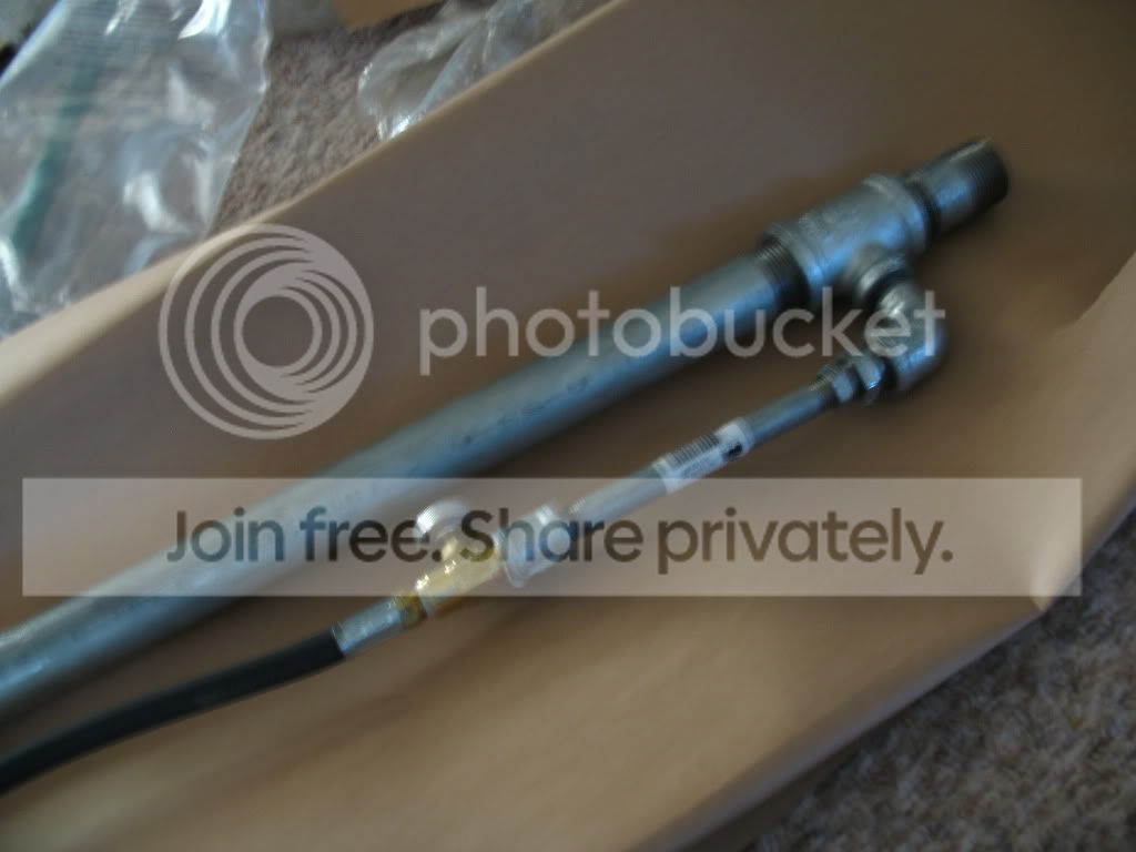

well i scrounged a shopvac that can be used as a blower, it will be here this evening. in the mean time i am trying to set up some pipes to merge the air flow with the propane. see image below. if any of that looks scary let me know. i would hate for you guys to read about me in the paper. :)

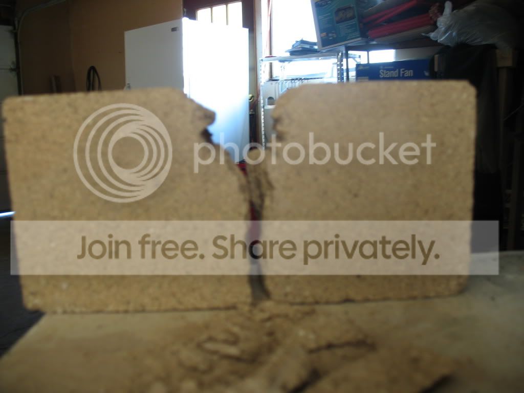

the last photo is my failed attempt at drilling my brick to fit the pipes. :D i think i can get that ready before my shopvac gets here.

Don fogg has an excellent example of a propane forge on his web site. I'm no expert but I think your air supply line may be too small. I have a two inch pipe with a squirrel cage blower attached. Between the blower and the elbow where the gas line enters I have a gate valve to regulate air flow. Make sure the air is first thing going before you try to start the forge and the last thing you turn off when you are done.
