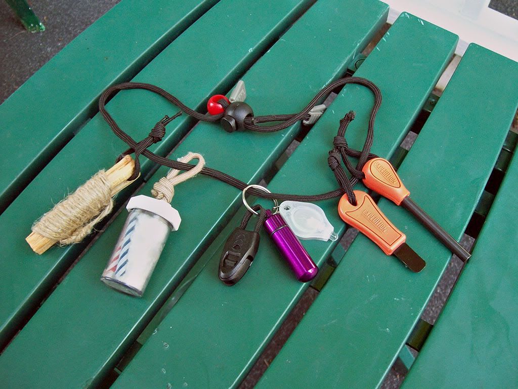

I keep a Berocca tube filled up with cotton wool with vaseline. It's brightly coloured and water proof. I've also wrapped gaffer tape around the tube.
Pair with that my firesteel and you've got fire taken care of. I'd also throw in a mirror for signalling and maybe a whistle too. I have a space blanket in case I need shelter and extra warmth. You'll need something for water, either tablets for safe drinking or a simple billy or both.
Cordage, paracord is great because you can use the inner strands for fishing etc.
