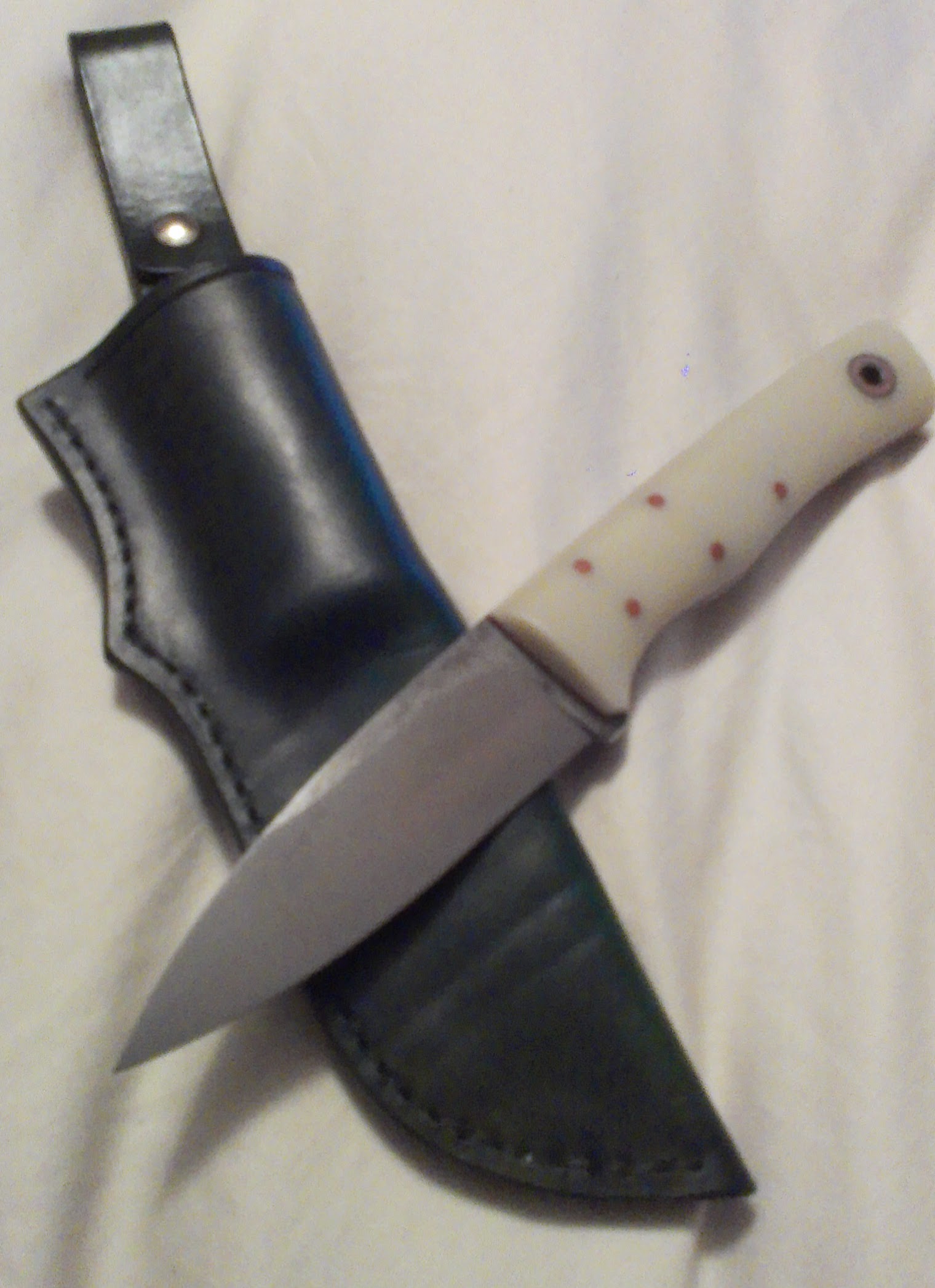

This is one I made out of a Simmonds file. It was my first attempt at a scandi grind and I was very impressed with the ease it cut oak and maple boards. This sold right away so I'm sure I'll be making another one very soon.
