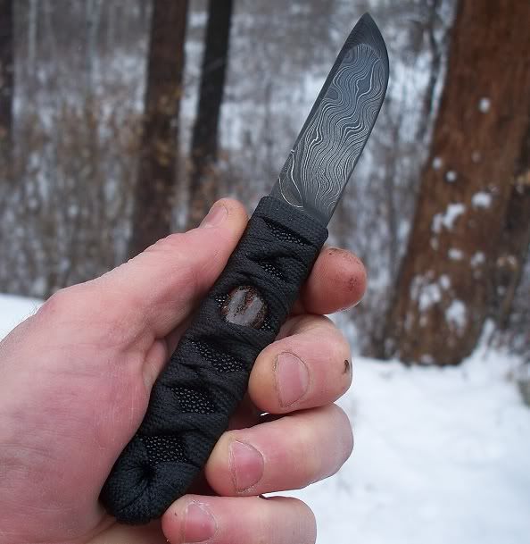

I finished this one up last night!
416 Layer Damascus made from 52100/5160/15n20/203E steel. Very tough stuff!
About 3/16" thick
8.25" long with a 4" blade and 4.25" handle
West System epoxy soaked cord over premium black rayskin with hand cut dinosaur bone
The dinosaur bone is gem grade petrified bone from my local area, it is hard to tell from my video but it is a nice dark red and took a great polish! The dinosaur bone is harder than steel, it must be cut with a wet diamond setup. I used about 8 stages of diamond to rough shape and polish the stone ranging from 80 to 50,000 grit.

Patterned welded?
It sure is! It is 416 layer Raindrop Damascus!
This was my first damascus knife and I did a lot of research and decided a mirror polish would look the best etched, it is hard to see in the pics but it is a cool contrast of satiny black and shiny "silver."
I have to say, I really wasn't much of a fan of Damascus before this piece but after seeing it in person I am super impressed and addicted to the Damasus! Damascus can often be too busy for my taste but in person it just looks insane, it is hard to photograph the cool effect it has.
I consider keeping this one, it is my first Damascus steel knife.

I am wondering why you choose to do such a wide plunge on many of your knives? Seems to me it would rob blade space.
Kaleb
The sweeping plunge line adds a lot of strength, especially with the chisel grind. (because there is no steel missing behind the sweeping plunge) The smooth transition isn't prone to stress risers like a blocky one is.
I also think they look better.
