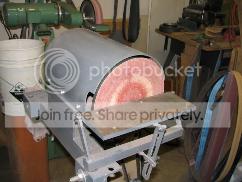

Hello Jim,
Here are some pictures of the disk sander that I put together a few years ago. Just used plain pillow blocks and the disk came from Rob at Beaumont.
Hope this helps.
Take Care
Charles

Hey Charles thats pretty sweet set up, thos e look to be the aluminum disk that Rob has correct.

Hey Spencer, yes they are the aluminum disk from Rob.
I'm not sure what you are asking the price of when you are talking about a brake, if it is the thing with the red handle that is a reversing switch.
Charles
Sorry my bad yes the reversing switch, also did you turn your own shaft on the second grinder?
Thanks
Spencer

The shaft was purchased as you see it but I had to cut the keyways.
