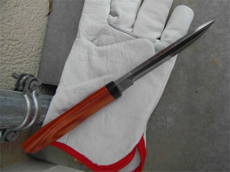

Hello to all! I show you how I make my file knives, with little tools... Let's start with some old files, re-tempered in my kitchen oven, about 450 degrees, two cycles of 1 hour each:

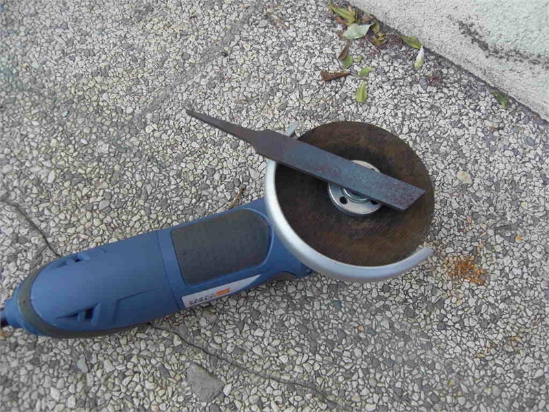

I cut the file to lenght:

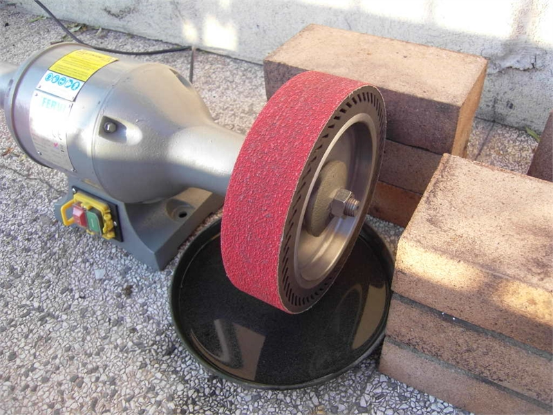

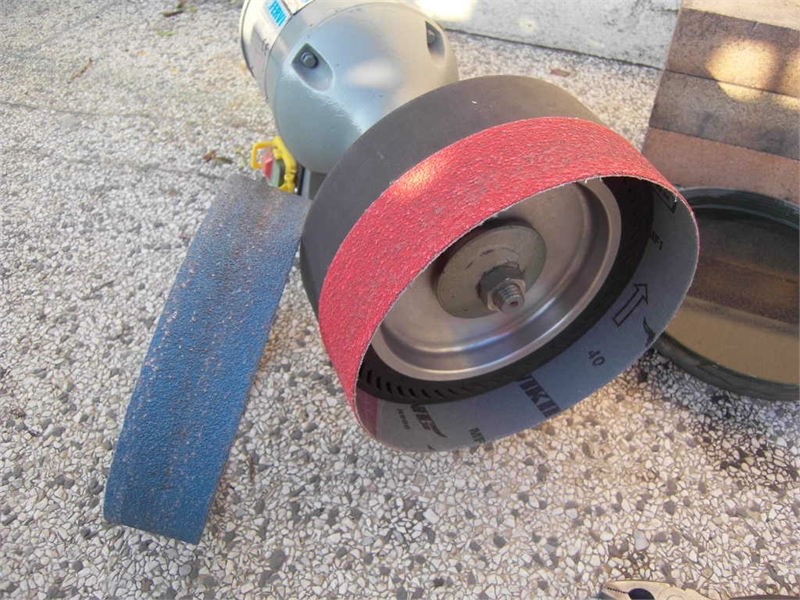

With my grinder and an expander wheel with a 40 grit zirconia belt, I shape freehand the profile of the blade (I have to frequently dip the blade in water):
The result:

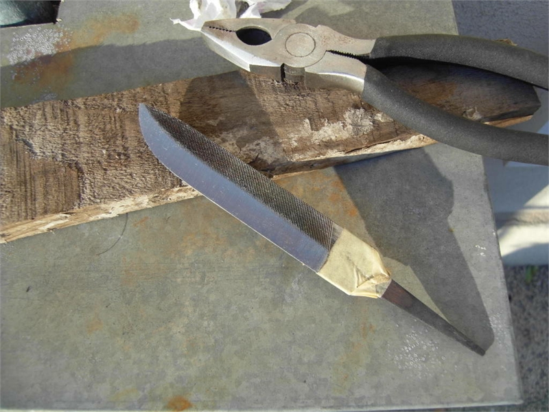

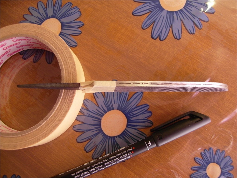

With a marker, I draw the edge. The tape will serve as a reference for grinding:
For grinding the hardened steel, I use a 40 grit ceramic belt:

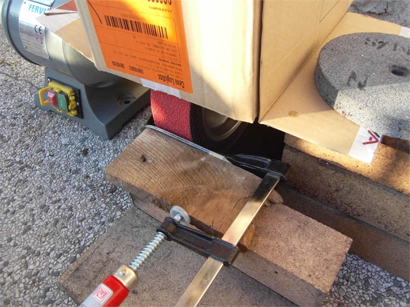

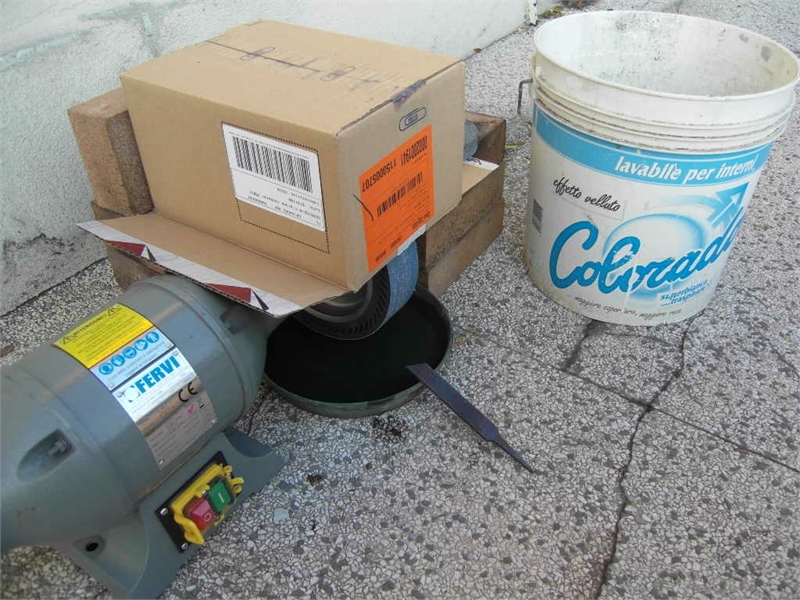

Water underside for prevent to inhale too much dust:

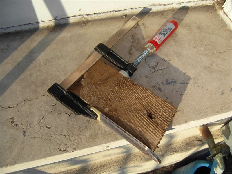

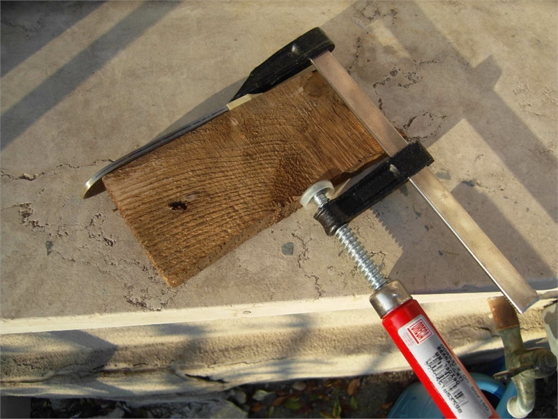

I fix the blade to a piece of wood, both for have a reference and for avoid to come near the belt with my fingers:
Let's start grinding, it is important to make short strokes and dip the blade in water to keep it cool without compromising the temper:
First side done:
Then the other side:

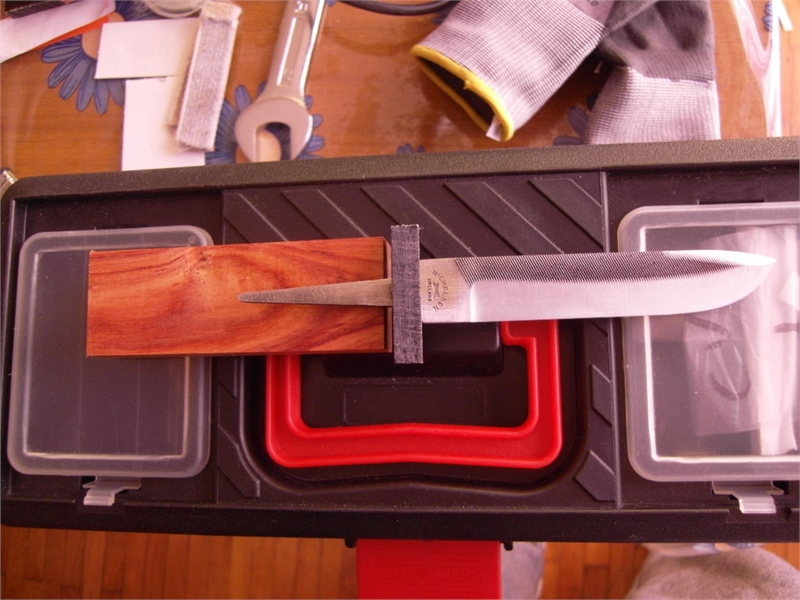

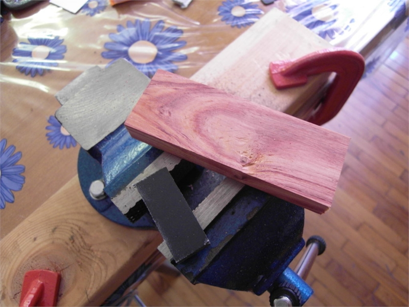

Now the handle... a piece of black micarta and a piece of bois de rose:

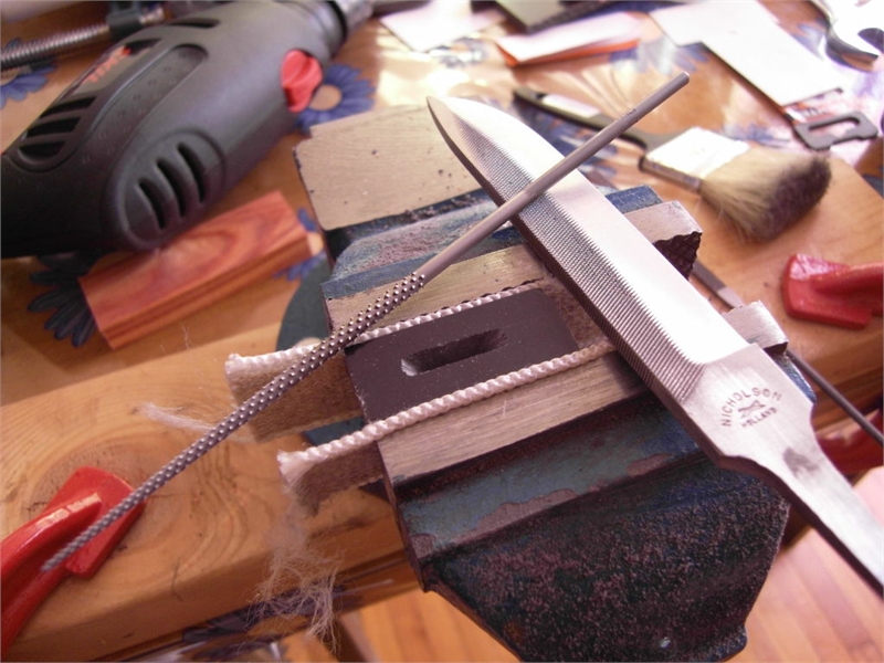

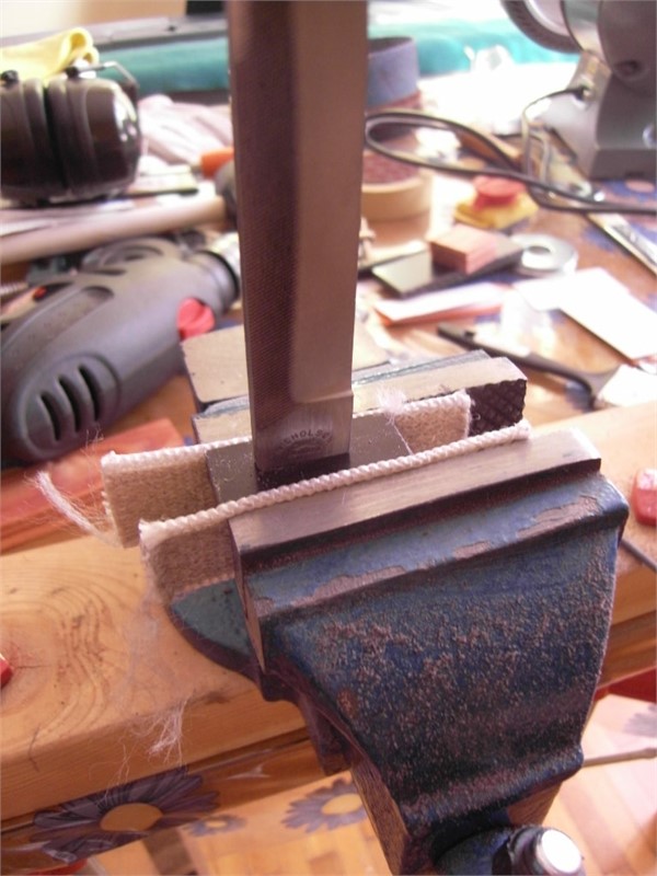

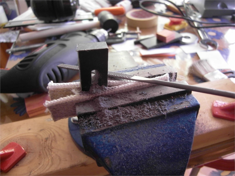

I drill freehand the guard and adjust the slot for the tang with a small rasp:
I shape the slot until it fits perfectly:
It fits:
Then I drill the handle, just a bit wider than the size of the tang:

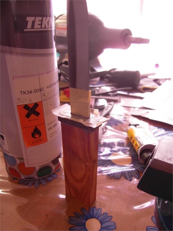

I fix with epoxy both the guard and the handle, and I wait for complete catalysis:
When the glue is dry, I shape with a hand saw the handle:

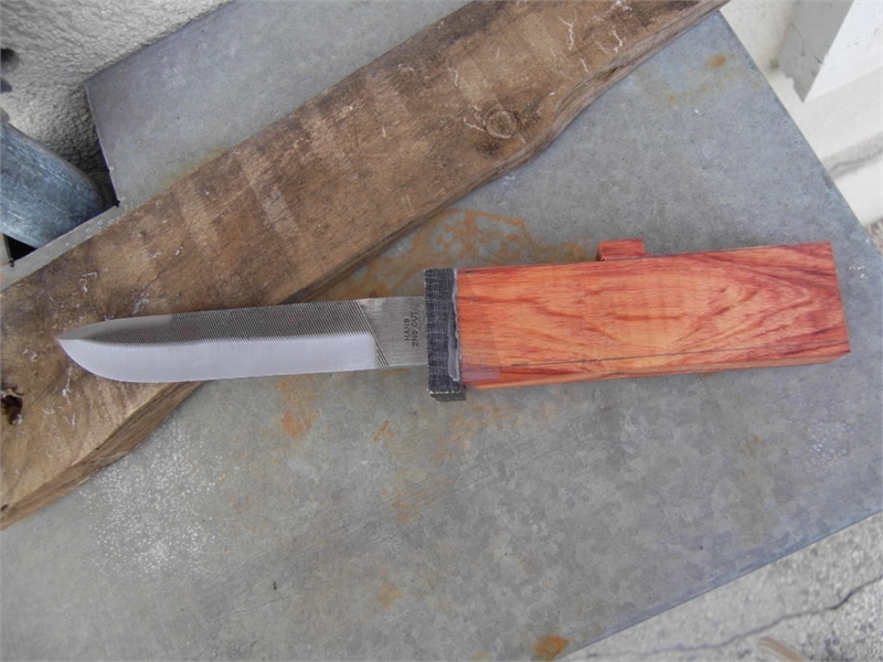

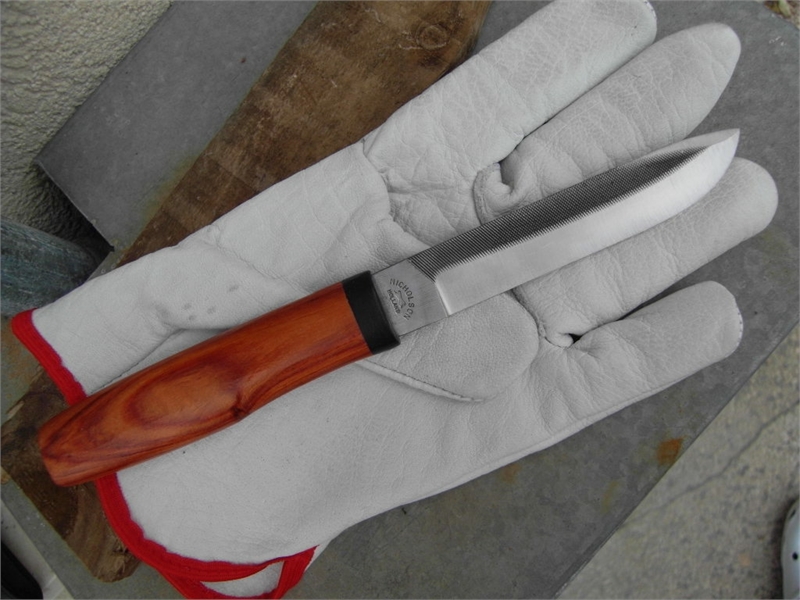

Then again on the wheel, I shape freehand the handle until it looks good, ending with some scoth brite wheels. This is the result:
I know, it's not the perfect or the best way to make a knife, it's just a method to show everyone that it's possible to make a simple but effective knife with basic tools. I hope to inspire someone else to start this beautiful art! Thanks everybody! :);)

Just a quick tip: Make sure to grind back far enough from the tip area that you cut off using the angle grinder in order to get back to the properly tempered steel, as that section will have definitely been overheated for a few millimeters. (Though you may already be aware of that)
I remember about 4 or so years ago, I was searching allll over for those expanding (contact) wheels after seeing Ariel Salaverria using one in one of his picture tutorials on his site. I didn't have a grinder at the time, but I did have a bench grinder so I became a bit obsessed with figuring out what the heck they were called and where to buy them lol. I ended up finding them a couple years later, after I already had a grinder that is. ;) Sorry to get off topic, it just brought back that funny memory. I think it would be a great tool to have, especially if all you have is a bench grinder.

...so where do you get the expanding wheel?
I mentioned in my post above that I spent a while looking but never ended up finding them until I didn't "need/want them anymore, as I had already built myself a grinder by the time I did find them.
Brownells sells them, here's the link:
http://www.brownells.com/gunsmith-t...ng-sanding-drums/sanding-drums-prod24604.aspx
Make sure to read the specs on each wheel (8" dia and 6" dia), as the 8" wheels needs a slower rpm than the 6" wheel. It's a little hard to tell from the pictures in the WIP, but I'm pretty sure Matthew has a the 6" wheel.

For the wheel, it's a pretty common tool among shoes makers, carpenters etc. Mine is a 8" diameter, 2" wide. Its main drawback is the short belt lenght coupled with the high speed it runs, which means it tends to heat up quickly the blade, so even more caution is in order, both for safety reason and to not ruin the temper of the knife.
You could also make a simple droplet system to wet your belt as you grind...the belts you are using will take water no problems, it doesn't need to be a lot of water to keep things cool and you will have more relax and be focused.

Most farrier supply companies have the expander wheels. I have a 10" in my shoeing truck. They are crazy fast!
