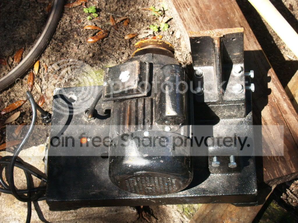

I am starting out with a belt / disk sander just about identical to this harbor freight sander. Only mine was broken at the pivot point. I got it for $20 from a flea market type place. I figured I could do something with it.
http://www.harborfreight.com/media/c...image_2138.jpg
Base and motor. Broken pivot on right side.

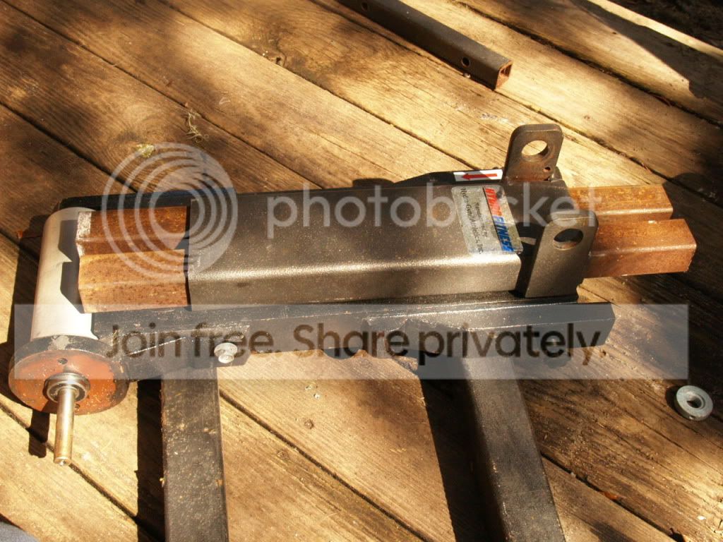

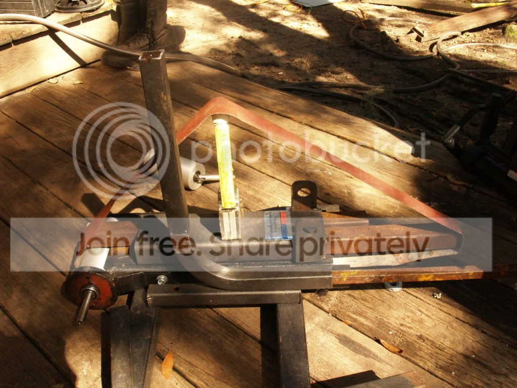

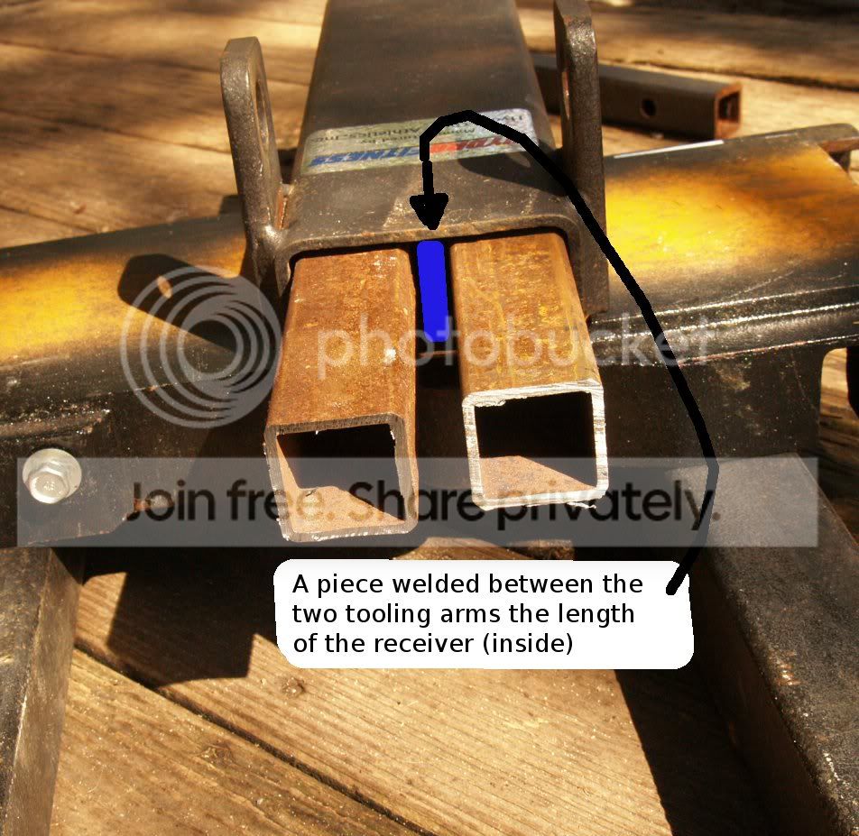

I have this piece of rectangular steel. Two of these 1.5" x 1.5" tubing fit inside of it pretty well. The 1.5" tubing would be the tooling arms. I will try to weld a piece of steel in to the middle to keep them separated and take up some slack. The piece I want to use as a receiver, the piece for the upright on the tracking arm and the two 2x2 pieces are pretty heavy stuff, 1/8" thick. They all came off of a big piece of home work out machine.

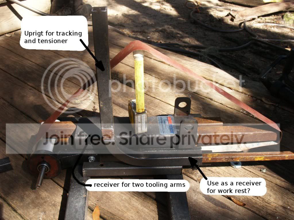

I would take this receiver and tool arms and weld or bolt them to the top of the belt sander bed, which is cast iron. Can cast iron be welded?
Along side of this, I would put up some kind of an upright for the tension and tracking arm.

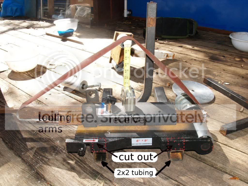

I'm not exactly sure how I will set this up so that it is up off of the work bench enough to slip a belt onto it. One thing I'm thinking about doing is cutting some notches in the sides of the cast iron base large enough to slip these 2x2 tubes from one side to the other so that it rests on these. Then bolt down the other ends to a base. With both rollers on it, the belt that goes on it leaves a gap between the bottom and the belt of about 1/2" to 3/4", so I think this will leave enough room.

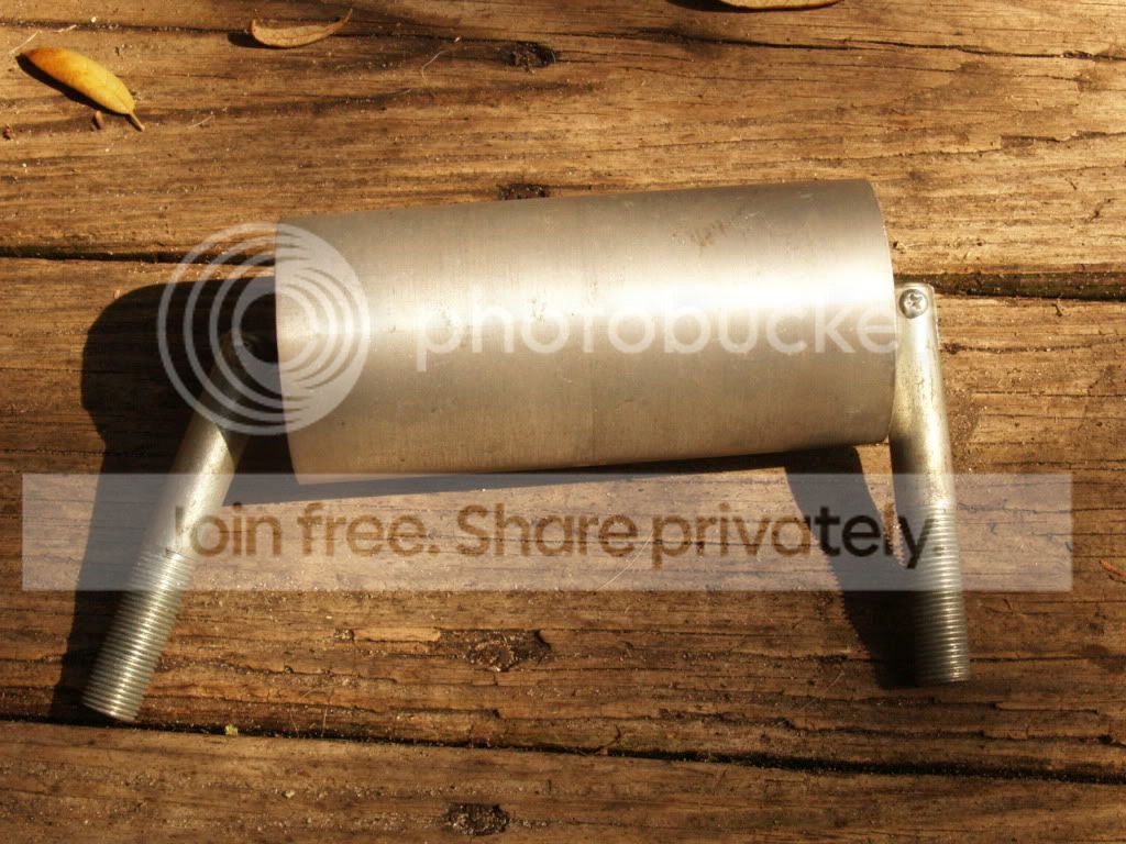

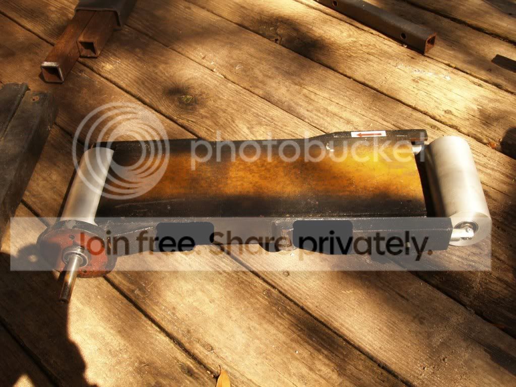

This is the front roller. The sides are solid with bearings in them, but the inside is hollow, so I don't think it could be cut down to 2". I am thinking about making some kind of bracket to hold it, attaching it to a tooling arm and using it as is. Or possibly using it as the bottom wheel on a flat platin (SP?)

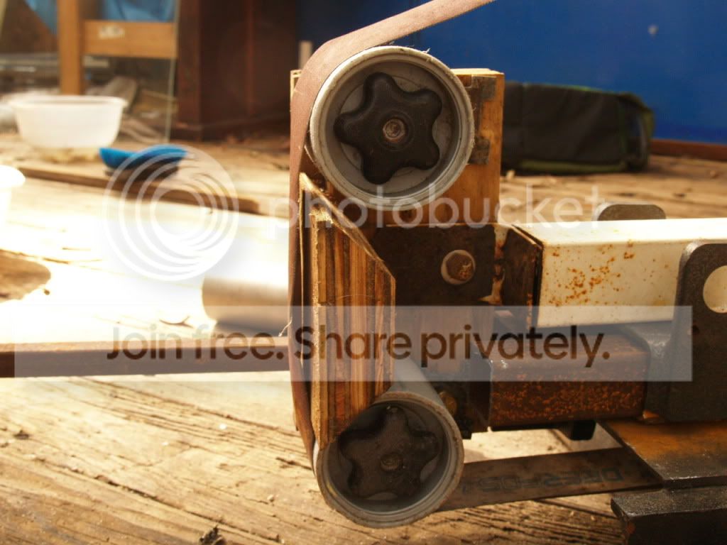

I mocked up this "platin" using the center hub from large lawn mower wheels. They are plastic with bearings in them. No idea how they would hold up or how long they would last. I might give it a try.
I am planning on using a 4 step pulley on the base and a 3 or 4 step pulley on the motor. The one on the base, I'm planning on putting the smaller end in toward the base so the opening of it is out so that I can slip on the 9" disk. Then drill a hole in the largest pulley so that I can get to the set screw on the disk.
Funds right now prevent me from going out and buying some good wheels So I will have to make due with what ever I can find and make work. I just remembered that I have a tire from a riding lawn mower that is hard rubber. I turned it down so that it is nice and flat and about 2 1/2" wide by bout 10". I might give that a try. Today I found a nice piece of angle iron to use for a platin.
Any recommendations on where to place the tooling arm receiver? Towards one side or the other? in the middle?

Greg, The upright will probably be bolted on or welded to a piece that would be welded or bolted on. It till have an arm on it that will have the tracking wheel. The wheel will be attached to a hinge. The hinge will be attached to the arm by one bolt to act as a pivot. There will be a bolt to move the hinge in and out. The whole thing will move left and right by a couple of small bolts. The motor that came with this thing does not have any info on it. It is probably under powered. I do have a couple of motors in a cabinet, one of them is a Dayton, but I'm not sure about rpm or hp right now. There will be a step pulley attached to the end where the shaft comes out.

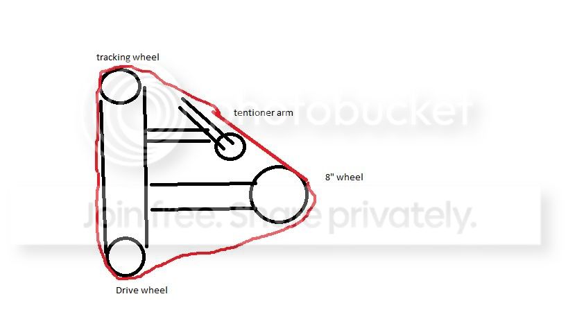

Have you considered mounting the existing platen/rollers vertically and extending the arms perpendicular to that? That way you could keep the two existing rollers, keeping the tracking from them.
do you mean something like this? With the belt running counter clockwise? Or with the arms out the front, like your, just tilted up on end? That gives me something else to look at. Thanks man!

Yes, just like that, mounted vertically and welded in place from one side would be very solid. On most 4x36 belt sanders, the tracking wheels also doubles as a tensioner arm. The tracking on mine comes from the electric tape on the 8" wheel, but it could also be electric tape around the drive wheel. It currently rotates with the belt moving top to bottom, like most commercial grinders do. You could replace the 8" with a standard two wheel flat platen and have the same results. My welding skills have improved considerably since building this one, I used twelve 6-32 set screws around the post to position the 1" tubing inside the 1¼" tubing. This way I can move it in/out to accommodate different size wheels if I wanted. I also replaced the roller bearings with regular bearings in the 8", the roller bearings were crap and overheated quickly. You'll notice the magnets at the top of the 8" that I use to balance it.

I see where you are headed on this with your drawing and that just might work. You have to work out a few problems I see that could pop up with that design but you may be well on the way to a great franken-grinder for a little amount of money! Listen to what zaph1 said about the bearings. The first bearings I put in my 10" wheel went to do-do shortly after I started using them, but since then I have got some better replacement. One thing about something like this you want to try and not build yourself into a corner. You have to leave provisions for replacing things that will wear out!
