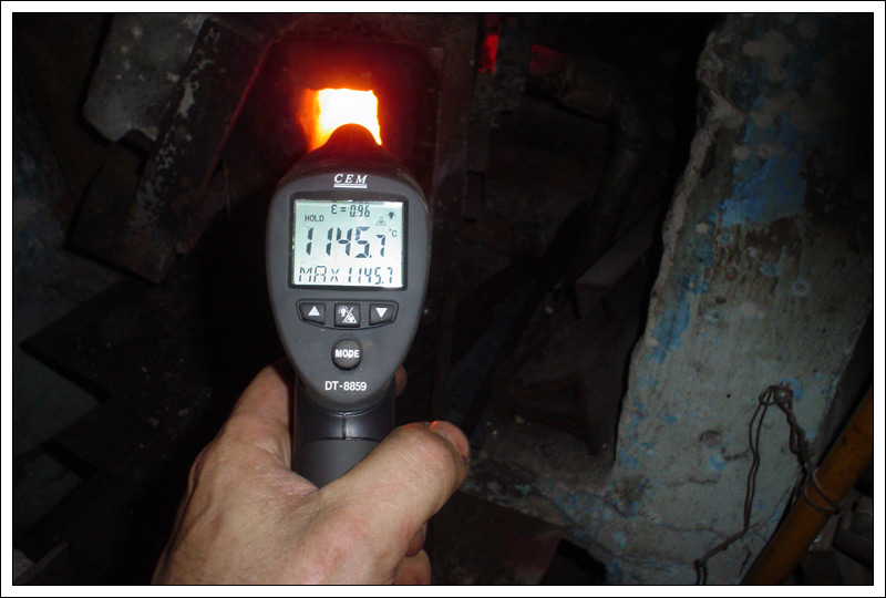

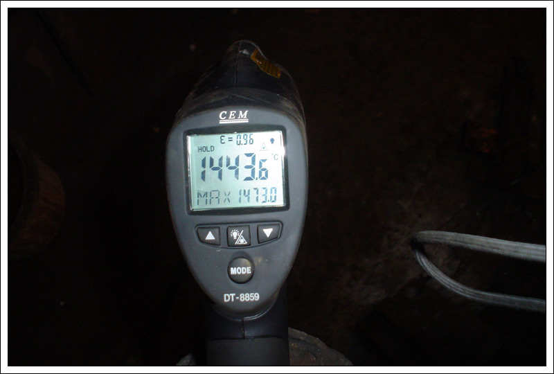

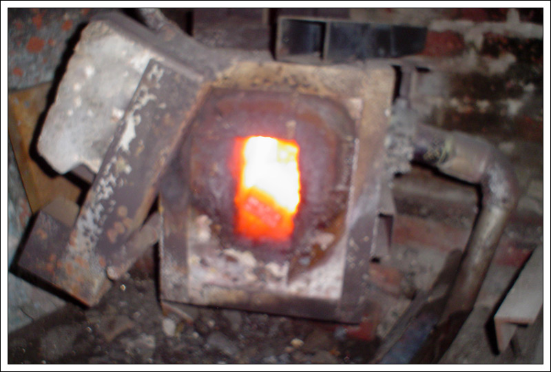

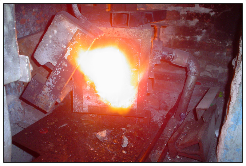

Oven at welding temperature, ready to receive the canned steels.
Welding temperature.

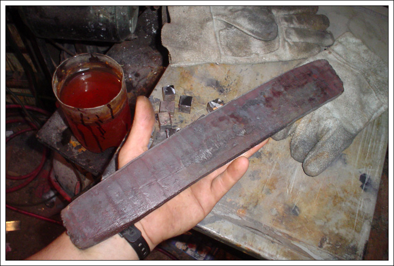

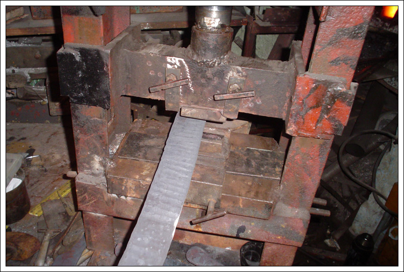

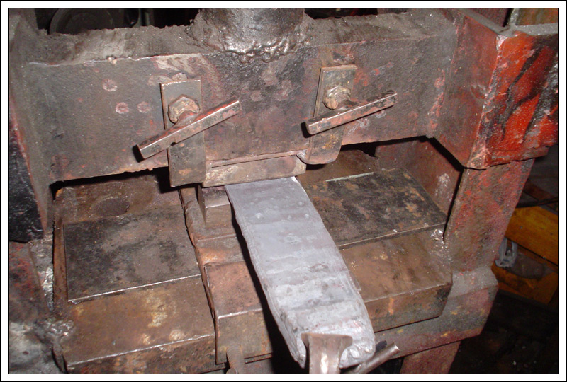

After I flaten it with the press, I get rid of the cannister by grinding it off.

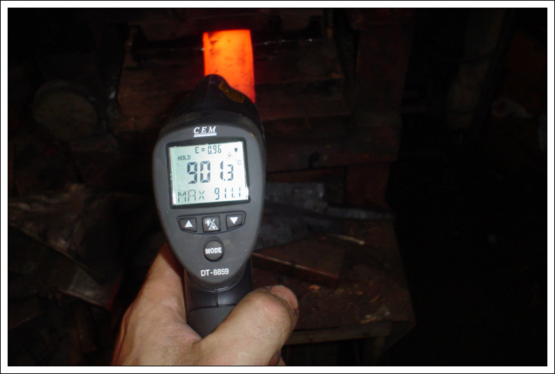

Oven at forging temperature.
Stainless forging temperature range. 900C - 1150C

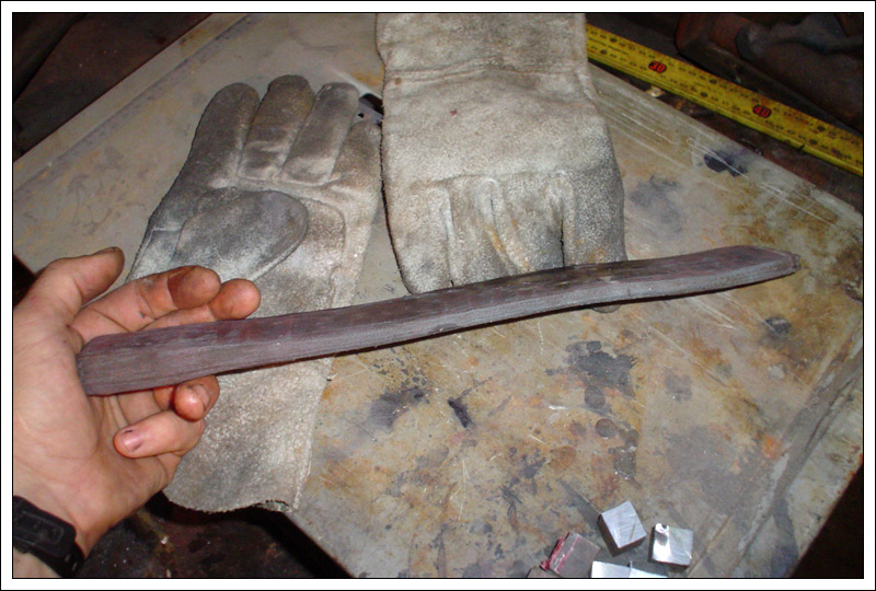

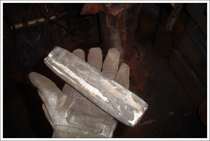

Stretched sheet of damascus.
Thicker, about 10mm, in the area where I'll make the spoon head.

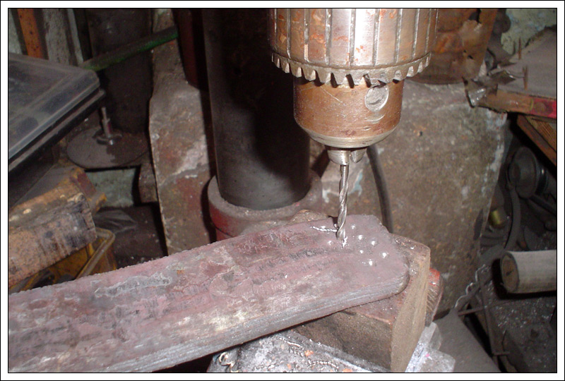

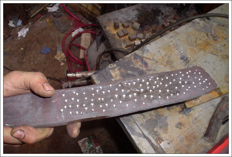

Drilling the damascus sheet to get the desired pattern (4mm drill bit, 2mm deep)
Almost done.

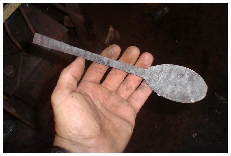

I keep heating to forge tempertature and flattening the piece until I reach a 4mm thickness.

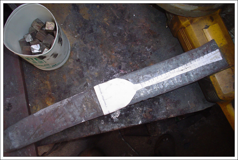

I glue a template for the spoon shape on the damascus piece.
And then cut it.

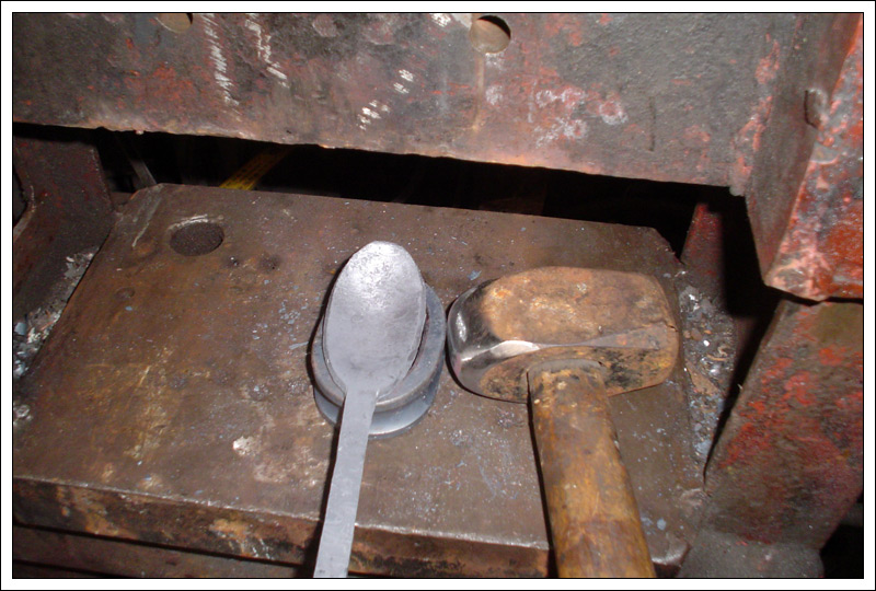

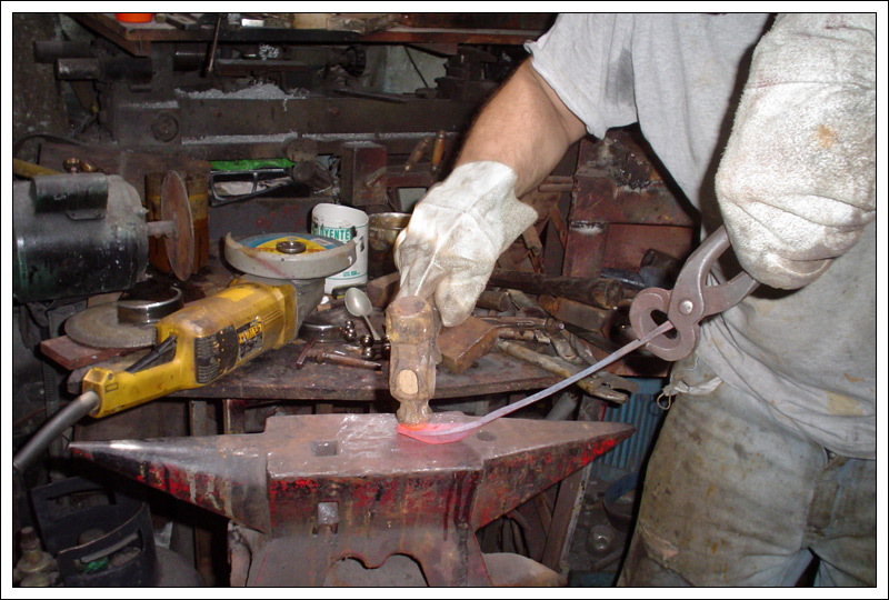

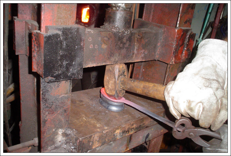

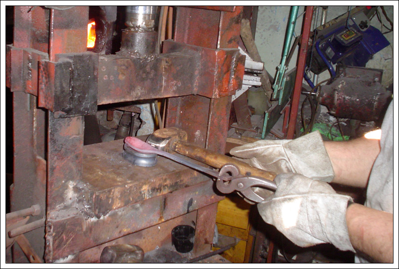

To get the proper spoon shape, after I heat the soon-to-be-spoon, I use a modified inner bearing ring (previosly heated and pressed to an oval shape) and a hammer head with a round end.

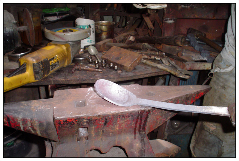

Now this starts to look like a real spoon.
Then I finish the forging to shape manually, with a smaller hammer.

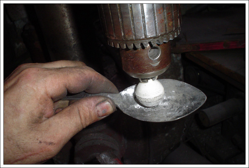

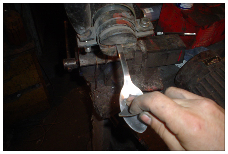

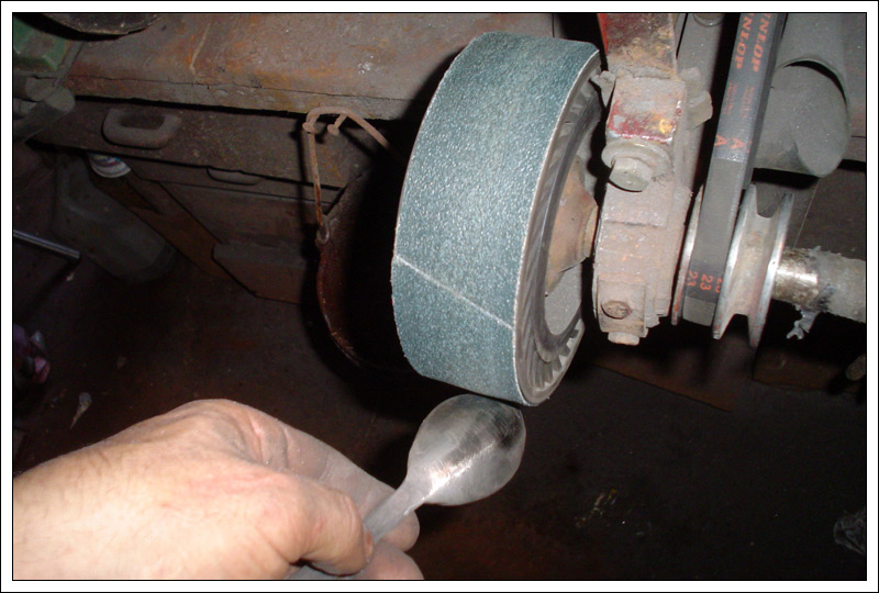

After the spoon is shaped, I grind the inner part of the head with a spherical grinding stone, mounted on a bench drill.

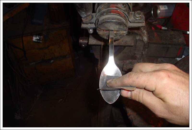

For the outter part I use regular sanding belts, mounted on a rubber adaptor on my bench grinder.
And then polish the inner part with sand paper, manually.

It's also very important to properly measure the temperature in the oven while you're heating for forging, as if it goes lower than 900C, this can cause fissures on the steel.
