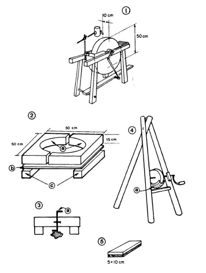

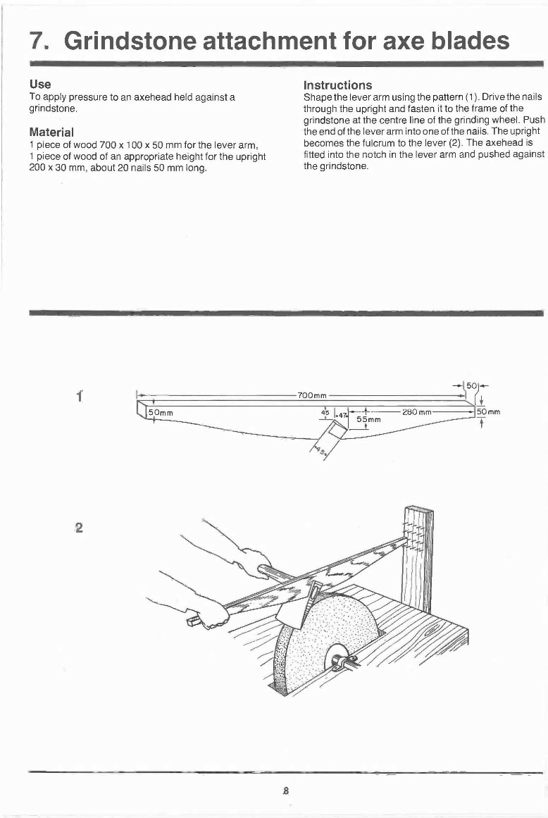

Want to make your own full size treadle grinder for axes? Here's how. See images below text.
You might want to construct several such levers for different sizes of axes.
That is awesome. I wonder if you could use silicon carbide powder or the like with the cement instead of sand.
