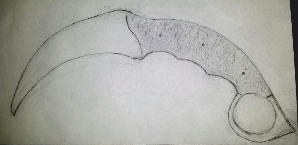

I have been looking for quite some time for the right Karambit and after much searching learned that what I was searching for did not yet exist, so I have decided to make my own one. I have the equipment and experience to make the blade and grips myself but what I do not have is a furnace that can hit 1500F and the technical expertise to properly cool the blade. So I was wondering if anyone knows of a good place, locally preferred (I live in Anchorage AK) but I am willing to ship it somewhere, that would be able to deal with the hardening and tempering. If not I know there are a few custom knife makers up here that I am sure I could get to do it but I would prefer a shop that someone has dealt with before and had a good experience with.
Here is the rough drawing that I made today while bored out of my mind at work, the next step will be modeling it out of clay so I can hold an actual size version of it to see what I need to change before starting to work with steel.

That looks like an awesome karambit, I do wonder how the spike on the end of the hilt will feel when you get the clay model made. Might want to drop the point fo the spike a little bit instead of having it proud of the top of the grip, but that is for working out once you have the model inhand.
I love the shape and the idea of damascus for it. As for the handle, I personally love a dark reddish wood with it like cocobolo or the dark almost black stained version of something like buffalo bone. Stag while beautiful might be a lot of pattern and kind of overwhelm the steel, it depends on how "busy" the steel you choose is. As for the tempering, let's hope on of the many knifemakers who spend time frequenting the cantina will contact you with either local to you folks they would recommend or an offer to work with you on that part. Perhaps you could work out a trade deal for the tempering with someone like JW Bensinger, maybe PM him with a question about if he would be available to discuss that sort of thing?
I agree on the hilt point, I'd round it off given the option. Just seems like a poker on the wrong end to me. I got no experience with any kerambit so my input probably isn't worth the cyber bytes it's written on.

That end will get rounded off a bit so as to not stab me if my thumb goes over it but not enough to get rid of the point. The Karambit is meant to be a hand to hand combat weapon so the reason for having a point on that end is to make both sides of the weapon deadly instead of just one. My plan is to, with the exception of the sharpened edges, have every surface rounded off so there aren't even any lines showing in the steel or the handle.

Regarding heat treat, either a charcoal grill (using some kind of blower) or an acetylene torch will get you to nonmagnetic.
I do 99% of my hardening with oxyacetylene- it also allows you to differential harden without clay.
Keep a magnet handy to check, and find another piece of high carbon to practice on.

Wasn't saying to get rid of the spike. I just think in the drawing it looks like it is actually slightly forward of the base of the handle and that might make it too far forward so it hits the side of your palm.

After a bit of reworking, the clay model is almost done and almost the only thing I had to change was to move the location of the point farther down the ring. I am at work for the weekend but when I finish the model next week I will post a picture. For a mental picture as to the relocation of the point, if you where to rest the blade on its edge with the tip and the ring touching a table the end of the point would also touch.
The damascus blanks I have decided to use are the Alabama Buckshot pattern from Alabama Damascus with a thickness of .19" +/- .01 and I will be ordering enough metal to make 4 of them (that is not to say that all 4 will turn out as I have not done this type of metal work before). The thickness of the finished product is not yet set but I wanted the blanks to be thick enough so I could hit them with a fly cutter on my mill to I have a smooth surface to work and so I could decide the thickness at a later time.
