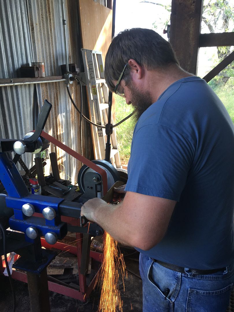

Here we go with the blade
Rons blank is on the left
[/URL]
[/URL]
[/URL]
More to come

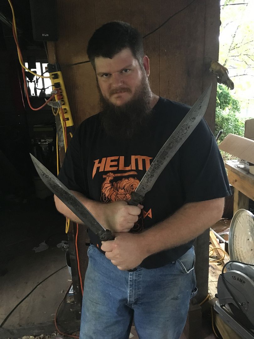

This one is done and should be heading to Mr LaClair soon
Hopefully I'll get some pics with him using it
[/URL]
[/URL]
Wow! Impressive...! I mean the knives! Well... the maker too!
Steve
Member, W.F. Moran Jr. Foundation
ABS Apprentice
Storm Crow your blades really have a hell of a unique motif. You really draw out those blocks of steel into some big blades, bigger than I expected when seeing them at Blade show. As cool as the forged socket handles are, those neoprene-slab handles are real nice for a chopper. Glad to see that.
