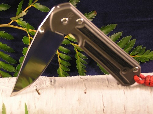

is it possible to make a mirror polish on a blade without any power tools? just your hands? exactly what is needed, and how do I do it? I guess the laser engravings on the blade would get polished away, but I could live with that.
You can use wet/dry sandpaper and just keep going higher in grit till you reach the finish that you are looking for. Semichrome will aid in the final step.
my vote would be a complete set of micromesh sheets, from the coarsest to remove the factory finish to the finest to get perfect miror polish, the finest grade micromesh produce scratches that you can't see without magnfication. prepare to spend hours and hours rubbing your blade.
this is f you want a truly perfect mirror polish. if a very refined and bright satin finish where you can see yourself in it but cloudy don't bother with micromesh, sandpaper up to 1500 and polishing paste will do.
I did this to one of my knives. in grits 180 , 220, 600, 800, 1200, 1500, 2000. then you can use any stropping compound or an autopolish :) hope that helps

S30V can be done with with some success using the methods I mentioned above. This Sebanza did not come with a polished blade. You will find that a high polish on a blade, if a user, will show marks and scratches quicker then lets say, a satin finish. Like Noctis 3880 said, some steels are near impossible to do.
