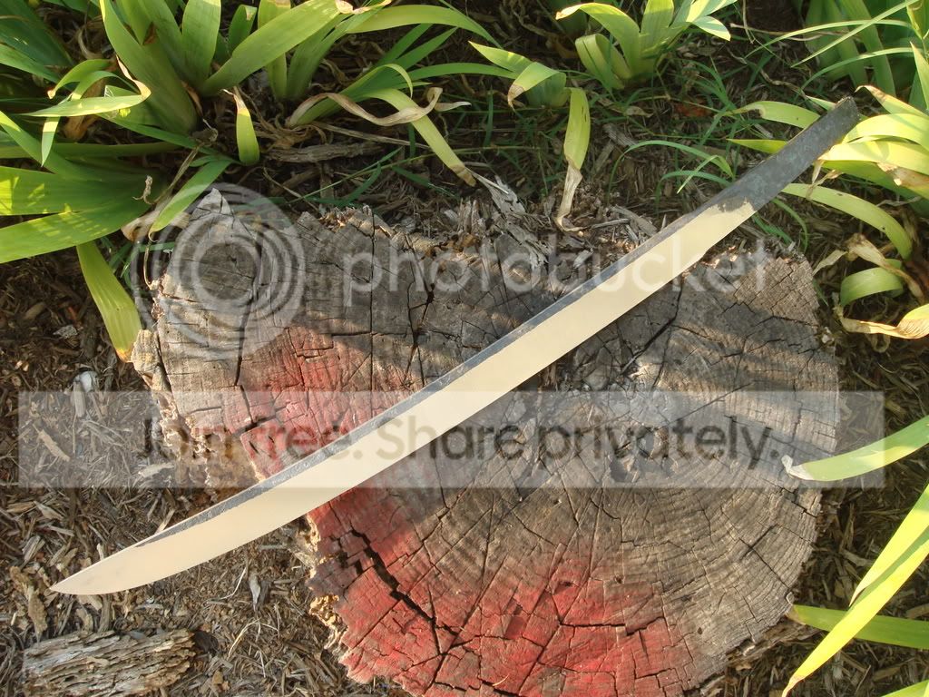

hey everybody...
relativly recently i tried out swrodmaking.. and broke the Wak in the process. well.. i am back again. i am using W1 steel, and i froged the sword to shape.. i put some sori in there before hand as i am going to be quenching with Parks #50. as i am still relativly early in the process, comments or advise would be greatly appreciated.
thanks!
~Chris

You should be a world better off with the oil quench.
Clay coat it just the same as last time. Quench straight in and pull it out in about five-six seconds. It should be well past the nose by then (beware !!! It will ignite in a flaming ball, and/or smoke like hell). Give it a fast wipe with a dry rag (which may ignite,too) and check for warp and twist. If there is a warp, put it on the anvil and whack it straight with a wooden mallet (or just use a flat 2-3# hammer). If it has a twist, stick it in a straightening board and give it the necessary tweak. The board is a piece of 2X6 with a 2X1/4" slot in it. Clamp the board in the vise. You can also make a straightening hardy for your hardy hole by welding two pieces of 1/2 round stock on two adjacent sides of a piece of square stock to fit your hardy hole. The gap between the rounds should be 1/4-3/8".
You have about ten to twenty safe seconds to do the straightening, so don't waste time.
Once the twist/warp is QUICKLY straightened, stick it back in the oil to cool for 2-3 minutes. CAUTION - Once the blade is below 400F, don't straighten anymore or it will break. If the twist warp is too severe - anneal, straighten, normalize, and re-do the HT.

Blade looks great! I have done W1 blades that thick and wide, judging from the picture, but never nearly that long. I've had good results using and irrupted quench as well. I will add to Stacy's great post that for me I have found that I crack fewer W1 blades if I have the temper heat ready and RUN not walk to get the blade into the sandbox or oven before it gets below 130 or so. It may be just blind dumb luck, but it works for me. Some of the realy smart guys on TBF might explain why.

the blade is just over 18" and the oal is just under 24"
wow... thanks for the post Stacy, that is gonna be alot of help. i am gonna try a different way of heating this time as my HT forge is too small. gonna tr the traditional small fire big sword thing and "stoke" it in and out, you know? i already tried it ou when i was normalizing the blade... gonna try the HT forge (to see if it will fit) to see wich one works best.
yep.... i am planning on doing a traditional wraped sheath. gona try horn fittings this time.. i like how that looks.
question here... how hot does the oil need to be before quench?
also, since i have a curved blade... i cant to a perfect edge quench and will have to "roll" the blade. put the tip in first? or the main part of the blade?

I would advise against trying an edge quench on an 18 inch blade of W-1. Also the stroke method of heating to critical is iffy. Sometimes it works, sometimes it doesn't.
Stacy
I forgot to mentiton, in repsonse to the question on the hamon... i partially etched it... didnt polish it up real fine to see it in detail.. but the hamon was way far up on the blade.. almost past midpoint. no wonder it cracked. so i guess what would mean that i got it too hot? also i think they clay didnt cover enough of the edge for a good Choji hamon like i was shooting for.

Again, I would agree with Stacy. Edge quench can be risky. W1 is extremely predictable if you control the variables. Possible outcomes that increase with length. Point quench = warp and crack. Edge quench = more curve and crack. Spine first quench = take out your curve. All possible or not depending on control of variables.
Oil Temp 130 is pretty common. Make sure you have plenty of volume so the oil has more effect on the steel than the other way round.
If the blade will not fit in completely you can us a torch on the remainder. I suggest the end near the hand since you will not want to over harden the spine and handle too hard anyway. W1 will get brittle.

I think I was misunderstanding your term "edge quench". If you mean a full edge in quench, then that is a good choice. I would use a full edge first quench or a straight in point first quench.
The procedure that I am not a fan of is trying to quench the edge only and not quench the spine at all. Rocking the blade back and forth in 1/4" of oil is just not a suitable quenching method ,IMHO.
