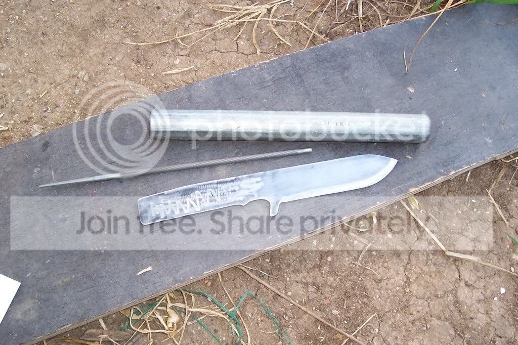

Making another knife for just general abusing :)
Jun 7, 2003
1,850
I been reading all the "got me a new woods knife" type threads and feeling jealous , bad feeling that , having the green eyed monster on my back like that ...

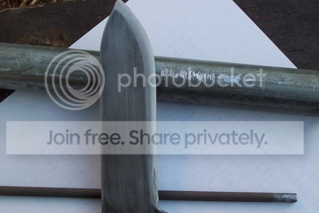

so I got me out the high speed steel scraps and knocked out a few blades , this one Im keeping , no handles yet , its a toss up if it wears iorn bark or she-oak still , depends which log is closer to the chainsaw when I get it fired up :)
anyway , I was sitting down just messing with the blade and then I was messing wth the chainsaw sharpening file ...
anyway , here are some picks of my new halfway finished knock around knife , hoping to shift the green eyed monster onto someone elses back :)

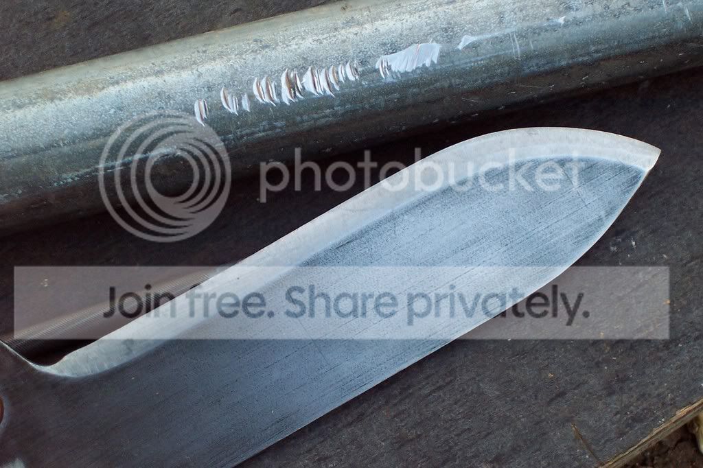

I dont expect to be making fuzz on pipes and files in the bush , but I like to have a knife that I can do that with anyway and not damage the edge ... just gives me that bit extra confidence :)
updates will be coming , I was going to put a handle on today but it didnt happen , probably Monday or Tuesday now .
Wow! No chipping or nothing! That looks like it's going to be a winner. Definitely keep us updated.

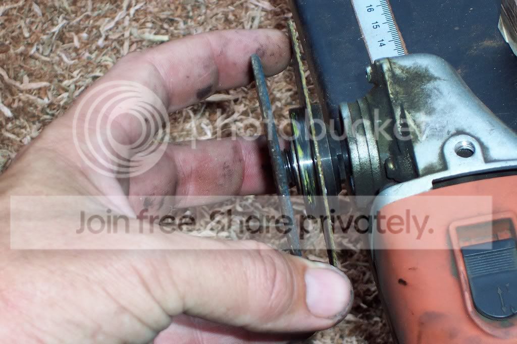

I use a 5 inch angle grinder I got for AU$15 at supercheap auto , I get the cutting discks that are under 1mm thick from the hardware store for about $5 a disk , one disk does heaps of cutting , the grinding disks I get at the same place they are nothing special , and the sanding disks as well , the one machine does pretty much all my profile cutting and shaping and even does the bulk of carving the handle

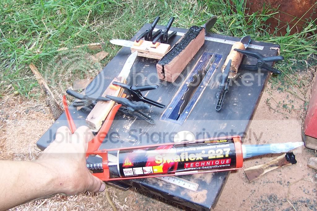

I cut my handles with a chainsaw ( well , my handles DO come out of my firewood pile ) and a little circular saw or just a handsaw , sikoflex urathane ( windshield adhesive ) to glue the handle slabs on ( high speed steel is too hard to drill and rivet , but these days if ya look around there are some super fantastic glues around to use )

handles are on
they dont look much , and seriously they are cut from the firewood pile
I reckon they will clean up OK tomorrow tho .

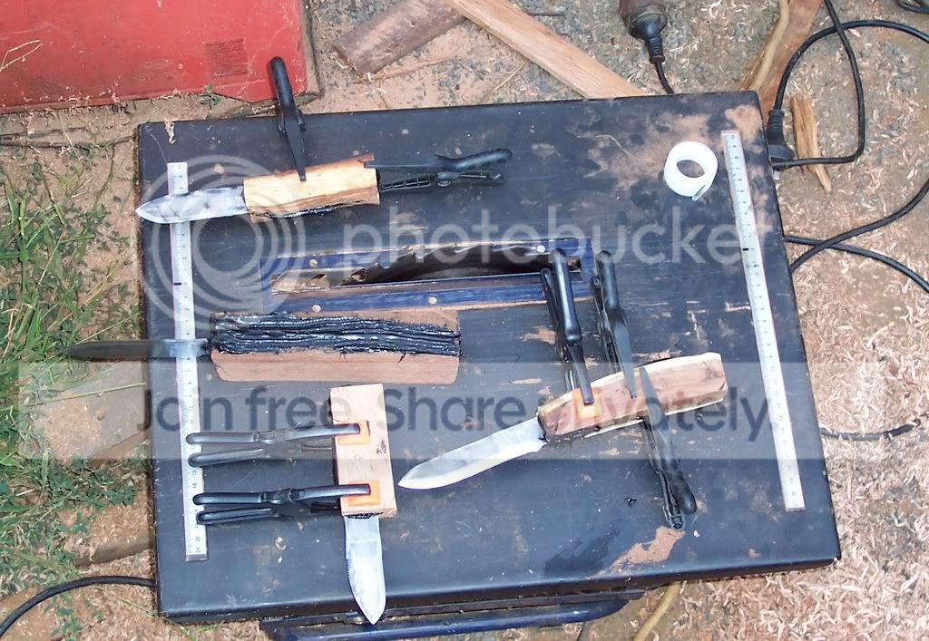

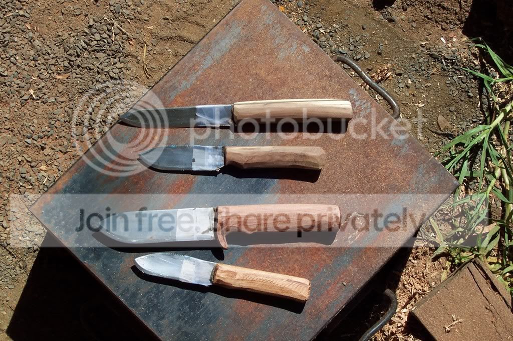

OK , so there is more than one knife Im doing , I got a couple little ones with saw backs , and a couple bigger ones
also this is the cutting disk I use compared to a ordinary cutting disk , the thin ones do a better job in my opinion .. easier on the machine anyway
Some seriously talented guys on here. Nice wor, and I like that blade profile a lot.
Myal, that is the same grinder I have.:) The thin disks are slicing disks, used to cut on the edge of the disk, to slice through something. The thicker ones are grinding disks, and are designed to be loaded on the face, rather than the edge. If you use the thicker ones as a slicing disk, it takes forever because you have to remove 3-4 times the amount of material.
Hmmm...I've got some Sikaflex 291 kicking around from boatbuilding jobs but I never though to use it to adhere scales. Any particular weaknesses you've found with it ? (besides the fact that it gets EVERYWHERE, lol). I think the black (or white) line would look good, like a spacer.
My grinding disks are 3-4 times thicker than the fat cutting disk , also they are offset , not flat .
We may be many years behind the times techwise tho , or I may be anyway , I have only found the thin disks in the last few years here .
This is the one I use :
You are very right , it gets everywhere , that and diesel oil are why most of the clothes I buy are black , it means that the stains dont get noticed :)... this one I think is not as strong as the windshield version , but I couldnt get that when I wanted it , Ive used this before and havent had troubles tho . I just like to go a bit over spec at times .. well way over spec I spose :) but I cant drill this tang , too hard , so I cant rivet the handles the glue has got to do the whole job on its own .
keeping the handles level is a pain , this is my first time using clamps like this , usualy its a vice or vice grips .
white tends to go grey with extended hard use and no cleanings much , but if you put the time in to keep them clean , they do look impressive .

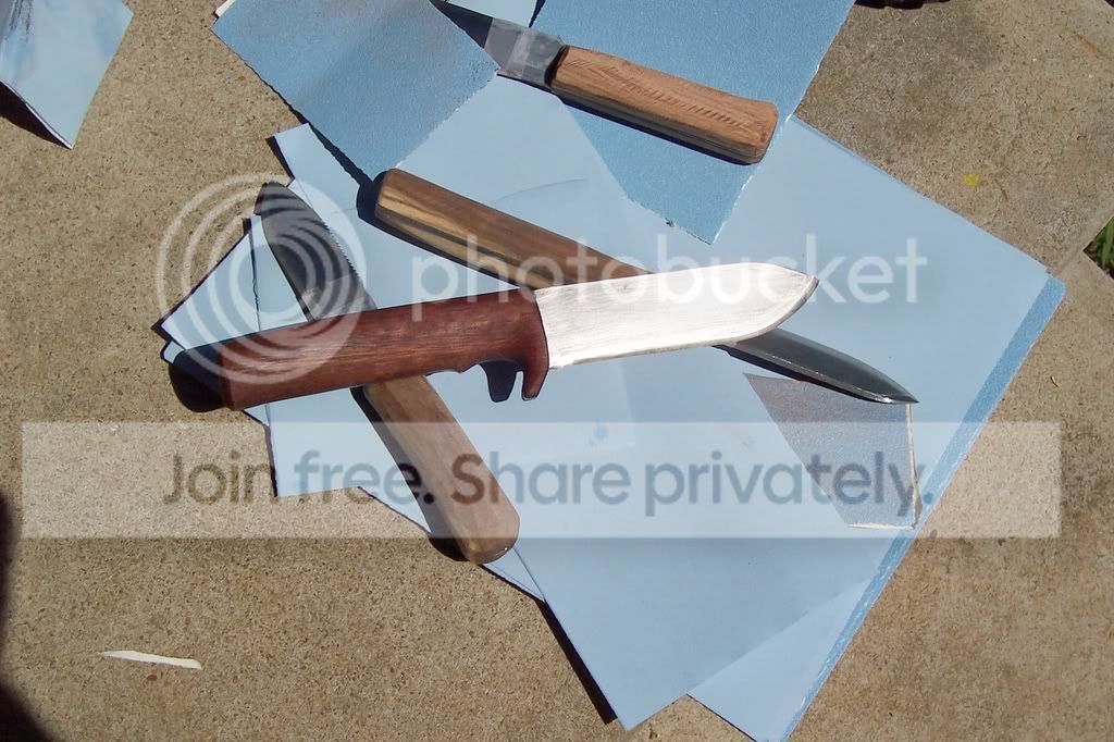

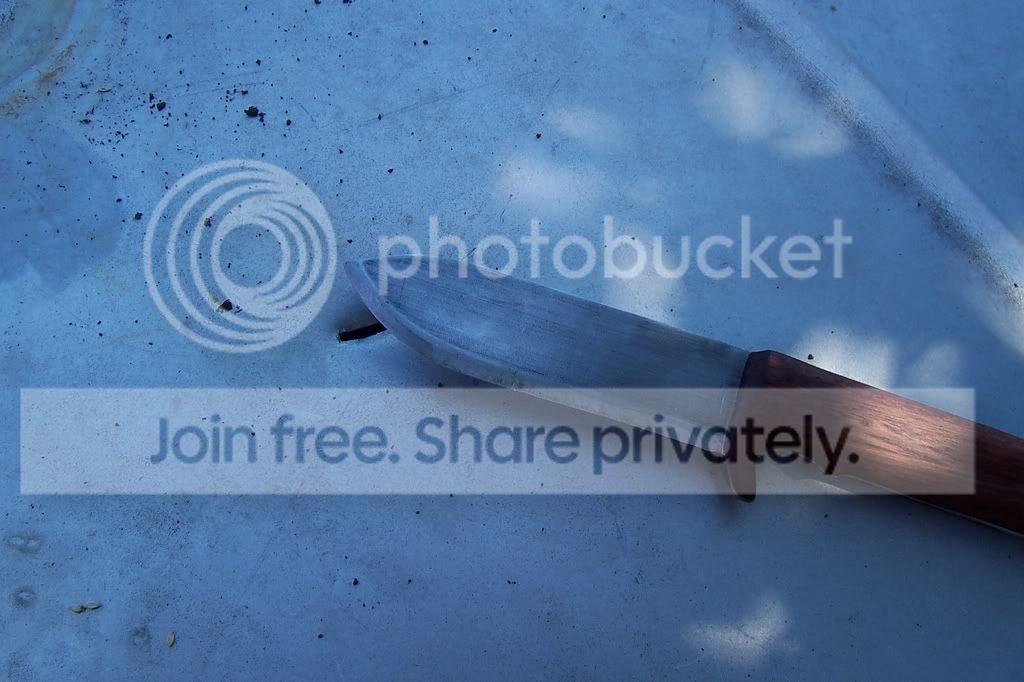

Got some time ( kids are at school ) and finished up the main knife ..

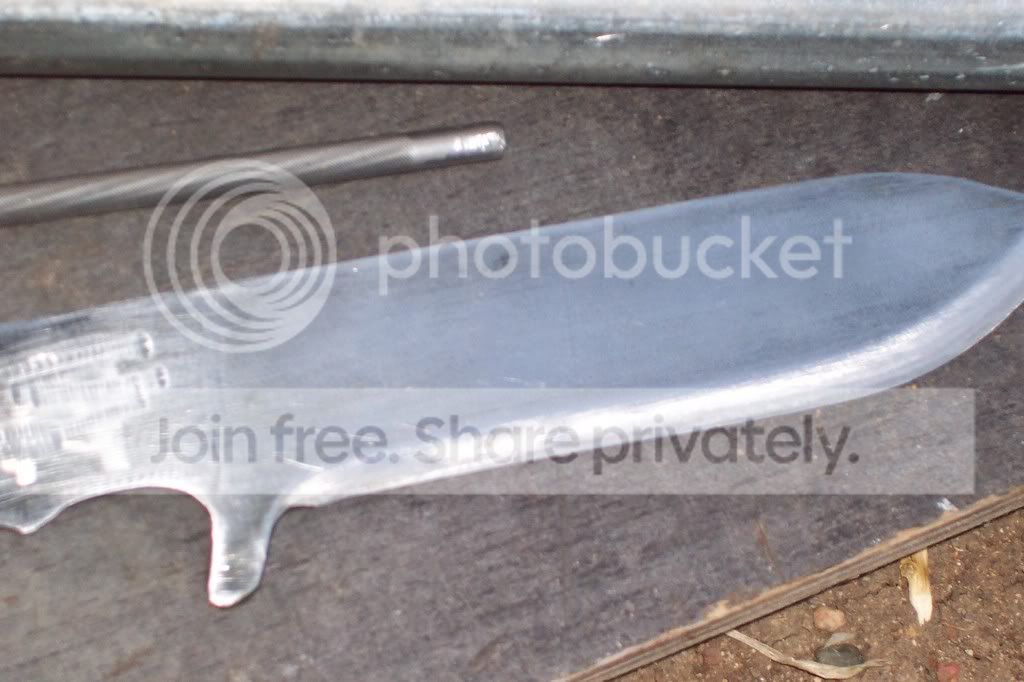

roughed out with a sanding disk on the angle grinder :
rough edges taken off with sandpaper and a bit of veg oil to make it pretty :
because the thing is made for general abusing , I generally abused it some :
it didnt do any harm to the knife edge or point :
I didnt make it shaving sharp yet , its slicing printer paper sharp tho , both before and after wrecking the datsun TRX bonnet
I got a few more to finish up before the days out , but I got me a new knife for general abusing :)
Im seriously hoping that I gone and made some other folks jealous now ... just passin the vibes on
