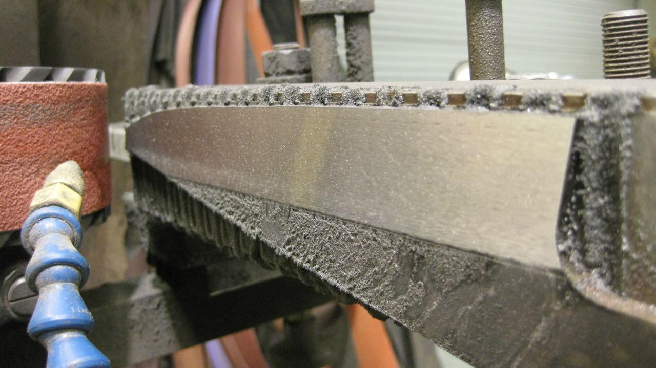

Travis Wuertz' surface grinder is pretty good for the home shop. In huge volumes there may need to be changes. I did some work with his grinder and with just the simple angle set up it cut down a lot of time in starting a grind. I don't know if it's what you're looking for but maybe someone will gain something from reading this.
Here is what I did to set up the angle - using geometry you can calculate the 'triangle' and thickness of the shim:
Setting up a blade can take 30-60 seconds, and grinding is about 30 seconds.:
I remember when I visited his shop earlier in the year he had a modified setup of this where it held two blades, point to point, and there was a mechanism to 'bump' the angle of each blade so it accounts for the change in profile. You'd have to model it out using a CAD program and tailor the modification to a specific model, but if doing a run of 100 or more blades in a small shop, it was really dang nifty. I'm not sure if Travis still does that kind of stuff, but I could always ask.

They were ground post-HT, on blanks that were 0.180" thick. With thicker blades, you really wouldn't see much of an increase in time, maybe 10 seconds or so. Most of the time is involved with stopping and changing out the blades :)
That's pretty much a Sine bar and gauge block set-up. Nice work
