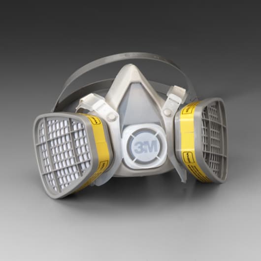

Not a mask....a respirator...the difference is huge.
Are you refering to one of these as a bare minimum or a full-facemask, dedicated air supply, respirator?
http://multimedia.3m.com/mws/mediawebserver?mwsId=66666UuZjcFSLXTtNXTXmVs6EV76EbHSHVs6EVs6E666666--
Kalel - You're going to want a respirator that seals against your skin to keep the particles out. A simple dust mask doesn't seal well and you'll eventually breath it in. It might actualy be wise to use a full facemask since some of the laminate material is made from glass fibers (fiberglass, carbon fiber, kevlar, etc). Pretty sure if any of these airborne glass particles collect on your corneas your not going to be happy camper.
Yes, that is the type I am referring to. You need a good filter cartridge respirator/mask. Many folks call a mask one of those painting filter things, A respirator filters the air to a much higher degree, and seals all other air out. Most will remove 99% of all particles 1 micron and larger. Cartridges are available for organic vapors and formaldehyde,too. A full face unit is best, but a good half face unit is fine if you wear safety glasses. Eye protection is a must in the grinding shop. If you aren't sensitive to the formaldehyde vapors, a positive pressure hood/hat works well. The Trend Air Shield or the Air Cap II are both great units for the shop. Dedicated air supply hoods are super, but most shops aren't set up for them.
