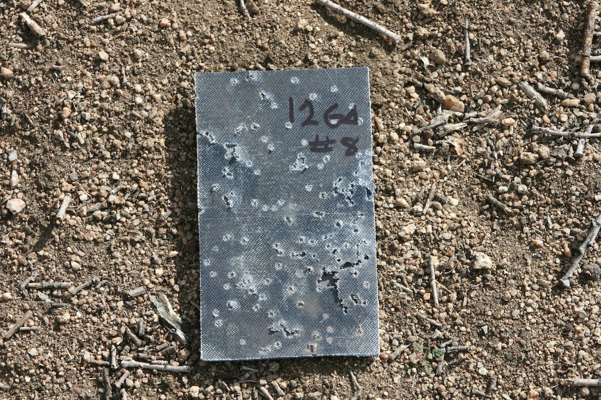

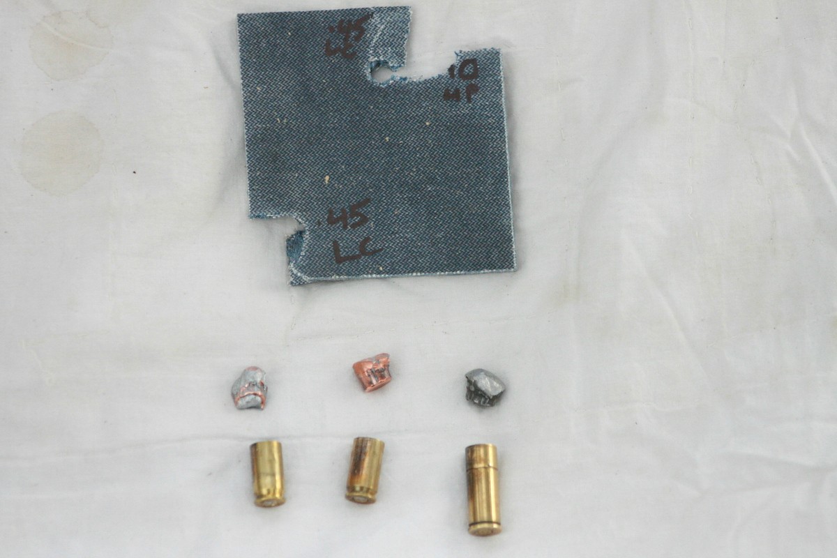

Thanksgiving last year. My brother and I went out to the ranch while the bird was cooking. This is homemade "wranglercarta". Made from my old jeans but not by me. I've tried it 3 times and it came out well once. Very messy. Thickness 1/4" to 3/8" on these pieces. Always heard how bulletproof this stuff was. Wanted to find out. All shooting was at ten paces.
1/4" pece stopped a 12 guage with #8 shot.
3/8" stopped a .22 LR.
12 gauge
This piece sustained 2 .45 colt hits, a .40 and a .45acp . Slowed em down enough that the rounds were easily recoverable.
While not bulletproof, I would not heistate to put on a knife handle and did. Need to get me some more.
