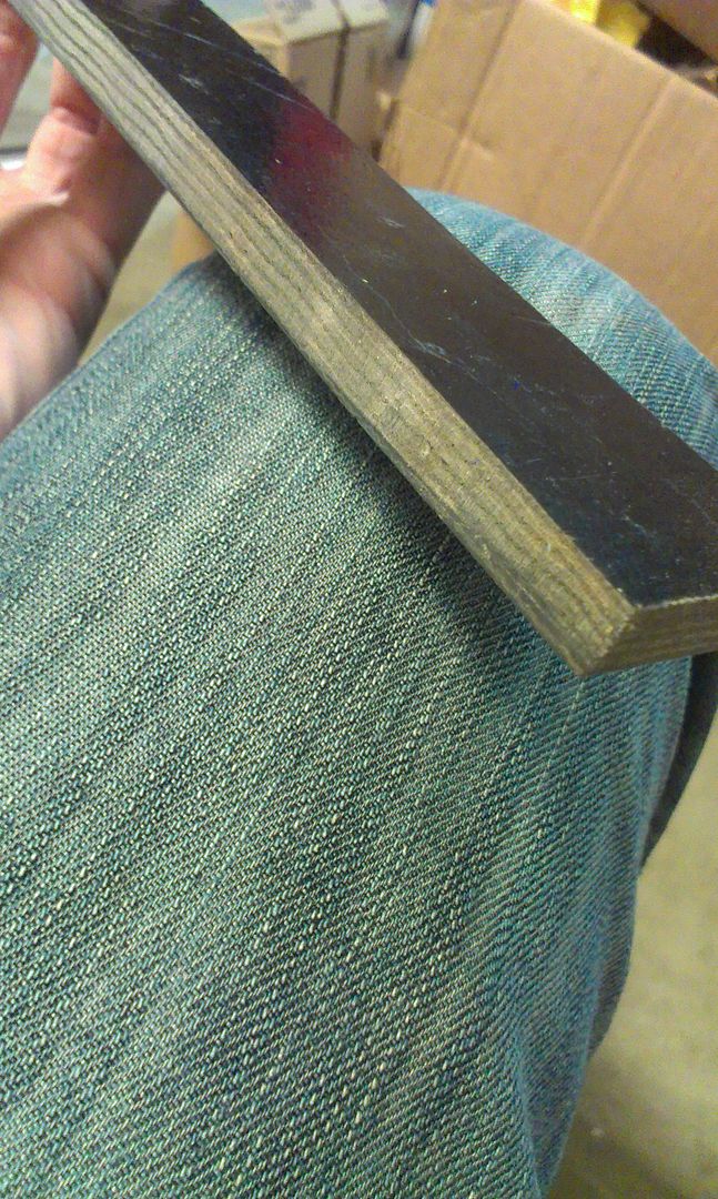

Oddly enough, as I was going through my storage tonight digging out a grinder, drill press and some other goodies, I came upon one of the first pieces of micarta I ever made. It's about 8 years old and covered in dirt/dust. I believe it's black and gray layered cotton.
I think that I never used it because the layers weren't consistent. You can see that on the side. Even so, it is extremely strong and probably useful in some capacity. If nothing else, for tool making.
Here's a quick pic in bad light.
