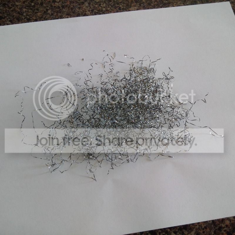

I cut off a piece of stainless scrub pad and unraveled it.

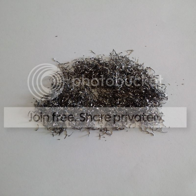

Then I cut it into pieces.

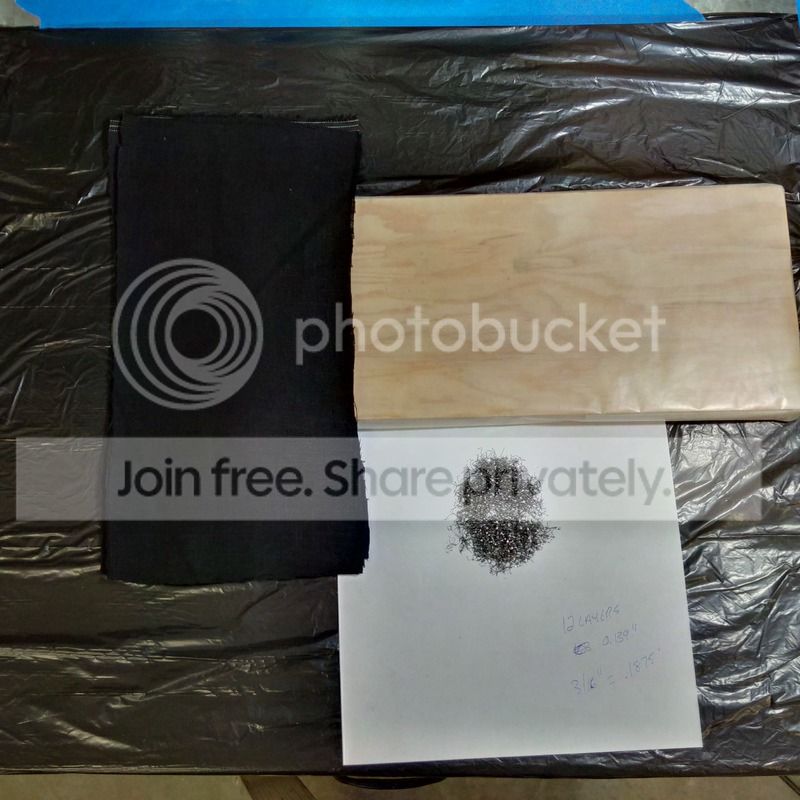

I should be able to make scales for 4 folders if this works out.
The main ingredients with a wax paper covered board that I will lay them out on.
All layered up.

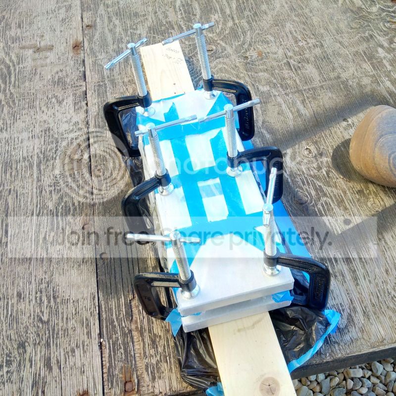

I clamped it up between my quench plates (covered in wax paper) and used a caliper to measure the 4 corners so it should be pretty flat and consistent when it's done. It will sit outside till the stink is off of it.

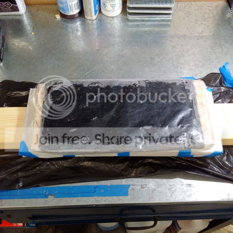

Instead of mixing the stainless in with the resin I sprinkled it between the 2nd and 3rd last layers of linen. If it doesn't look good it will go to the inside and I can still use the material (hopefully).

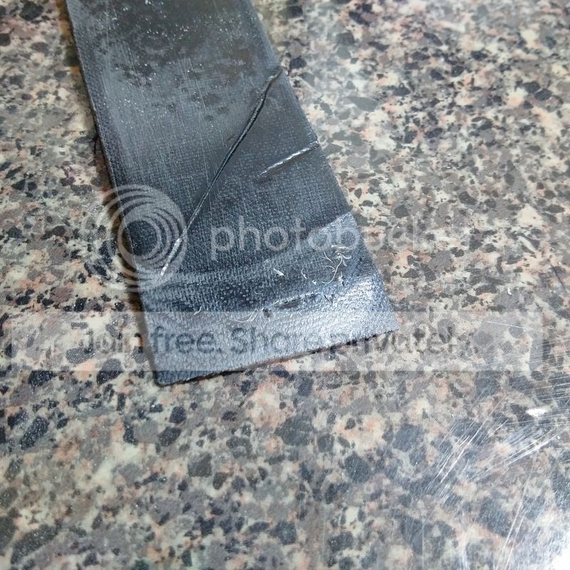

The material didn't turn out too bad. The metal doesn't do anything for me so I doubt that I will be doing it again.
Try it again with the InLace powders or flakes that Stacy suggested. Kudos for trying your idea. Whether it turned out as you would have hoped or not you still learned something which is a win.
And without something with more "pizazz" black paper micarta is so cheap to buy anyway I wouldn't bother. Make something cool like the one that someone did with a poncho or a sarape or something.
