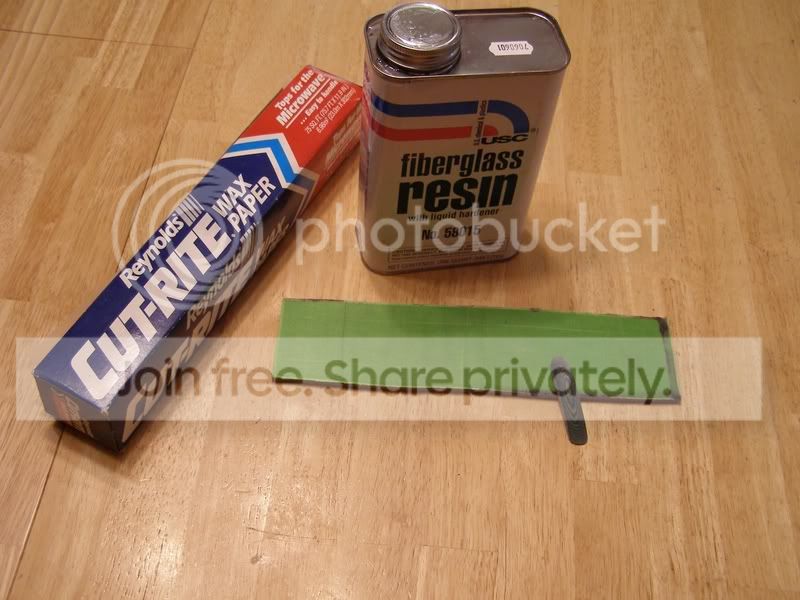

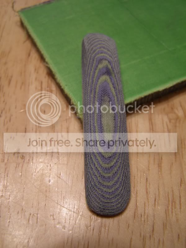

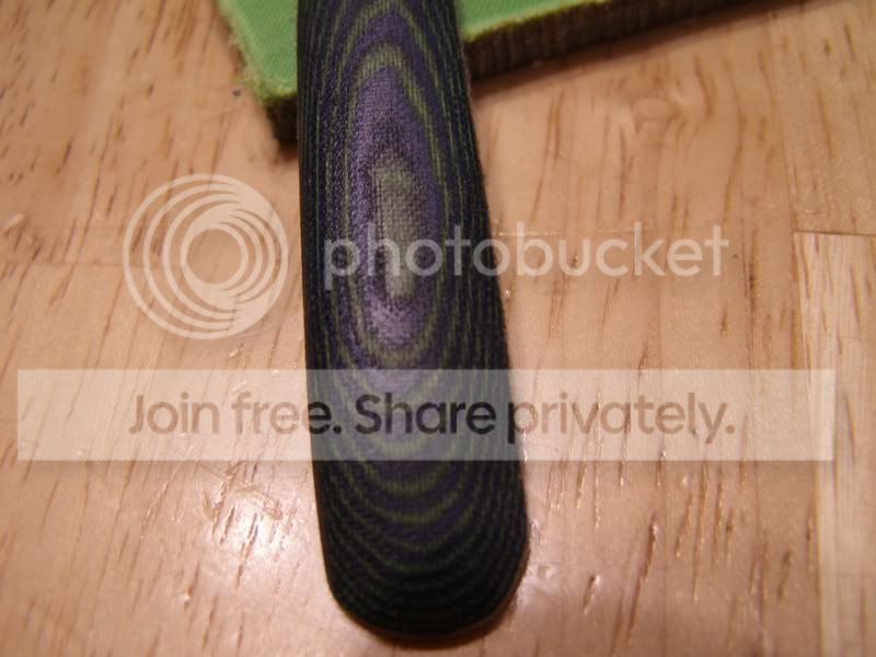

here is the Micarta I made after reading the tutoral from one of the makers here and after reading this Post. The material is Green and Blue (Sea Hawks Colors) I used this USC Fiberglass Resin found at a local parts house. Wax paper Boards for a press with C-Clamps I sanded a small piece of it early to see how it would look I liked it a lot. Now I just need to let it set up for about two more days to make sure it is ready.
The micarta in dry form.
The Micarta after a quick shot of WD-40 to see it wet.
