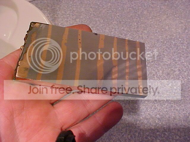

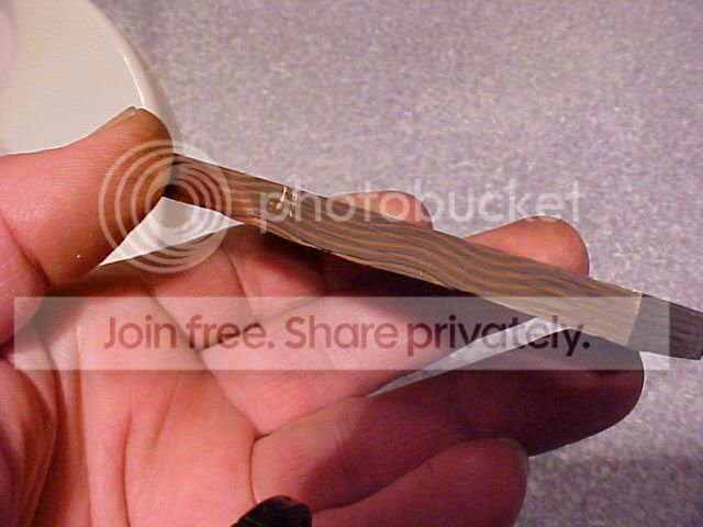

I had a go at making mokem today, it came out ok but not as nice as I have seen here on the forum.
How thick do you normally make your blocks to start with and how does one go about making a nice pattern.
Thanking you in advance for any information

What materials are you using? What method did you use to fuse it?
To get an attractive pattern, the mokume billet you have now must be cut, stacked, and re-welded ( to make more and finer layers).
I start with a 2"X2"X2" block, fuse it in a torque plate, and work it down to about 1/2". From this I cut pieces to pattern, and then work a piece out into a smooth and even bar about 3/8" thick. At this point it will have a random pattern, and be OK looking, but farther patterning will make it nicer. You can either drill little divots about 1/8" deep all over both sides, or cut grooves across both sides ( don't line up either side to side). Forge this out flat, and sand down smooth to about 3/16"-1/4" and you will have raindrop pattern or ladder pattern. Any of the simple damascus patterning methods can be done with mokume'.

I fused copper and 4130 in the forge using clamping plates then ground in lines on both sides 3 layers deep with a 3/4" wheel on the Radius master, forged it flat and sanded it down.
May have to get longer bolts to fuse a 2" cube
