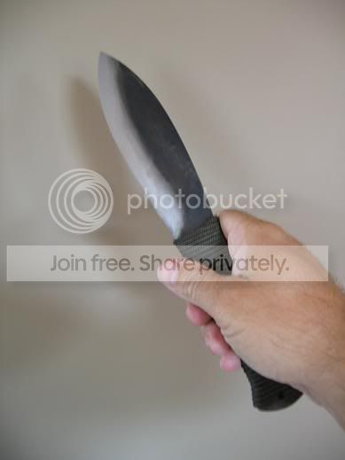

Had a little time to mess around with the "Leaf Blade" knife...... still in the developement stages.... haven't decided on handle yet ... cordwrapped for cutting tests.... Differentially heat treated, full convex grind.:jerkit:

Ya I know..... no guard... but that's how I like it.;)
That's a really cool looking blade, good work! Just looks very useful and 'to the point' :D. I'd not mind having that blade style as a user even a little bit.
What's the thickness? Comfy in the hand? Please do take some shots when you put it to use.

The blade is 3/16" thk and it was diff. heat treated with the spine scraped clean of clay.... this way the face of the spine is hardend so I can use it with my flint for fire lighting. This is going to be a hard working knife so I wanted something with a little weight to chop but not overly bulky. i think it will perform nicely.... I'll definately post some pics of it in use.

Nice knife. What type of steel? Sheath?
I usually use Nicholson files W2, but I got some O1 recently and gave it a go.
Oh, and I learned the hard way not to water quench O1... lol.
I make my own leather sheaths but I might seek the help of Eric(Normark) on a kydex/leather hybrid. Or maybe I should try my hand at wood?
Still undecided.
