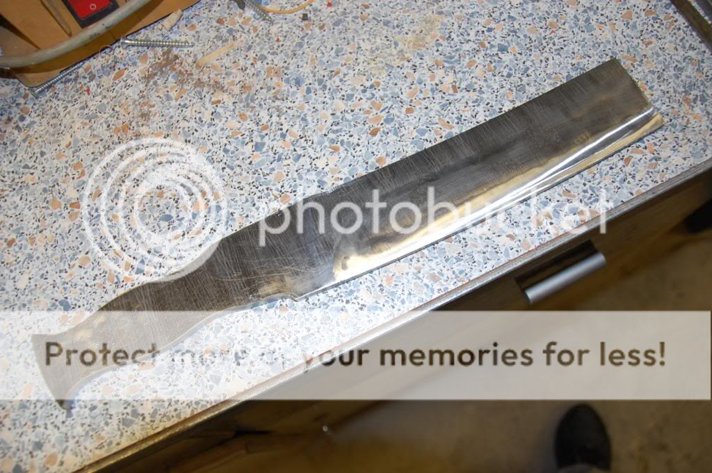

I just started to make my own cuttingcompetition knife It's made out of A2 steel and is 8mm thick (aprox 1/3")

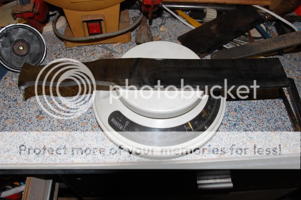

The knife has a weight of 1100grams way too heavy
The work is still in progress i don't have a beldgrinder so it will take me a while to finish this knife i hope it's finished before the 24e because there will be a cuttingcompetition over here. I really like to know how the knife will hold in action.

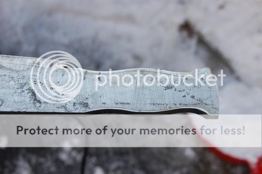

looking good but I think you will need to thin the blade a bit more.
It should chop wood as is .

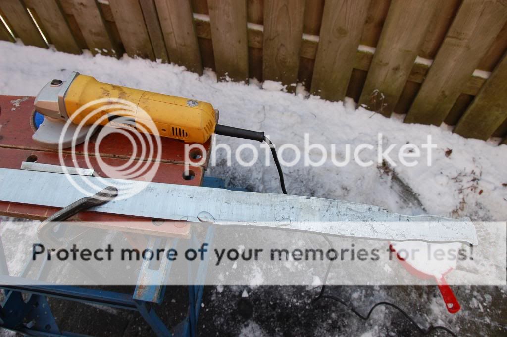

Thats quite a lump of steel!
I wonder if an angle grinder jig like this would help you knock the 'meat' off the blade?
(ive never made or used one, but it looks like it should do the job nicely!) -
http://myhome.mweb.co.za/~20022586/jig.htm
all the best, john
Hello John
I must say i've never seen any thing like this it's not difficult to make this and i thinck it's quit handy for grinding the blade in a full flat grind.
I'm a metal worker so this won't be a problem to make and i probebly will make it.

it's nice to show work in progress a least i like doing that. Today i spend some hours in my toolshop filing the edge on the blade one side i almost finished i only need to sand it.
At the moment my knife is almost finished, only the guard needs a little touch up, hardning the blade and putting on some rubber handels and the sharpen it.
