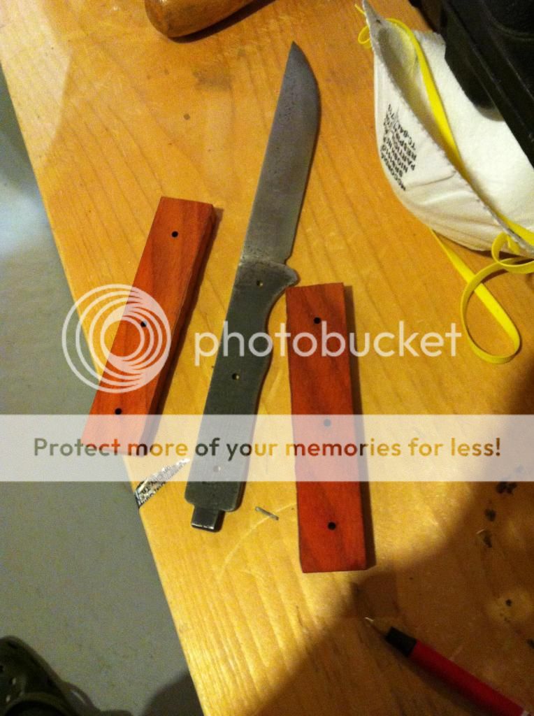

Have you already drilled your holes in your tang?

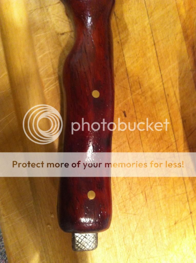

I think three pins would work the best. But surley you could find a wood specialty store near you and a lot of hardware stores should sell brass pinstock. Also there is no need to peen the pins if you're going to use adhesive, and stainless pins don't really have all that much more advantage over brass. Besides if you're going with a traditional style, brass is the best option

A three pin handle construction is plenty durable for any knife out there. Also with the combination of a adhesive it would more than suffice your uses. Some people use JB weld, but I personally have had great luck with Gorilla Glue. If you can't find that, just look for a glue that bonds to wood & metal. Also some adhesives expand, which is fine, but don't glob it on if it does.

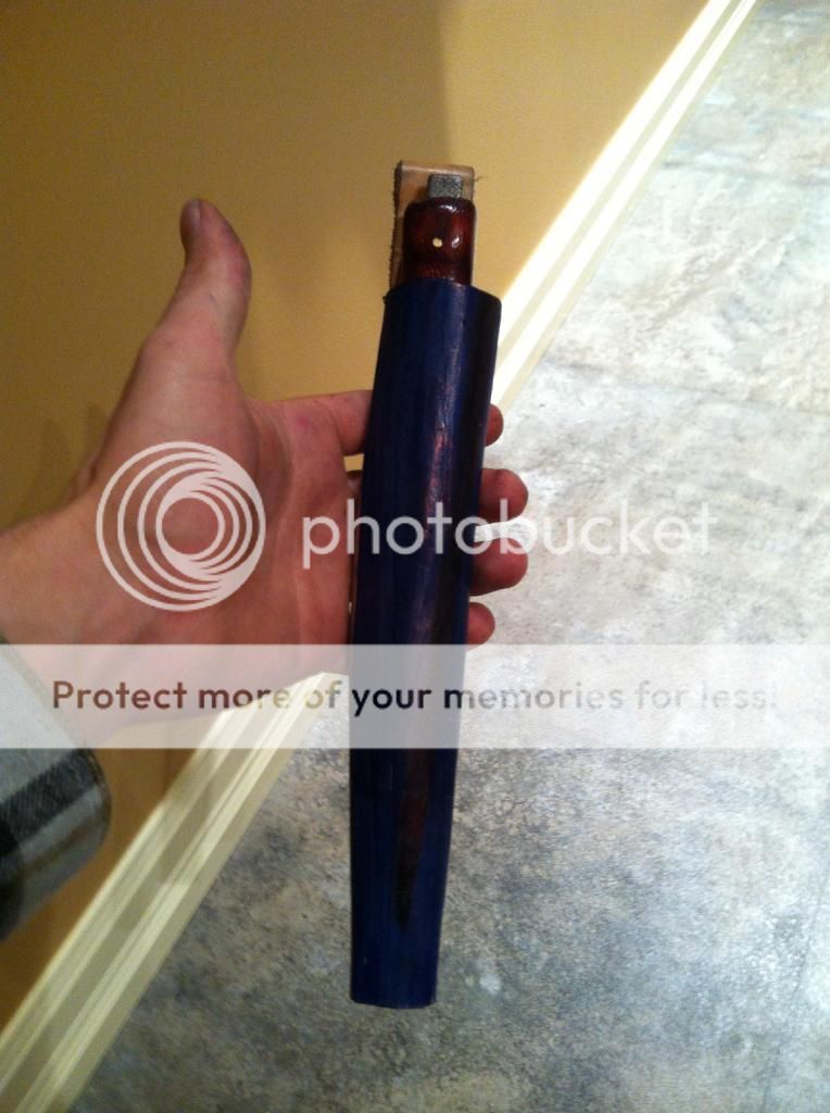

I'm supposed to be studying for finals but got bored and took to photoshop to plan out how i want it to look. Although i really wanted to dye the wood bright blue...

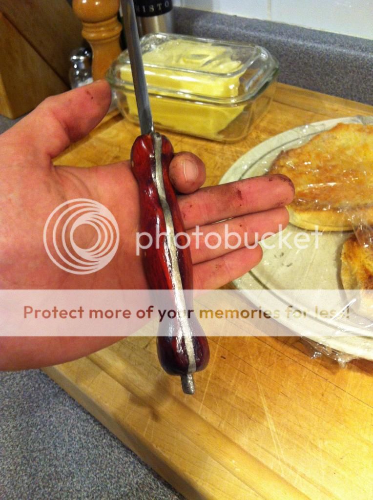

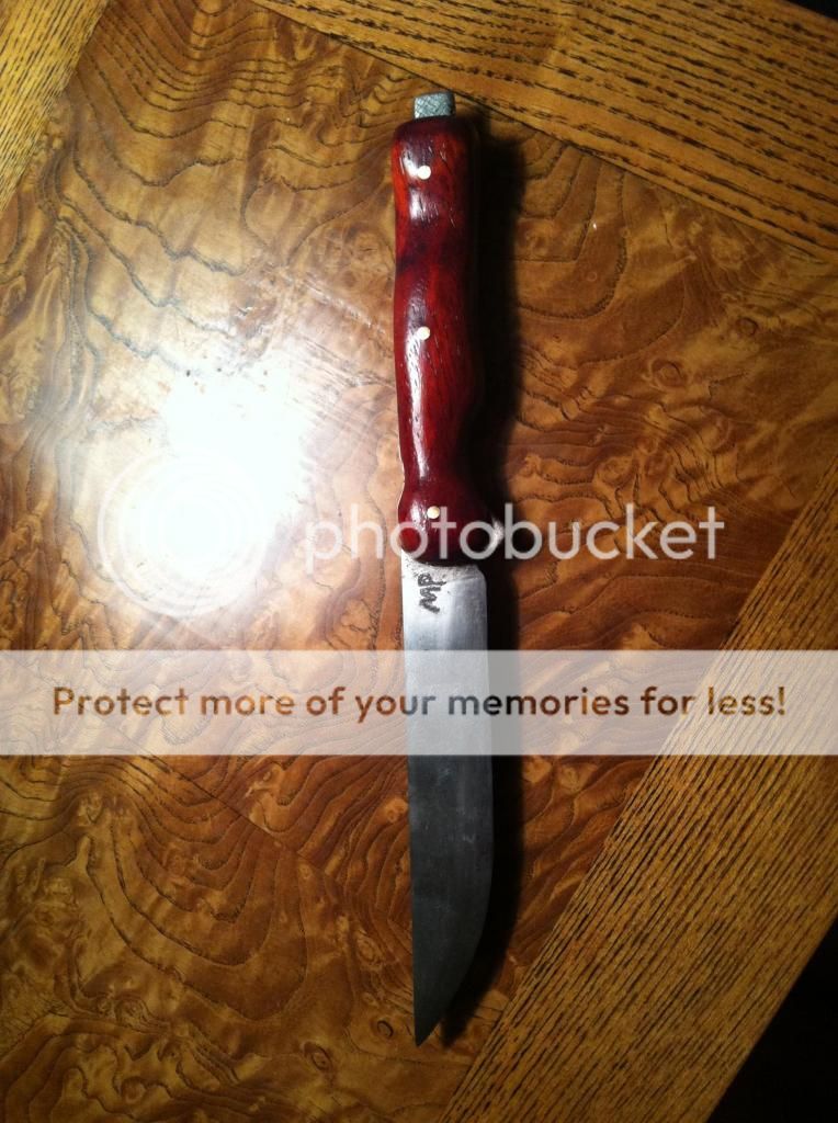

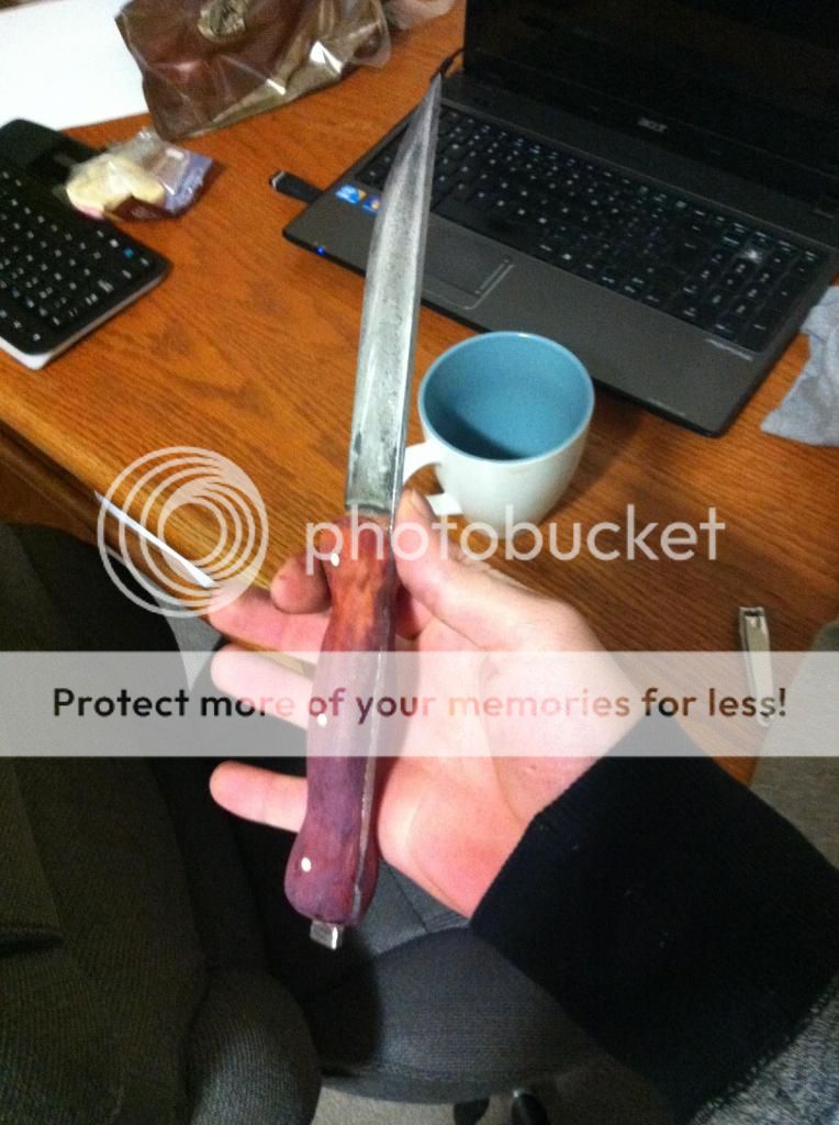

Finals finished up and i finished off my knife the next day. Heres the pics

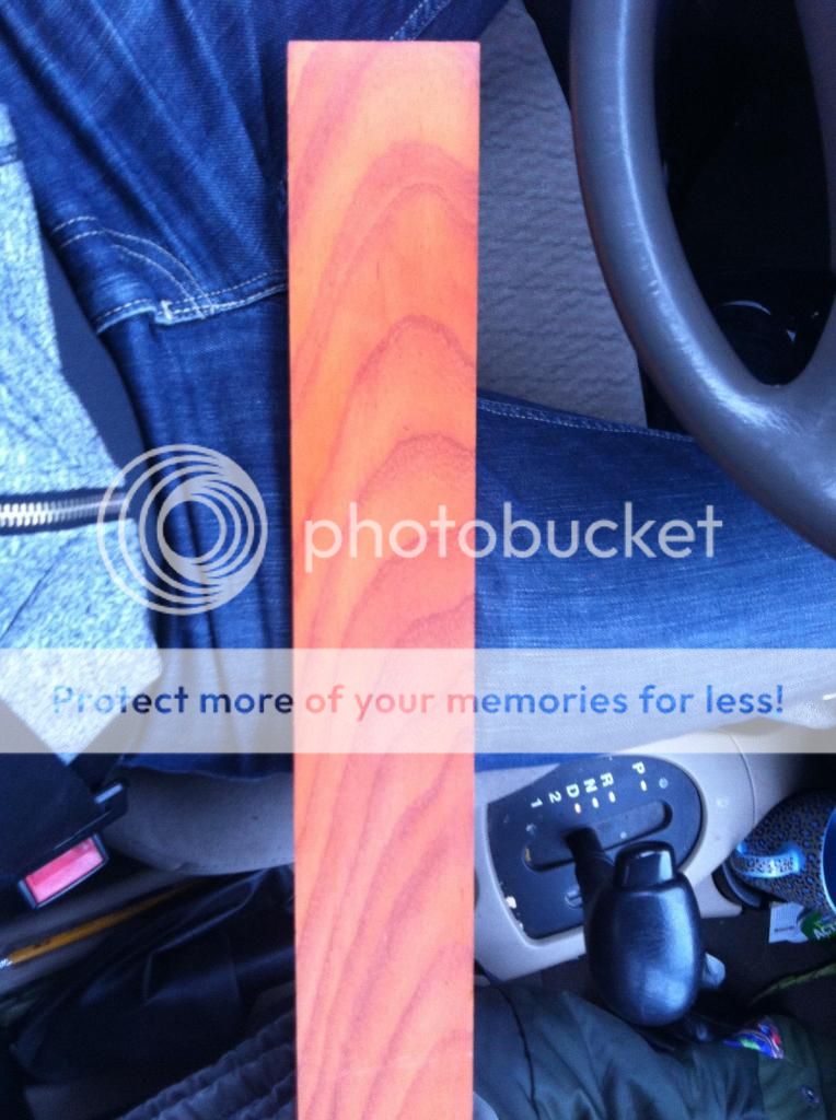

Here is the wood....

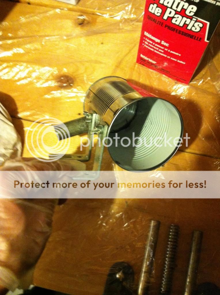

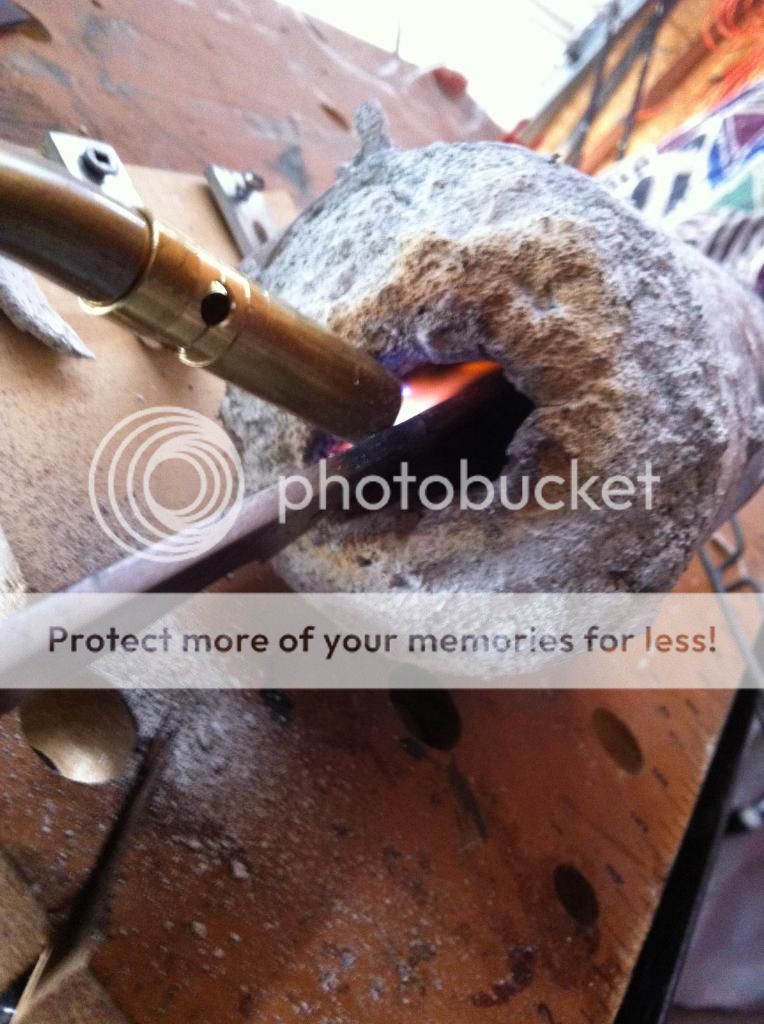

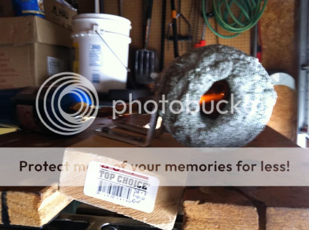

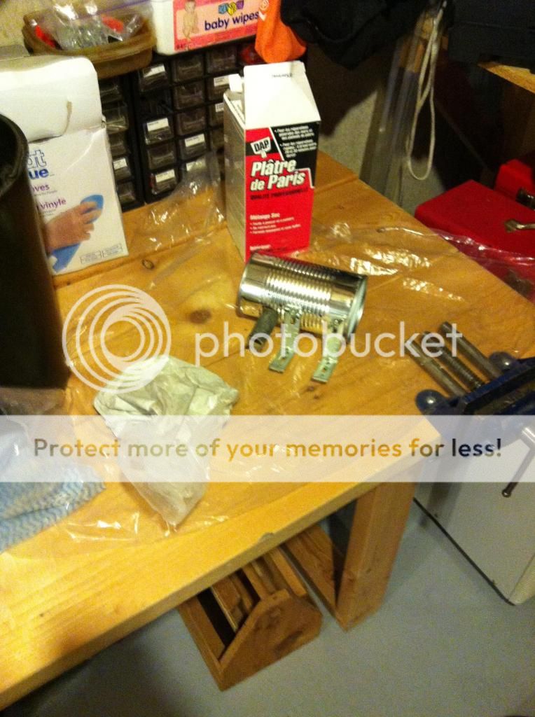

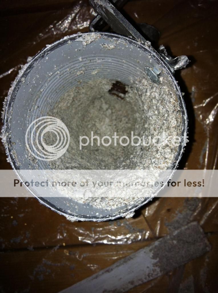

Making the soup can forge
Cut the scales

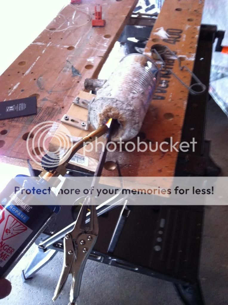

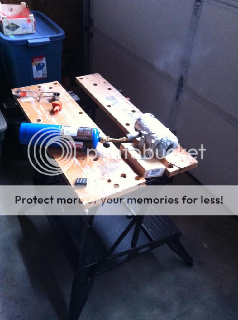

Heating up the soon to be a big failure soup can forge in the -8C temps of ontario
After 40 minutes of heating and still only this far...
Im confident that if it wasnt so F%%%%ng cold that it would have heated up. Its a shame.

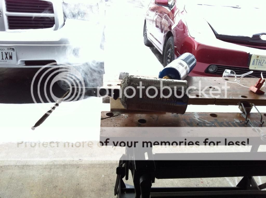

Due to the cold, tried to keep the door half way open sometimes but too damn cold. Probably killed some brain cells with all the CO2

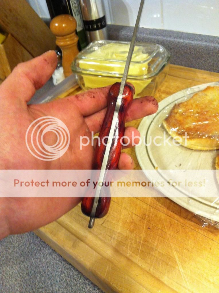

Gorilla glue expanded like crazy and got stuck everywhere... Oh well, no worries about it being waterproofed
Hands were like this for 3 dsays

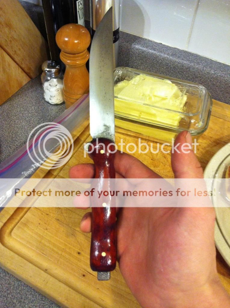

AT LAST!
Its over! i can get back to my life!
FINAL THOUGHTS
A very fun and rewarding project although definitely not the easiest. Although nothing is on a first attempt.
The one thing i regret was my crappy heat treat. The weather was just not on my side and cooling my forge as fast as my torch was heating it. Later my Dad and i tried it on the gas stove with the torch on it as well and got it to a dull red but by the time we went to dip it in the 140F corn oil and he had to turn off his torch etc. it had cooled. Although, it still left a trail in the corn oil. Not sure if that means anything.
In the end it had been quenched twice, both times it never hit the point of non-magnetic. Although my ideology is that... you quench it to harden it, then temper it to soften if back up. I had a self admitted crappy heat treat so i never tempered it to soften it back up. Figuring that this would leave it with a semi decent heat treat. Thoughts?
Thanks for the help !
Your heat treat probably didn't work at all... if anything it probably made the knife softer... of course I could be completely wrong, but I don't think I am. You have to get the steel up above non-magnetic and quench it immediately to get it to fully harden. Then you make it "softer" by tempering it, so it won't chip during use... read the stickies and they will impart the wisdom of ages upon you!
That said, good first attempt! Make more!
Very cool man! I agree the knife probably didn't harden but hey its all good fun and practice. I think your on the right track with everything. I built my first forge a few years ago using the coffee can forge plans. Its simple to build just like the one you have already finished(just a little larger). I'm not sure what you used for a refractory material but I would suggest using kaowool/ceramic blanket to line your forge. Its sold on Ebay and other places online and is fairly cheap. Also some refractory cement will keep that heat where you need it. You could also try using another propane tank simultaneously to ramp up the heat(With safety in mind obviously). I had one in the side that stayed in the forge and then I had another one I held with my hand and pointed into the forge. Not perfect but It definitely got the blade non magnetic and hardened well. Like what was mentioned earlier you can cut off a small piece of steel heat it to non magnetic then quench. That way you will know if that steel will be able to harden before you start on your next project. By no means am I a professional but this worked for me before I was able to drop big bucks on an Evenheat kiln. Best of luck man keep cranking them out!!!!
