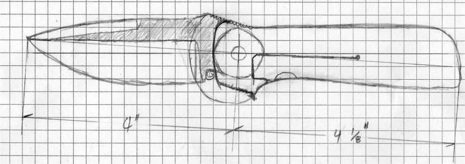

Here is my sketch.
And here is a video of my model showing everything but the liner locker.

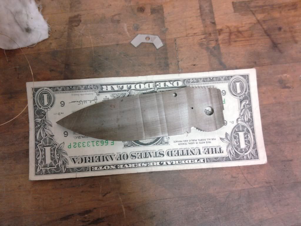

Not to offend but that is a very wide (knife) folder as I see it. Perhaps you have a very large hand? Maybe you might try taking 1/4" or so off of the wideth? The stlye looks okay but the wideth seems unusual. RESPECTFULLY Frank
I have been feeling like it is a bit big. Thanks for the tip. 1/4" off both the blade and handle?

Yes Carl the blade and the handle. This more easily done by taking some off the top and the bottom rather than just one. You will more likely maintain blade positioning in the frame. You can then perhaps do a wood handle only and rough to size to get what I call a "cheap" feel of it. Yes Carl that should have been .015 !!! I have made every mistake possible at least three or four times. I started on the folders long before I knew there were or if there were sites to get some help. I still reach out of course. and it is amazing where good answers will come from in that they can come at times from very inexperienced people . Frank
And here you go. You certainly could stay with a larger blade and get even more of that "tactical" look. Frank
It's all in the learning curve, Carl. My present day attitude would be to stop and start over, but I have an unfinished Green River style skinner in a cupboard that tells me I didn't way back when and I made a lot in that size. It still comes down to what YOU want to do. Frank

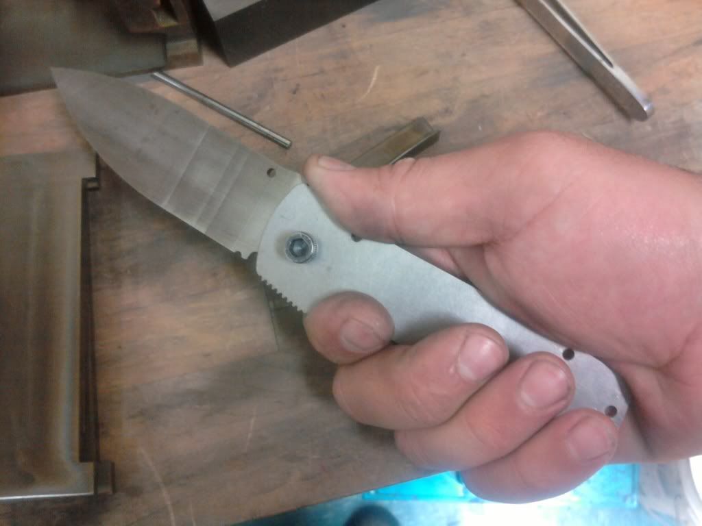

My Liners came out, so I put em together for a quick fit check. They seem okay, on the large side, but okay. I figure I am this far, (Blade is hard already) if it is too big when I am done, it can go in the fond memory box.
