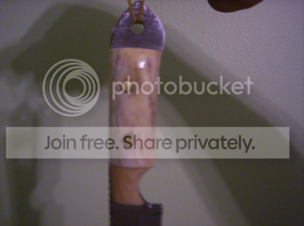

There are some design errors on it that you want to deal with on the next knife.
The first is a biggie:
The hole directly above the finger notch is a bad idea. It will make a weak spot on the part of the knife that needs the most strength .
The file work in the finger notch will probably be less comfortable than a smooth curve. The grooves ( in the notch) could also start a stress riser toward the hole and really weaken the blade, causing it to break under use.

My ME perspective: I agree that the serrations in the finger notch are a bad idea due to stress risers, but I don't see any problems with the hole since it's (practically) on the neutral line and therefore contributes nothing significant to the strength (when properly finished on the inside). If he decides to remove the serrations the hole will in essence move towards the edge and then it becomes significant.

From a ME point of view,
the blade = X width
the finger notch appears to be about .375X deep
the hole appears to be .125X
Thus the notch plus the hole = approx 1/2 the blade width. That will put twice the stress on the neck than at the plunge line in a side flex - resulting in a failure . Even if this area is covered with the handle scales, it may still fail there. To add to that, the distance between the notch and the hole is quite small, and the probability of a riser there is high.
In design, I use the rule of no holes within 1" or the ricasso if avoidable. If they must be there for things like bolster pins, then they should be as small as possible, and have chamfered edges.
Final comment is that this is a knife from a file, and if 1095 is very prone to cracks and micro cracks. Any avoidance of stress areas is to be encouraged.

I take the notch as a given. In that scenario the hole would decrease strength in side-flex by about 30% (visual estimate of hole width vs. local blade "height", linear dependency acc. I=1/12*BH^3). This may or may not lead to failure, depending on use. I agree it is best not to have the hole for optimal strength in side-flex.
Upon closer examination of the pictures I would agree that the hole is closer to the notch than to the spine, moving it away from the neutral line in a "height-flex" situation and decreasing the remaining material height (I would say that the radius of the notch, when properly finished, is probably large enough to be of minor significance). In order to maintain optimal strength with the given geometry I would say: remove the file work and finish the inside of the hole and the radius of the notch as smoothly as possible to avoid crack initiation. Chamfering or radiusing the transition between inside radius (both hole and notch) and the flats is a good idea to avoid stress risers.

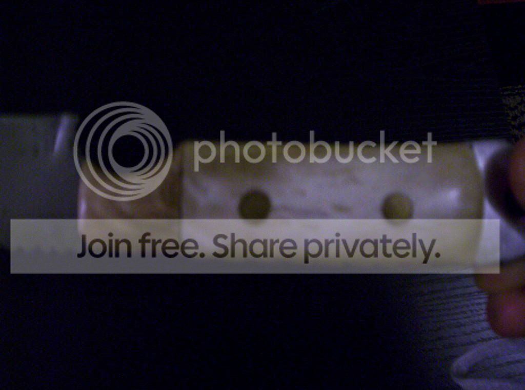

Okay, finally finished the knife handle. after alot of set backs i finished the blade, still needs a bit of cleaning but the knife is done and i think it looks good.
as for the "Problem hole"
the wood piece that i used came up short and putting a pin hole would have ruined it so i opted to just fill it with epoxy. my wife will probably never use the knife past any light carving (i gave it to her as a gift) so we should be alright.

two part handle, i chose an old piece of antler that i had. it had been in the sun for a long time and developed many cracks, but it still had some resilience to it (the pitty core had not gone to dust, actually it held up quite well)
Gluing the handle to the blade
Finished product (quality sucks due to the fact that my camera sucks)
handle up close with no flash, didn't turn out to good.
