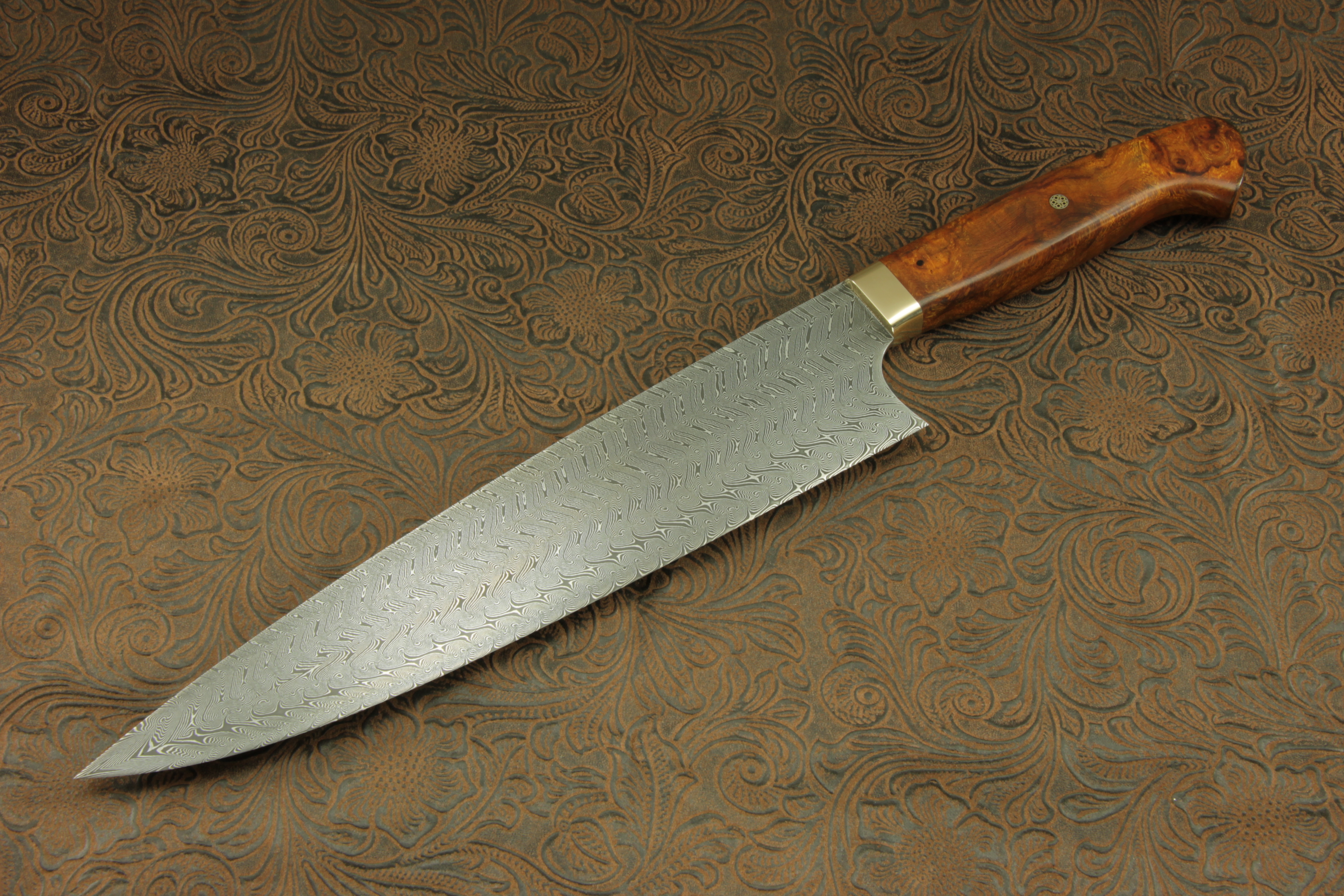

Hey Guys, I've always been a big fan of plungless ground kitchen knives, but I havent been able to find any good tutorials.
If I were to take a guess, I would think you just grind the bevel back towards the handle and blend it in with high grit belts and hand sanding, but what do I know?
Any advice on this?
Thanks a bunch

Butcher block has a good one that I'm sure someone will post a link to. I do mine similar. First I kill the edge on my belt so it doesn't establish a crisp plunge. I start from the tip with good pressure and then ease off as I approach the plunge. You want a sweeping plunge line. This will also incorporate some distal taper. Once I get close to 80 percent of the way up the blade I hang even more belt off and start to blend the plunge in. Then switch to an A65 gator and do the same. After this I switch to a contact wheel and hold the knife in the same direction as the belt. The tip is facing away from you. Now with the A65 start about halfway on the tang and ride it until you reach the plunge. Let the knife roll so that now you're on the bevel. Make full passes until you have blended the plunge. I hope this makes sense.

I start near the tip as in the last 1" or so and go to the plunge and back to the tip. This will make a sweeping plunge because their and middle will spend more time on the grinder than the plunge. I leave the tip a little thick and thin it out after I'm done with the 50 grit belt. I also don't hold the blade at a 45 like Butch but both ways work as you can see.

I will see if I can make a video at some point showing how I do it with a combo of Butch's method and a contact wheel. The other thing is when hand sanding use a soft backer to help with the blending.
Make a flat platten out of 2" square tubing. The edges are rounded and do not support the edges of the belt which creates a round transition instead of a cut in plunge line. Grind with your normal technique, just make sure your belt is centered so the two sides match up.
