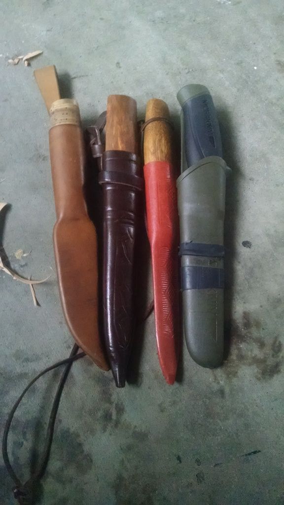

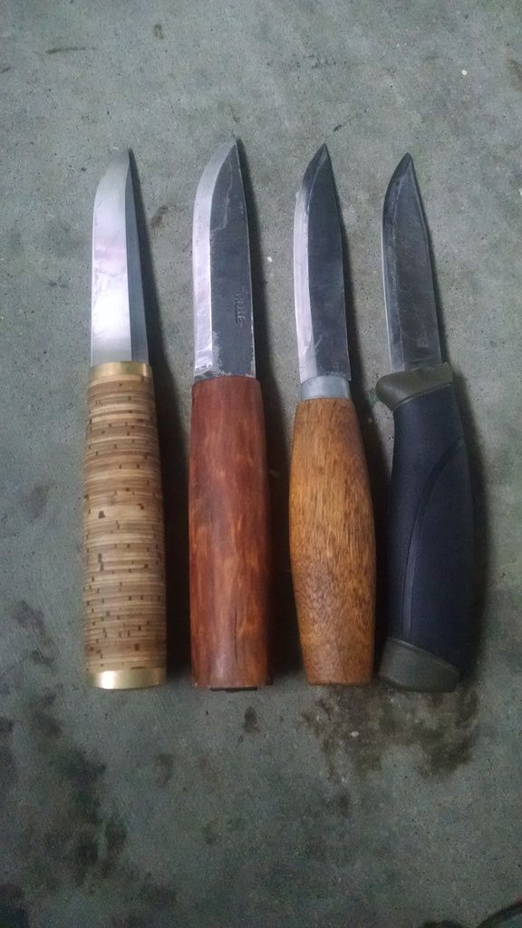

Scandi Knife Face off!
Left to right
Malanika Puuko$190,Helle Viking $100, Mora Laminated $50, Mora carbon companion $15.
Size comparison
Very comparible sizes
The Helle is the heaviest, the Mora laminated had the shortest handle. The companion is the lightest.

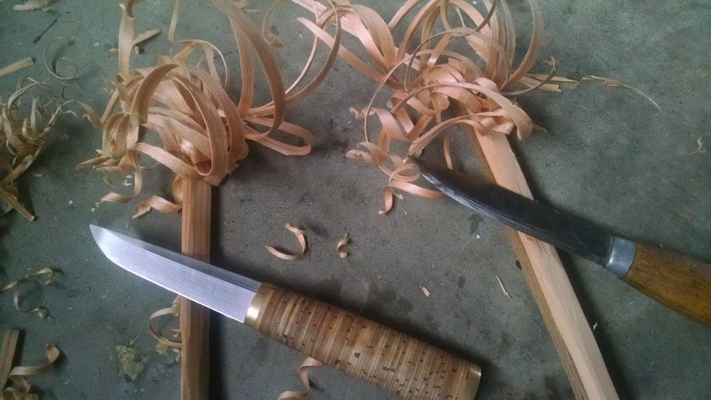

Using a notch cut with both thumbs on the spine.

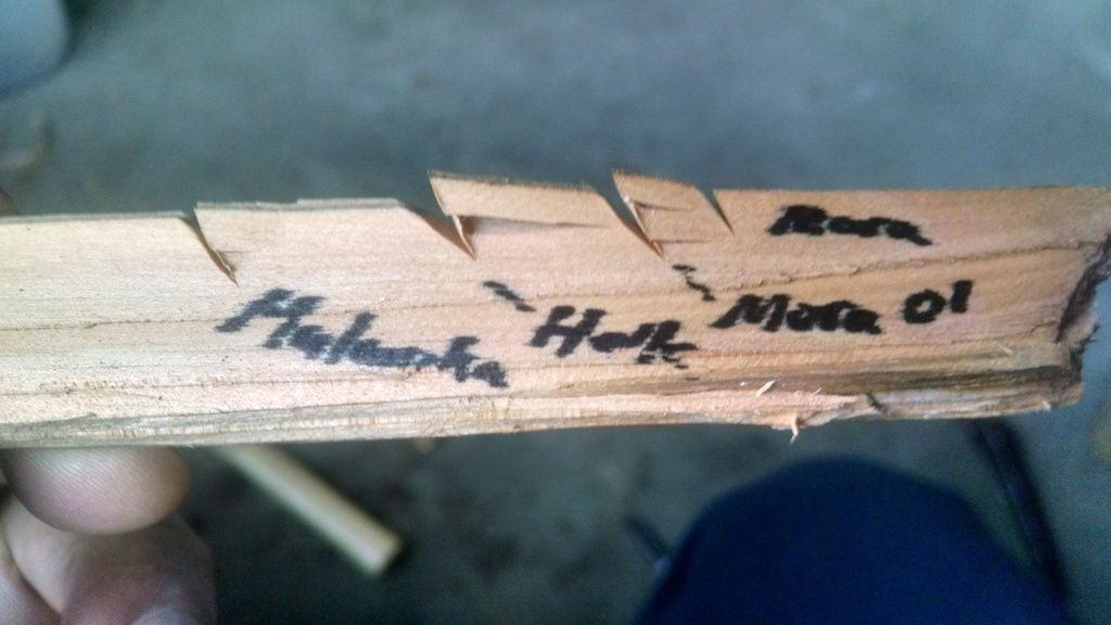

I pushed the knife into to wood until it would not move.

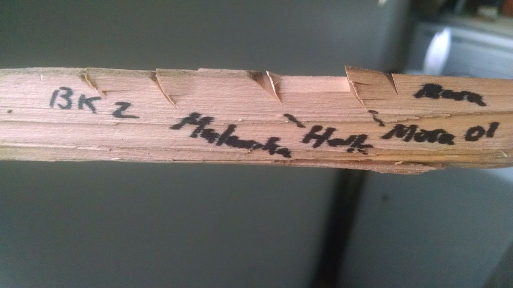

Here's another view, I added a bk2 for control
The Malanika Puuko got the most depth but do you see how the wood was moved and split by the Mora and the Helle?
These knives have better "bite" in the wood, they really sheer off the fibers with a mix of split and cutting.

Here's a graph I made.
Bite comparison
The Malanika takes more force to make bigger feathers but can make the same feathers
Depth control comparison

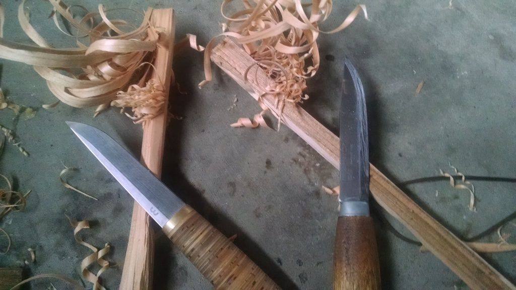

Yet, its takes less effort to make fine tinder feathers with the Malanika Puuko.
The Mora wants to dig too much and takes more concentration.

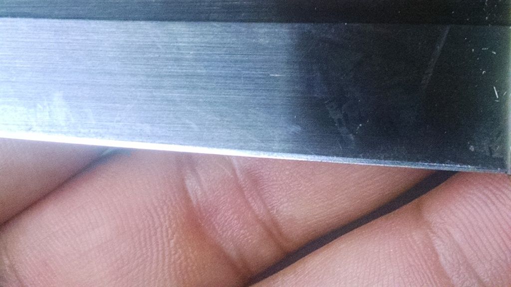

Edge stability
The Mora takes edge damage just from the carving the feathers you see! While it is still very Sharp and can keep cutting longer then a normal Mora, it does take more time to repair.
The Malanika Puuko has no edge damage.

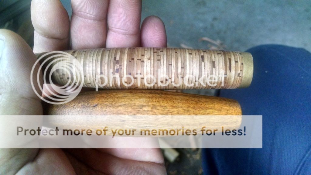

Handle profiles
The Malanika has the best shape for comfort
