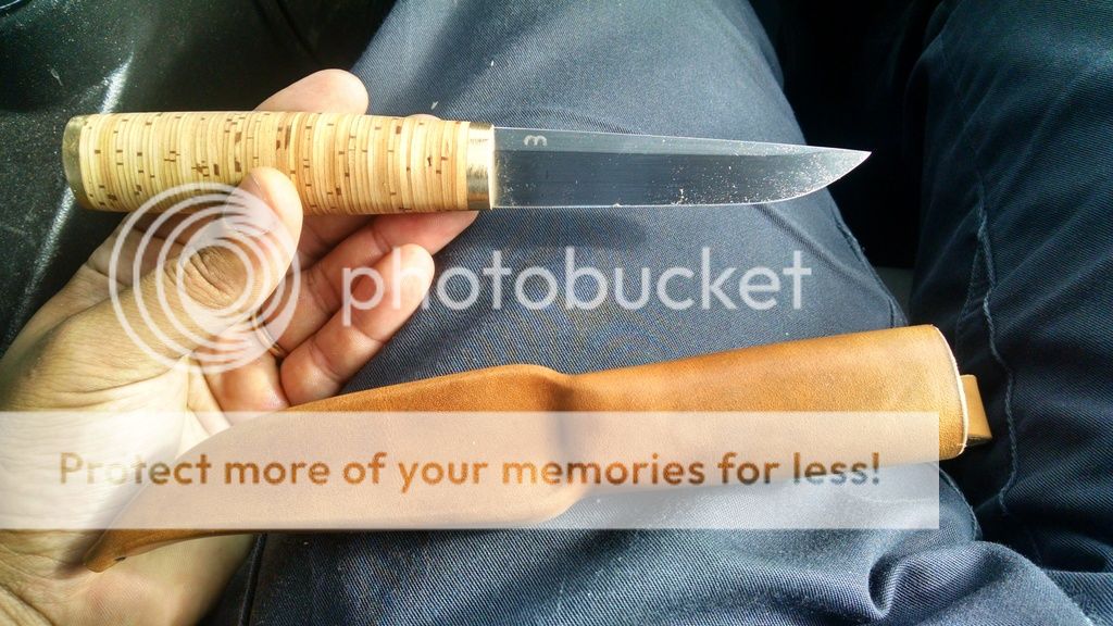

This might be the most beautiful knife I've ever owned.
Somewhere in Croatia some of the most breath taking puukos are being constructed with great materials and attention to detail.
Danjiel is sells his work here on bladeforums. His knives sell in mintues so I found him on Facebook and request my dream Puuko
A stacked Birch 90mm with rhomboid geometry. 2 monthes and $190 shipped.
The steel is 52100 stock removed with a double temper cycle.
Danjiel, Thank much friend,
This has been my sharpest knife out of the box.
I'll make a review later.
This guys work is amazing.

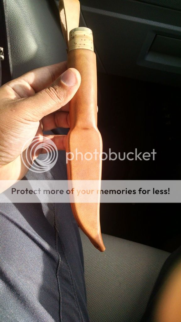

I have a constructive critique on this package. While the puukko seems flawless from the pics I can see that he still needs to put a little work into the sheath, especially in the mouth area. To make them better he needs either to fold the leather inside or do a small cut all along the mouth inside that will help wrapping even tighter the handle after wetforming.
Even Kallioniemi failed to craft flawless sheaths: he was particularly unhappy about the bulkyness of the stitchings.

Great post Fredrick
It's good to have an eye for details.

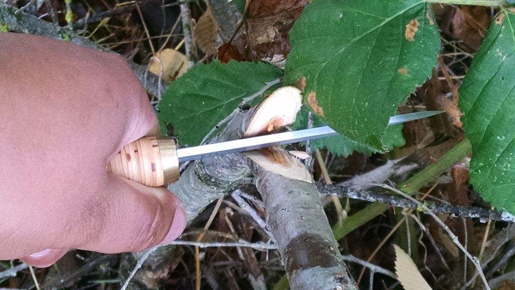

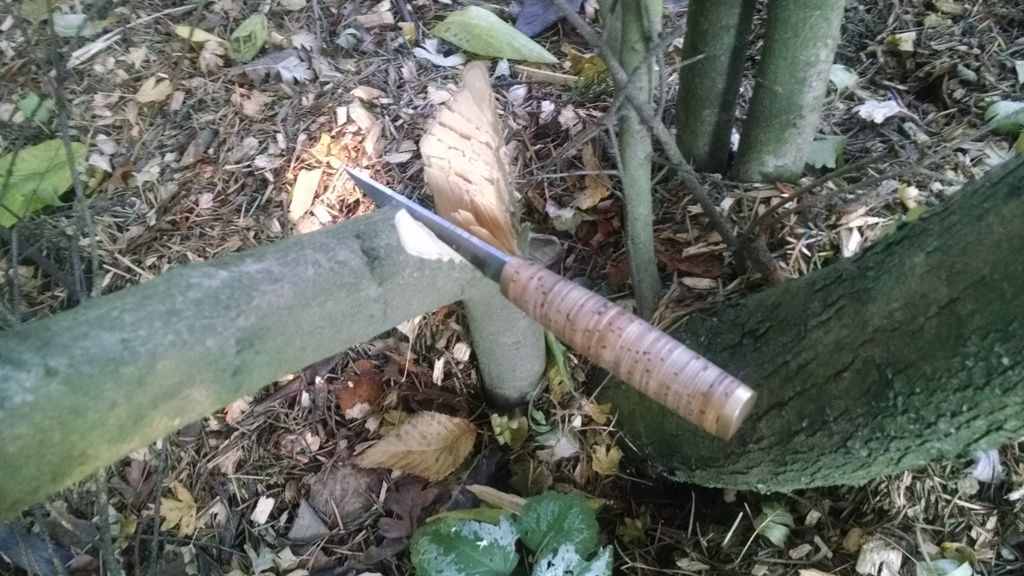

The performance on this blade would make Mors Kochanski blush
Cutting a wrist thick green Hawthorne shoot.
I flexed the tree and applied pressure with the razor sharp edge.
I didn't expect it to perform this good.

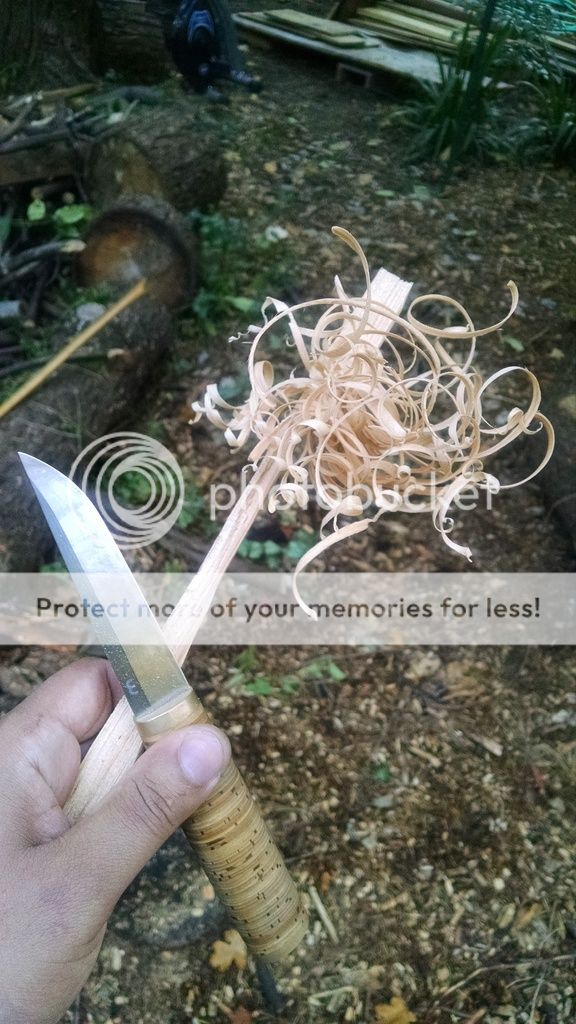

It carves beatiful feathers from this piece of dead pine.
I had a blast this weekend using it.
