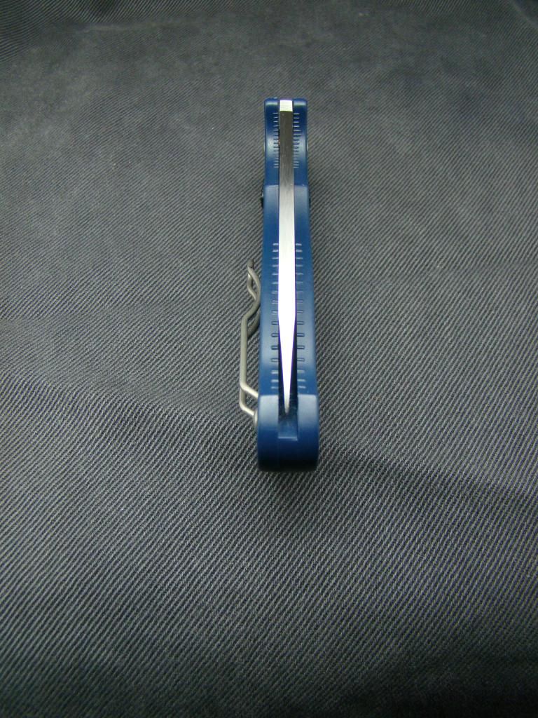

Finally, completed this handle rebuild this week,after ordering and receiving some 1/8" blade pivots with 2-56 screws and some shorter 0.170" 2-56 torx button head screws. Every hole in the handle that had a rivet was drilled out to to 1/8".The hardest areas to drill out, was the stainless steel back spacer and figure 8 shaped pivot support arms.After drilling it out,I got a piece of 1/4" 416 SS on to a lathe turned it down to approx 5.30MM and drill a hole through,with the help of a cutoff,some 416ss washer were made.

No.I don't have other pics of the process.Actually just started on my second one tonight,I can tell you that the rivet are hard to remove,regardless of whether you drill or mill them. Time and patience is key,as they the rivets tend to revolve because they are not extremely tightly riveted.Tried drilling the heads off and succeed in chipping my carbide drill,ultimately when back to milling at a slow pace.

An almost completed conversion,just have to cut the last barrel pivot that goes throught the back spacer/blade stop down to approx. 9MM
1/8" Barrel Pivots with one side screwed in
One half of the knife assembled
Left to Right:SS Rivet Removed,1/8" 303 Barrel Pivots with 2-56 torx screrws,another custom 316SS 1/8 pivot with custom 416SS washers,last pic - torx screws washers pivots cut to size ready for assembly

No,I have a total of three S110V Manix2 knives.The most recent one done was actually my very first ,the second was DLC coated S30V and third,the satin flat ground EDC forums S30V blade.I like them better now as I can clean them if I see the need.The blade lockup is tight with an extremely minute amount of wiggly,if really looking which is excellent but not the rock solid lockup of a BNIB S110V Manix 2.
