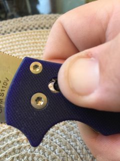

So I was cleaning my manix by just rubbing dawn all over the g10 scales blade and working it into the locking areas and then rinsing. Got all done and now it's like it's jammed. When I pull back on the lock it's so hard and then the ball bearing pops out of the plastic holder thing and stays in the locked position. I'm really not sure what to do here. Kinda upset that it's doing this also carried this for a couple months now and never had a problem. I keep looking at it and don't see anything stuck inside or anything. Please help. This is my favorite knife. But I guess worst case I get the new maxamet variant.

Well I just got it to pop loose held the bearing cage back and used a small metal rod to put leverage on the bearing and it popped free seems to be working fine but a little worried about it might still contact spyderco tomorrow and see what they think.

So the ball bearing pulled out of the plastic housing?
Correct. I have a semi picture of it here.
The half round thing in the front is the ball bearing was hard to get a picture trying to hold the spring back.

Yeah that shouldn't happen. I would definitely send it in to Spyderco detailing what it was doing and ask for a ball bearing/ ball bearing cage replacement. Either the ball bearing is a tad too small or the cage is slightly defective. My guess is the cage. I would definitely send it in. I've never seen or heard of that before.

Ball bearing should not come out of the polymer cage. Only if you disassemble it and put it upside down.
It happened to me. I know it's against warranty, but I was switching ball bearing to ceramic. Works even smoother now.
If you didn't do anything like me, you should better send it to Golden.
