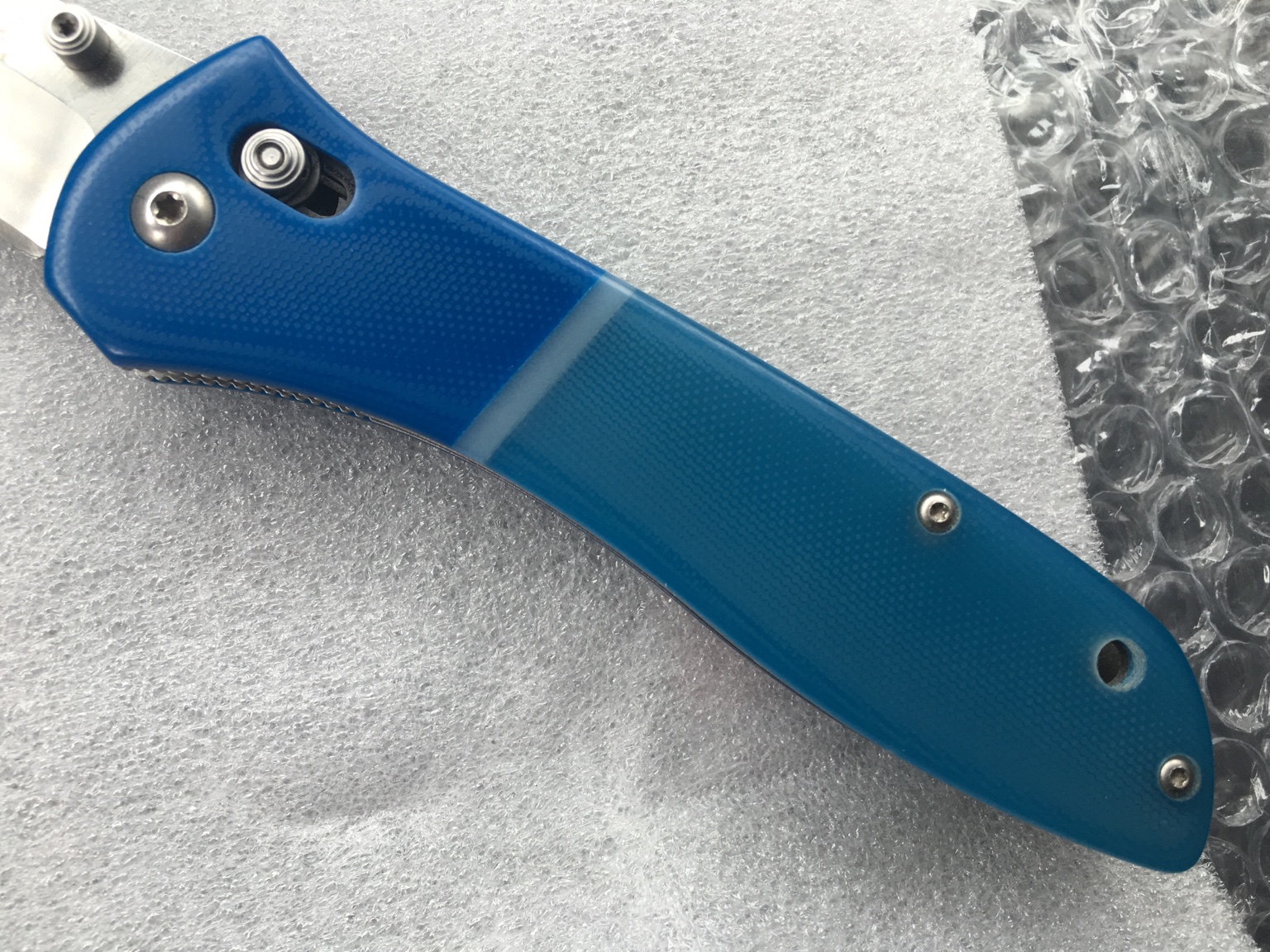

If you're looking for scales, check out Allen Putman. He has them in stock and you can install yourself.
Or check out Steve Ketchen here on the forum. He does hand made ones!
The middle one with the black blade are Putman's.
The 710-1401 was done by S Ketchen.
Thank you, I love your 710. I have a ton of knives from all different makers, but I seem to gravitate towards my small spyderco offerings the most. I really want to find a NIB D'Allara Drop Point though, that's the only one that's gotten away from me so far.
