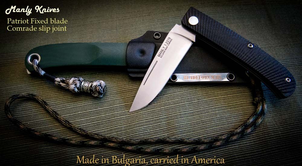

Yes Gary, no worries. It seems that this is not the right model for him. I on the other hand got interested in it! I never owned a slipjoint. While I was cutting boxes today, I asked myself if the comrade would hold up to it. What's your take on that? I know many lock nuts believe that using a slipjoint for such tasks is simply not safe.
I've been using both my Comrade and my Patriot for miscellaneous chores in the back yard. The blade steel, which has a composition equivalent to D2, is excellent. The blade geometry of each knife is also excellent. The full flat grinds are great.
Cutting cardboard? No worries. Cardboard is cut with the edge, not the point. Pushing against a surface with the edge forces the blade open. I've cut plenty of cardboard with a regular stockman or other slipjoint and have never felt my fingers to be at risk.
On the other hand, I have found piercing cuts with the Comrade to be quite possible. Though I am careful when I make them, I am less concerned than when using other slipjoints. I can exert much more force with the point of a Comrade than I can with a regular slipjoint before I reach the point of fearing that the knife will start closing.
This weekend was walking the small bit of property we have, picking up branches that have blown down, and using both the Comrade and Patriot on some whitting of these hard dead branches, both did great, of course the Patriot was a bit more forceful but then it is a fixed blade, but the Comrade also cut deeply and cleanly into the wood, both are great knives and glad to have both at my disposal for about any chore that comes up.

Hopefully BladeHQ will be carrying them in the near future, today I'm carrying both, nice knives!
Manly_Group.jpg~original

I just bumped this one to say how impressed with it I am in-the-flesh. I ordered from one whom I THINK is a sponsoring dealer here, along with a few other toys. The black and gray was the only 'subdued' color left on-hand, and I have to say I am not disappointed. The sculpted pattern of the G10 makes for a very reassuring grip, and the visual pattern is just enough to be different.
The descriptions posted here are pretty well spot-on, in how firmly one must grip the blade, and then walk it through the intermediate stops. With the effort of that spring, I was not prepared for how gently and quietly it closes. Although specs clearly indicate it's probably considered 'large' for a pocket knife, it seems smaller in-hand than the numbers would indicate. Perhaps because the blade is not ridiculously wide for its length, nor the scales at all bulbous.
I would encourage anyone who's been hesitant about this one to buy-n-try. I've already seen them go quickly I the Ads forum, so there's little risk here if it's not your thing.
