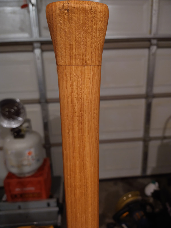

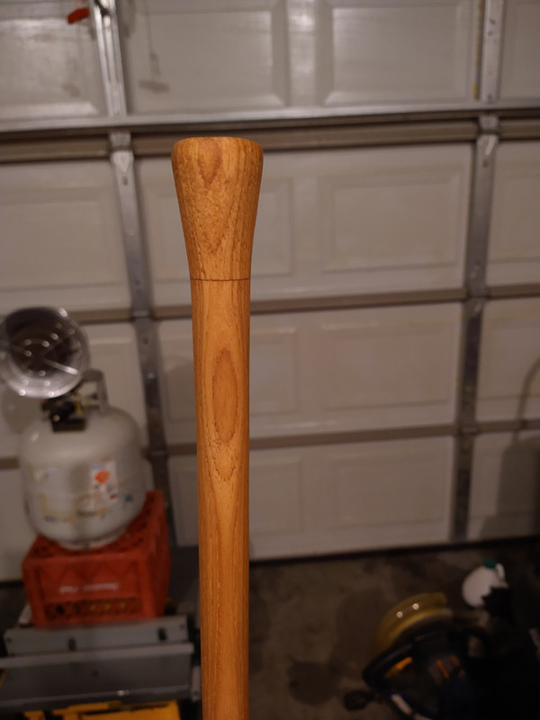

I've shortened a couple handles without losing the flair. You can just cut a segment out of the handle and then pin the flared piece back on. I thought I had a pic of it but can't find it. I cut a 36" handle down to about 26-27". Glued and pinned it back together and am confident that it will never come apart. Shouldn't be much stress on the last couple inches of the handle.

I like that Idea FLINT77. Sounds like that would make for a fun project if I ever felt like doing such a thing for some reason.

This is a 3.5 lb head on a 26" handle. That is about as short as I like to go. Not due to any perceived danger, but less than about 25/26" it becomes too short to use effectively - too short to get a full proper swing going. My preferred axe handle lengths are generally 28-32" with about 30" being my sweet spot.
Also in the pics above you can see how I shortened the handle from 36" to 26". You have to get the cut pretty straight if you want it to go back together well. I drilled out the center of each side of the cut and glued a fluted dowel in there then glued each end and tapped it together. let it dry, then sanded, etc. I'm sure it will never have a problem. Unless I use it as a pry bar or something.
