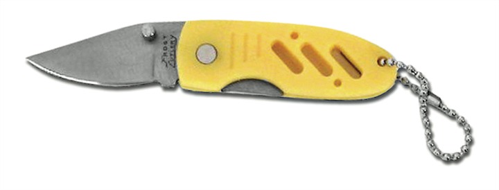

THAT IS with the exception of this knife that started it all for me. It was $3 shipped, a Frost Cutlery keychain knife. I innocently needed a knife one day. I had stopped carrying a knife about 7 years because prior to that all of my keychain classic Vic's covers would pop off and go missing.
For the life of me I couldn't get the steel to sharpen. Then I found bladeforum, a few CRKT and very cheap Kershaw later, then 50 of the mixed CRKT, Benchmade, Spyderco, Kershaw etc... later and I was hooked. Lol. I spent a summer buying sub $100 budget knives off of Nutnfancy's list, my wife was getting mad and calling me crazy. Then what's crazier - 18 months later she bought me a Starbenza for Christmas.
