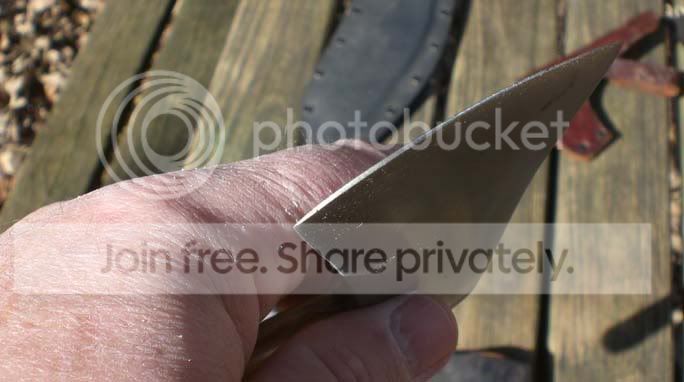

After belt sandering and stopping it with 500 grit wet dry it took on a really sharp edge.
As you can see the head taper is real similar to a GB Mini
After I reprofiled it it chopped really well and handled really well.

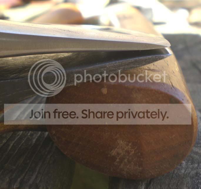

Unfortunately the head was loose and began coming off:confused:
Spent most of the afternoon bringing it up to shaving sharp. Don't know if I'll put a larger wedge in the handle or just epoxy it in.

A vaughn.(notice the head is cockeyed on the vaughn)
I really like the vaughn, I want one.
Apparently the marbles eyes aren't tapered so a wedge won't do too much, but you can pin the handle on, or maybe do some dremel work on the eye.
HD, whats the metal in the handle for??
HOLLOWDWELLER - "I'll put a larger wedge in the handle or just epoxy it in."
H.D., I suggest using both. You'll not have any trouble with it after that.
