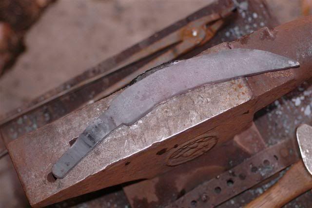

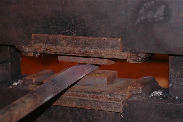

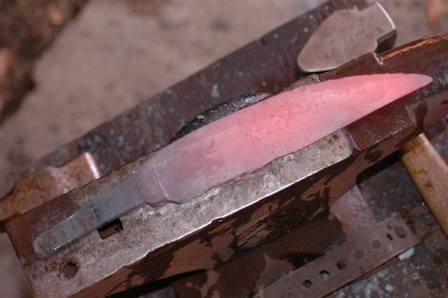

Here are some progression shots of the W2 bowie blade. It's going to be 9 3/4" long.

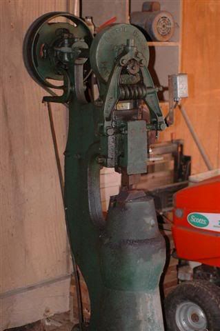

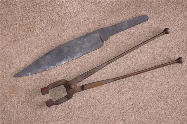

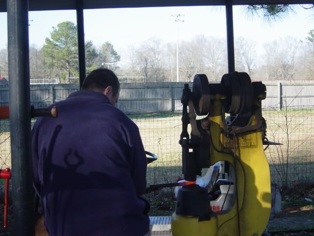

One inch round bar of W2 rendered down to 3/8" thick and 1 1/2" wide using both my press and 25# Little Giant.

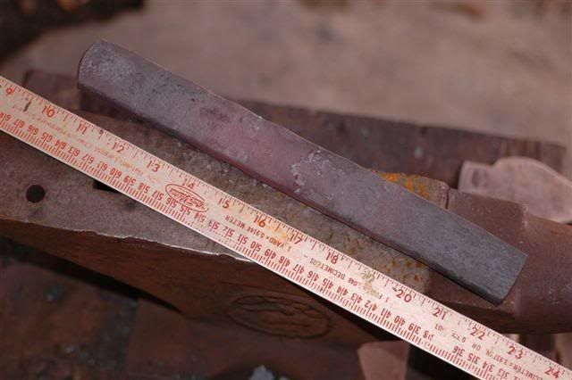

I cut off a few inches to about 8" long and forged out a short tang for my box jaw tongs.
Knocked the clip down and pre-bent the blade downwards.

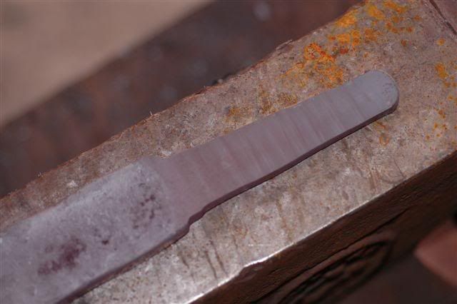

Starting at the choil, I began working the edge bevels towards the point. As I did, the blade widened and began to sraighten. Minor adjustments along the way and things began to take shape.
Went back and finished forging the tang and tweaked the whole thing straight

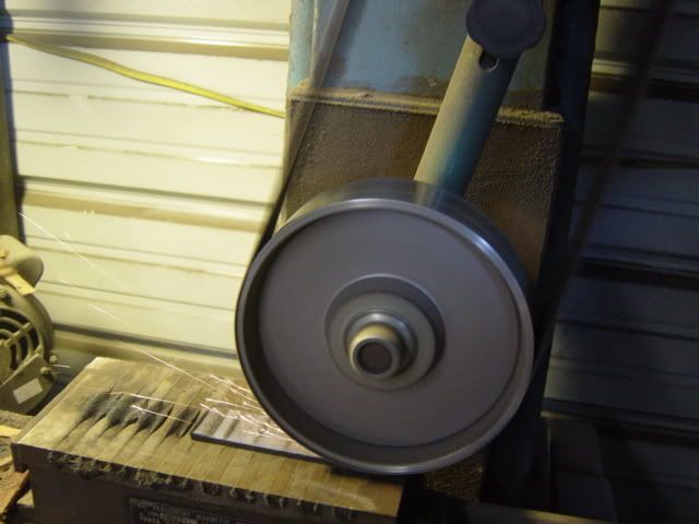

then headed to the grinder.
I always rough grind immediately after forging so that I only have to go through one set of normalizing cycles insted of two(one after forging, the other after grinding).

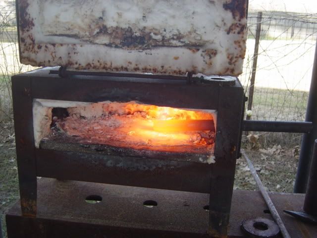

I'll put it in the oven for three normalizing heats let it cool slowly and probably heat treat tomorrow

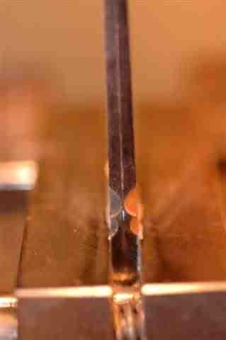

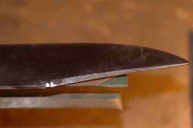

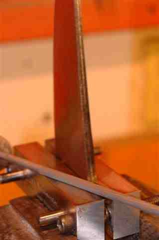

Using a file guide and a round file I put the notches at the top of the clip.One willl be incorprated into the actual clip while the smaller one is a decorative notch that I put on most of my bowies. Kind of a personal touch.
Then I filed the plunge cuts to equal depths on each side.
Back to work on the clip usin a draw filing technique. Also shored up the bottom of the ricasso where it meets the choil.

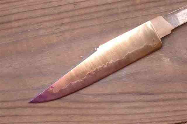

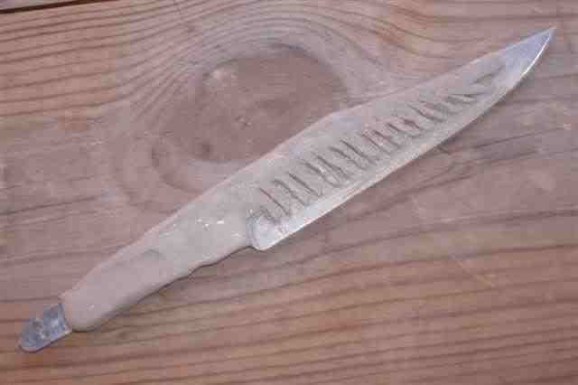

Clay is applied(the photo shows the first application. I did'nt like it so I washed it off and started over a little higher from the edge.)and the blade was hardened.
The last photo shows the blade after tempering and the hamon is clearly visible. The next series of shots will feature hand finishing and then it's off to Craig Camerer.

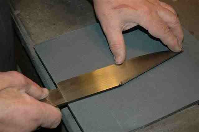

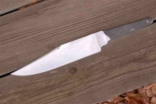

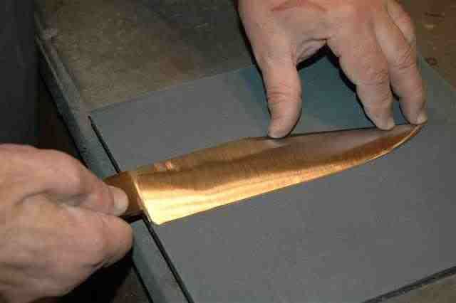

Shown here is hand sanding on a flat plate. First side to side,then longitudinally. I do my handsanding differently from most makers and I feel that it does a better job(for me) at removing dips and irregularities made by the grinder.The bevels on the clip are done entirely by drawfiling.

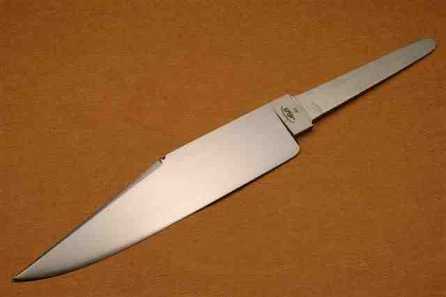

The blade is finished at this end and goes out to Craig tomorrow.I've included a shot of the finished blade taken to 600 grit.After Craig has completed the guard, he will etch the blade to bring out the hamon.

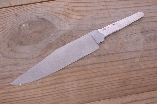

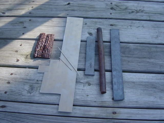

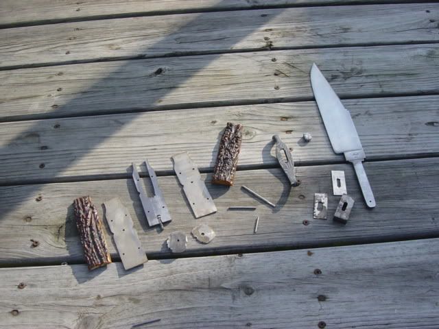

I got the blade and guard in last week from Craig.He has'nt had time to post his pics yet, so here is what I have so far. The first shot is the materials I will use for the handle.Nickle silver sheet and pin stock, wrought iron, damascus for the butt cap and frame, and some choice amber stag scales.

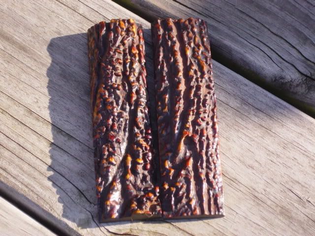

a close up of the stag. Is this stuff nice or what!

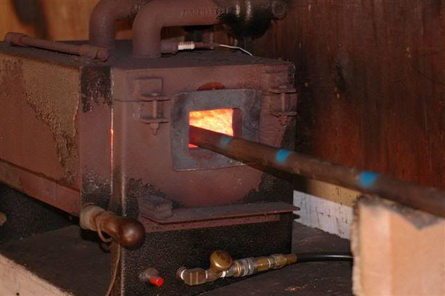

some 3/4 round wrought iron in the fire for the spacer

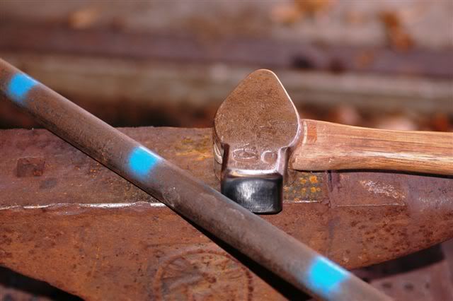

Here the wrought iron is being foged down to square
Here you see 1/4" wrought iron flat bar being surfaced for the frame(the damascus did'nt work out)
Here are all the parts made and ready for carving and fit and finish.
Tomorrow I will take it to my friend Don Hall's shop and let him work his magic on fileworking the liners. I will finish up tomorrow afternoon, then it will be off to Paul Long
