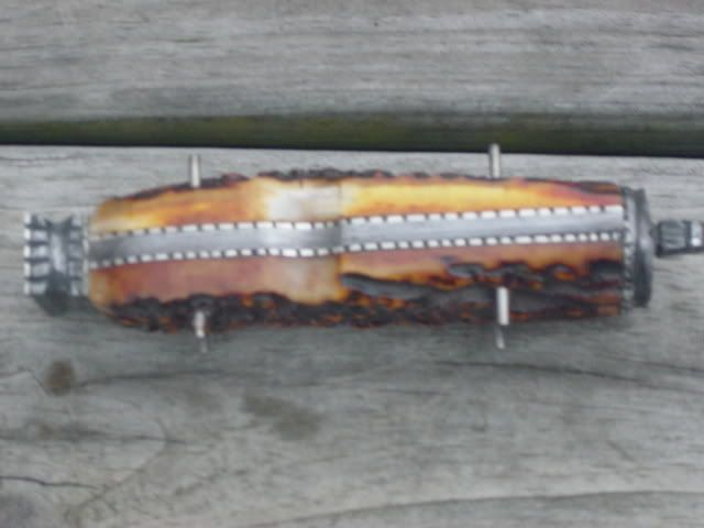

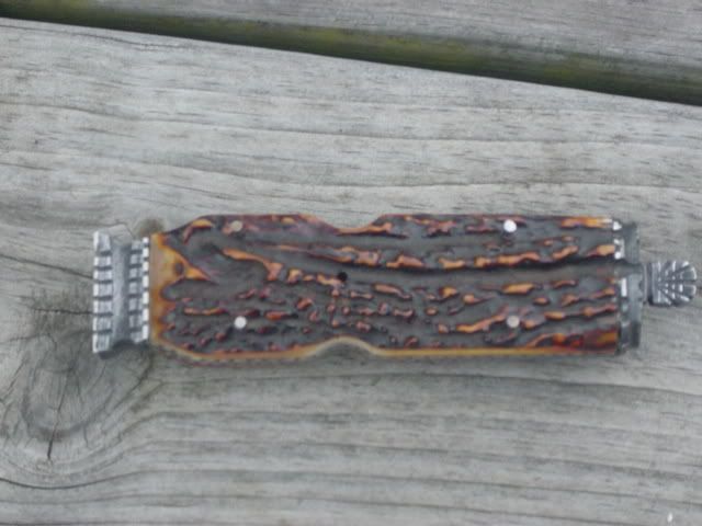

Thanks everyone, and thank you Craig for coming on board with this project. After almost a week of stressing, and cussing:D I am finally finished with my handle. It has a wrought iron frame and spacer, with the wrought iron coming from a grain terminal that was built in Wisconson in the 1800's that is being torn down for reclaimed timbers. The spacer, frame and butt cap are lined with nickle silver with coined edges.The butt cap is carved and fluted random damascus I had on hand, and the finial nut is made from some of Craig's damascus that I carved into a shell.The scales are amber stag from Culpepper.There is a total of 19 parts in this handle.I am not going to post a shot of all the elements together until I get the glamor shot in from Coop. It goes to Terry next final blade finish and assembly.He is also going to peen the pins in the handle and spin them for me.Paul Long will be up after that. Anyone going to the Arkansas show in Feb. can see the completed piece there on either Terry's or Craigs table. They will both have donation tickets for purchase also.

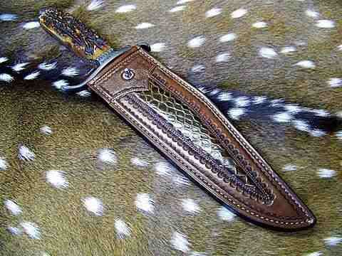

Here's a teaser pic of Paul Long's contribution ot this project.I tell ya, his work never ceases to amaze me!I could'nt get one of the shots to upload , but the sheath does also have Paul's trademark bowtie retention strap.
