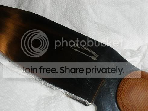

Last night I marked the knife I did as a WIP on here. I think it turned out alright although I would've liked to see it be a bit darker. It may have had to do with the fact that when I switched my machine to "mark" I forgot to go passed the center off position :o. However even after about 3 passed after finally switching it to "on" is still wasn't as dark as I would've liked. It is however imprinted into the steel you can feel it so I doubt it's going anywhere.
Also is it common for the stencil to look like hell after you've used it? I did a test run with a stencil and then went and marked my knife. The lettering on the stencil looks nowhere near as crisp as it should. The back of it has almost like a white halo all around where I put the pad and some of the letters look like they've bled together. :confused:
Again I have a fairly crappy camera still so this was about the best I could get as far as a shot goes. It actually looks considerably clearer in person but I had to take it on a bit of an angle so the flash didn't reflect off the blade. It should hopefully (finally) get a sheath in the coming days.
Using DC will typically etch into the metal but not give you much darkness, going to AC will then darken. I get a few marks 3-4 from a stencil and it still looks pretty good although I toss it, you may have built up too much heat. Etch for 10 seconds or less and then let up and allow a second or two for gasses to excape and for it to cool a bit. Looks pretty good overall. You may want to take a piece of scrap and practice a few time to get a proceedure, I have one written on my etcher that I follow every time/
I went a few passes at AC but still not as dark as I'd expect. I used the Q-tip method and just dabbed the stencil overlapping each one as I went. The amount of time I held it there each time I touched the stencil was the equivalent of throwing a jab in boxing. As soon as I hit, I pulled the Q-tip off. My etcher is still wired for 24V, a member who helped me wire it said he runs his like that no problem. So I gave it a dry run on a piece and the etch came out alright so naturally I had to jump right to a knife :D
Maybe I'll try a pass wired up at 12V and see how that goes too.
Technique sounds good, qtip takes a little longer, I touch the qtip and let it set a second or two and then dab the next spot. Make sure its not too wet and then a little more time will darken w/o getting fuzzy. Carbon steels will darken quicker than stainless so the steel matters as well.
I tape my stencil on all four edges and I can carefully pull up one corner a bit and see if its dark enough and lay back down if needed.
