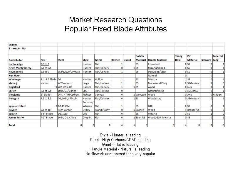

Here is where we are so far...
If answers were unclear or off topic I did the best that I could.
Please keep it coming. This is becoming very interesting. :confused::eek::D
Hey, I resemble that remark. :D
I find it a little odd that the majority gravitated towards a hunter when (I thought?) the only parameters were: custom, affordable, fixed.
I also notice that the majority specified a tapered tang, which necessarily implies a full tang knife. To be brutally honest I'm not overly fond of full tang knives, but that's just me.
I'm partial to hidden tangs myself, and for a knife in the $200- $300 range I'd probably want that feature as well.
I don't find it odd but more expected as one can get more of the "bells & whistles" (perhaps a more premium handle material for example) in a smaller knife than a larger at $300 or less.
IMO, if we gravitated more towards the $750-$1000 range there would be more preference towards bowies/fighters, other methods of handle construction and perhaps even damascus blades and/or fittings.
