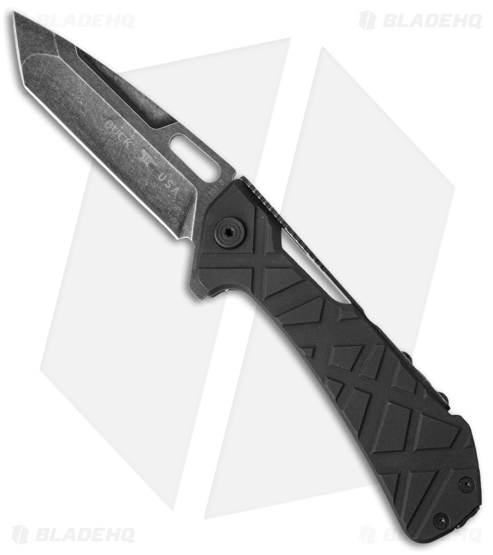

Okay, lets take a look at the product shot on BladeHQ's site.
Look at the curve where the hollow grind meets the tanto point. That's how it is on one side of my knife. On the other, that same curve perfectly meets the corner because the shaping grind is around a quarter inch further back. All of which makes tip off center.
Any questions?
Any questions?
I see a picture of one side. Not two sides.
