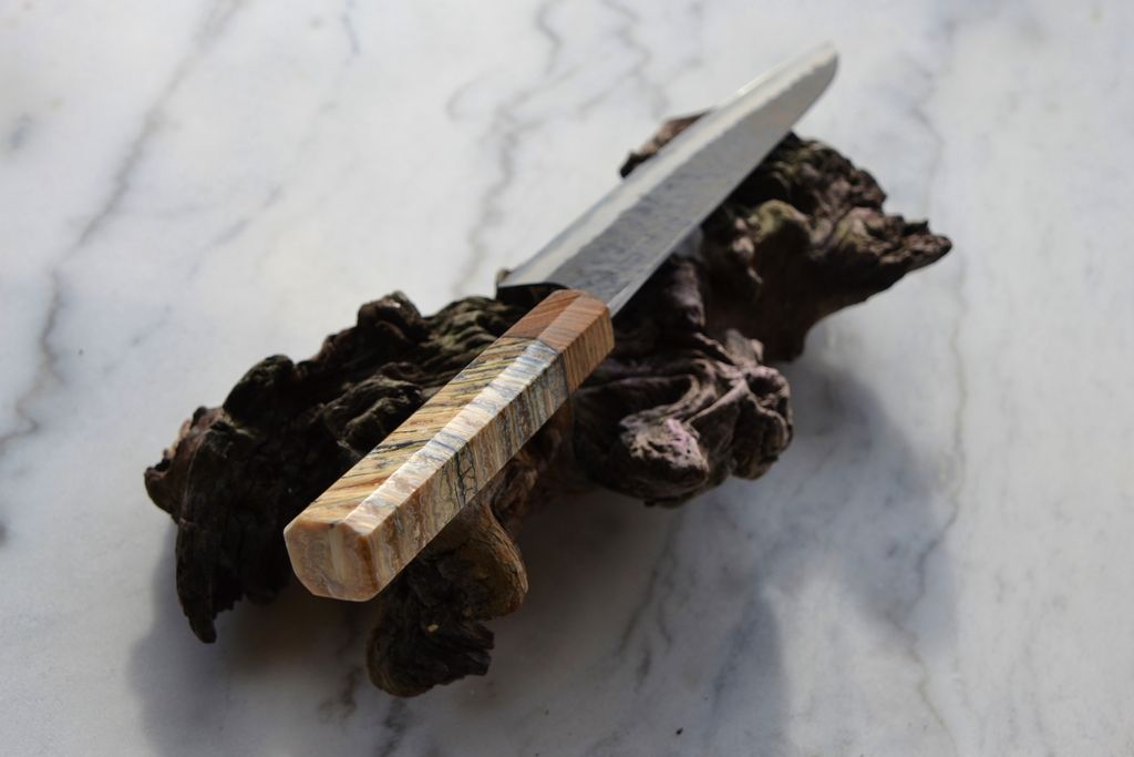

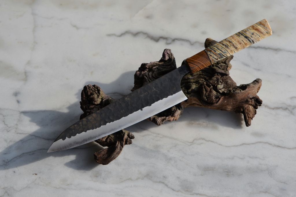

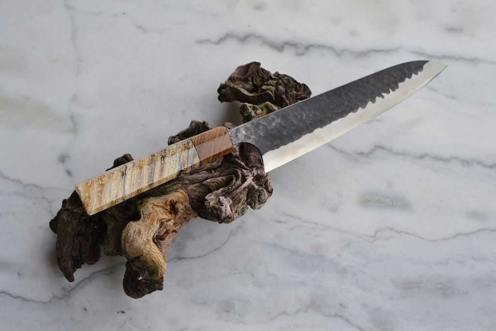

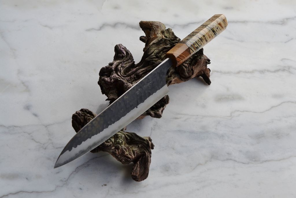

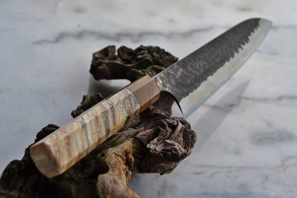

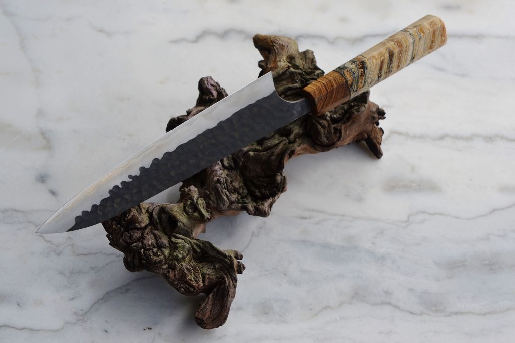

Hi everyone,
It's been a while since I posted here, time to change that :) I'd like to show you this Masakage knife I rehandled with mammoth molar and bog oak. It was quite a challenge!
Please let me know what you think, I'm most interested in your opinions!

Yes it is, I heated it up a little in hot water to soften the waxy substance inside the handle and with a few light taps it came off. Unlike several other handles I did that I had to destroy with a chisel. And I REALLY like the blade!

Surprisingly, it is somewhere in the middle (just in front of the bolster). The original handle weighted next to nothing so the balance was near the tip then, the mammoth isn't as heavy as I expected.

Quite nice. How do you make the recess in the handle material for the blade tang, and how is it fixed in place? I have a masakage knife I would love to rehandle someday.

The material is simply drilled and filed to shape, being particularly careful on the bolster fit, and then fixed with epoxy adhesive (I fill up the whole thing). I glued it together before shaping but if the mammoth wasn't such a tough material to work with I'd have the handle pretty much ready before fitting.
