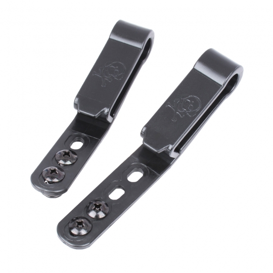

Hey Eric, I put a Mummert clip on a couple of your sheath. They work very well for IWB carry. I also like the 1.5” DCC clips Bud has been using. They can be used for OWB, IWB, and ISP.
Mummert also makes reverse, and slotted Ti clips that can be used with 1” hole spacing so it could be mounted higher up on the opposite side of your pancake sheath.

I posted this in the DEK1 thread, but I think it’s more appropriate for this thread. I recently placed a Mod W - HLR Discreet Carry 1.75” belt clip on my Mashed Cat sheath. This is the same one that Chad offered as an option with his Boot Dagger sheath. It carries lower than the Mummert clip because it can be mounted on the forward side of the DEK1 sheath with the 1” spacing. You don’t have to remove your belt, and it can be used for IWB, under the belt, OWB, and ISP.
DCC Clip
Mummert Clip
