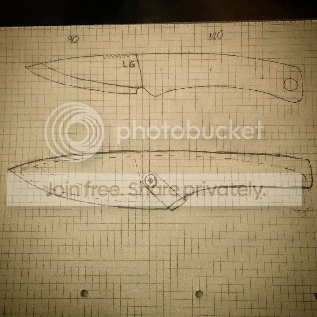

Got a knife design sketched up that I like and think will work nicely for me as a work knife.
But the question is, what kind of scales should I choose for this?
I will be using the knife in all types of weather, sun, rain, slush, snow, everything. And need something thats grippy even when my hans are wet or when I use gloves.
Don't want to be doing maintenance on it all the time either, other than sharpening of course.
My first thought is micarta.
For the sheath I thinking Kydex.
Seems durable ans easy to keep clean.
I'll take any advice I can get regarding all of this :)

That looks like a good handy design.

I want to suggest you look ay a case that the knife is farther into. I believe a case such as the one drawn will see the knife flopping around as you move.
With respect.
Frank
With respect.
Frank
Yeah, I should have written in the first post to ignore the sheath drawing.
That shouldn't even be in the photo. I was just doddeling :p
Sheath will be a bit different, and probably made from Kydex.
The knife will most likely worn on my thigh a little above knee height as the work pants we have are made kinda like that.
